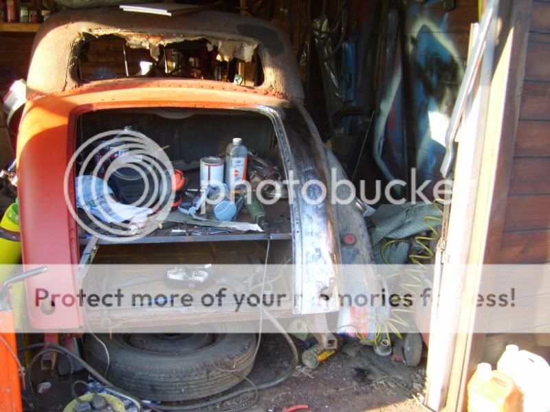

And back to "Rusty" Riley.....

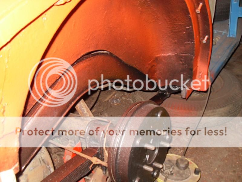

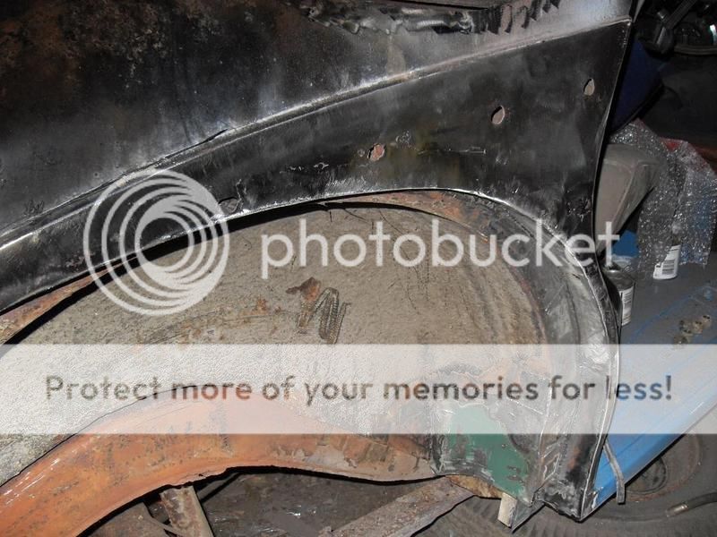

New captive nuts put in place where I'd repaired the arch and another coat of paint.
A small localised repair was then carried out to finish this area

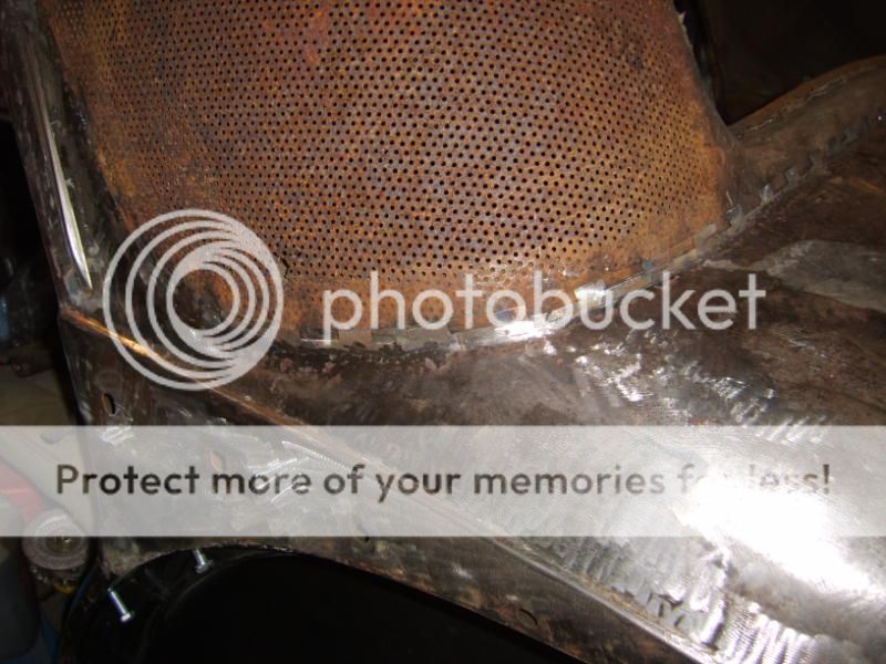

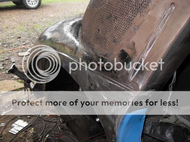

Then it was time to move to the edge of the body where it meets the roof and I made and fitted the new metal across most of the car
New metal in place and on with making the new boot aperture edges

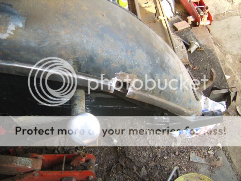

Then we had a week of wind and rain coming at the garage so everytime I opened the door the bits I'd been doing got wet and flash rusted, so as the sunshine came back I decided to clean up the metal and get a little protection on.
Sanded free of rust and nasty old paint
Coated with rust converter to catch any stray oxidisation in little pits
And some red oxide

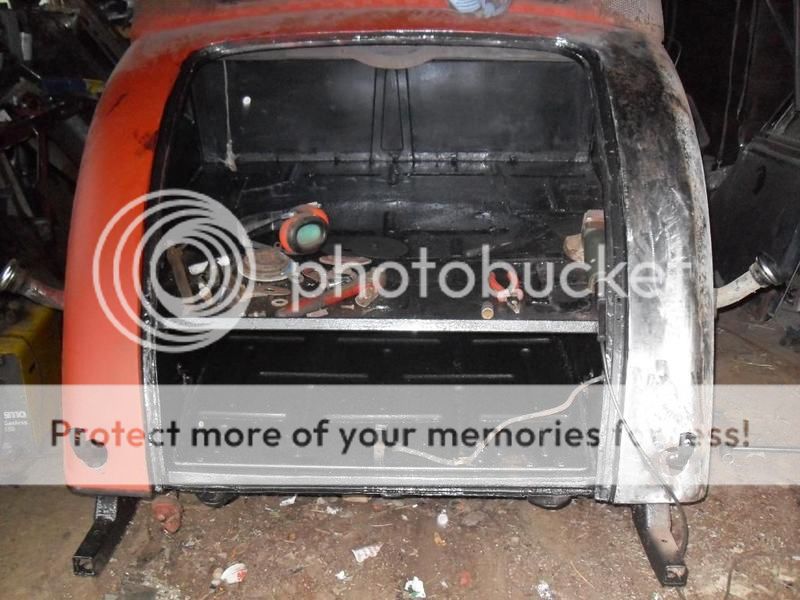

So, that protected I finished off around the boot opening
Then a new bottom edge welded in to complete
Thats now been cleaned up so the next job will be to repair what currently passes for a boot floor, I'll probably then sort out the edges of the perforated roof where I can get at them before moving the car over to gain access to the drivers side tinwork for more of the same.
And some red oxide

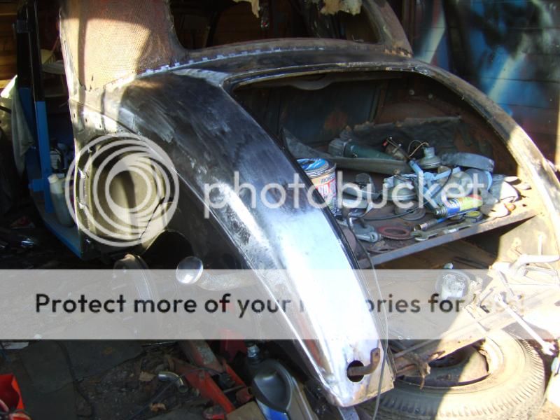

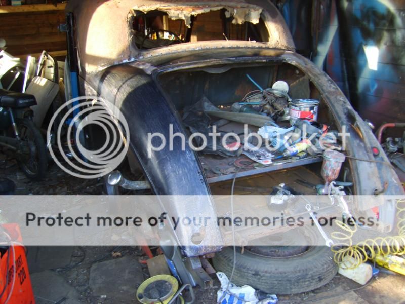

Anyway, I couldn't believe yet another month has slipped by since my last update but there has been progress.
The boot floor is now solid having been chopped up quite considerably and numerous repair patches butt welded in. A bit of a faff but I didn't want to renew it all. Its done now, cleaned up and under a nice coat of hammerite.

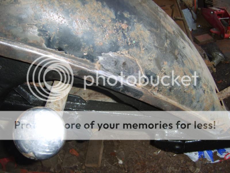

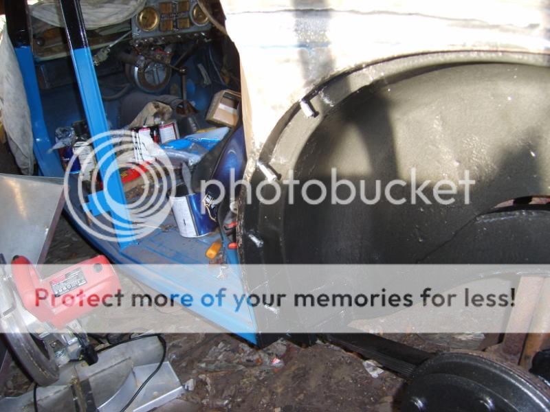

So it was on to the inner arch sections of the drivers side rear, This had taken a lot of water over the years and little remained of arch to wing lip other than laminated rust, and numerous holes were present under the rust of the side pieces, thankfully although under a thick layer of rust the chassis remains absolutely solid.
So nothing for it but to replace the entire arch to wing lip and weld in more patches. There was also a lot of frilly steel where the side strip mounts so this area was also cut away and patched in.
It is a little tricky to photograph this area due to restricted space but after lots of welding and serious cleaning up it is solid again,

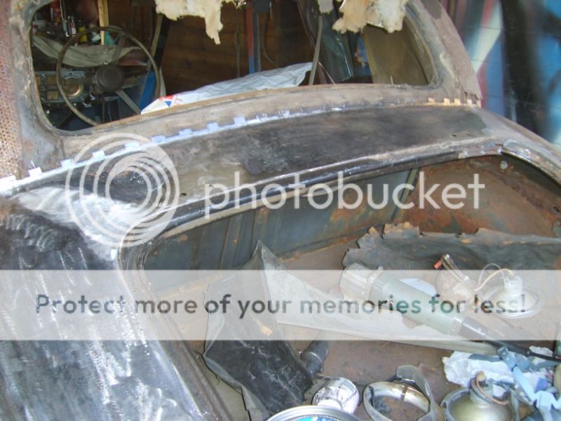

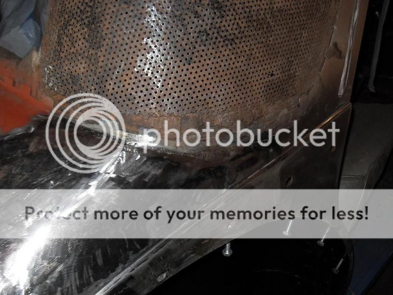

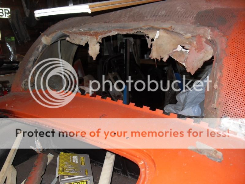

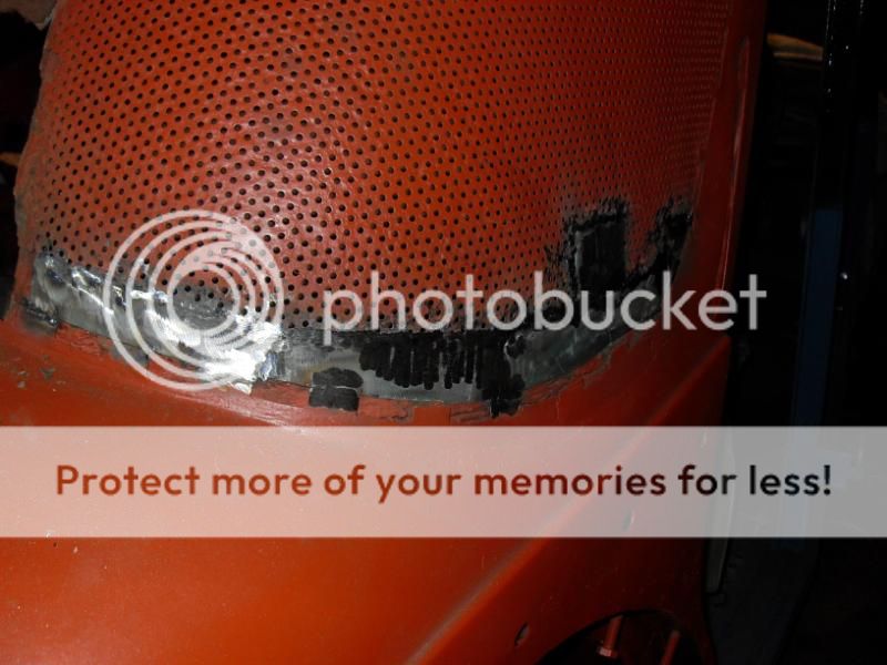

I also replaced the last of the body to roof edge section which if you remember looked liked this.
So here are the end results
And of course my good old red oxide came in to play along with the hammerite
I've repaired the roof edge of the drivers side rear with ordinary sheet steel, I'll leave the passenger side rear and window surround edges until the timber window frame is repaired
So its time to start on the rotten window frame, tonight I've just removed the bottom section in order to use it as a template for the replacement.
Getting these bits done around the rear window will be a real milestone, as although there is no end to the work in sight the main body will be structurally complete, I think I'll have an extra glass or two when thats done.
