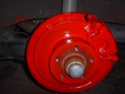

To cope with that earth shattering increase in power, you need the same paint on the brake calipers :lol: :scared:
Re: Austin, Renault, Rover and more - 07/02 Renault
#737 Post by TerryG »
There's nothing wrong with painted brake callipers.
However, this guy may have gone a bit outside the lines.
