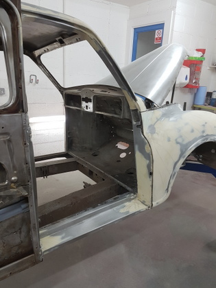

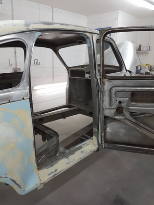

Work progresses albeit slowly - the front wing reprofiling is now complete with the other panels on the offside at various stages - I tend to stick to working two to three panels at a time - that way drying times can be allowed for - if you try to run too quickly and work too many panels at once the progress becomes very slow and it is very easy to loose your way - although the wing has a skim of filler to circa 80% of the surface area - it is literally just a skim - I always get my panels to a less than 5mm tolerance of true before skimming - but with the vehicle heading for 70 years old and this being the second restoration along with no new panel availability there is no other way of correcting the panel profiles

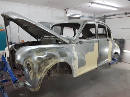

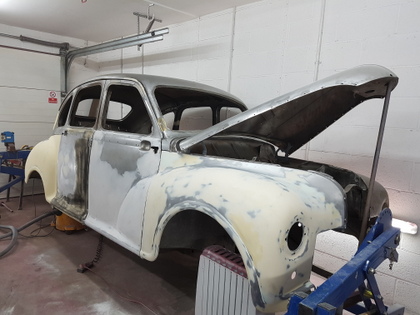

So fast forward a solid week of skimming, blocking and flatting in order correct the profiles and that is just the one side done but includes all the apertures - will move onto the nearside tomorrow - still have the rear shroud between the rear quarter glass and the rear wing to do - but need to remove the wing first and cannot do that until I remove the chassis tilter and support the bodyshell on to axle stands (bumper irons fasten to the tilter but travel through apertures on both the front & rear wings)

That's really not bad at all for the age of the panels and is going to make a world of different to the paint. Quite exciting seeing this bit coming together.

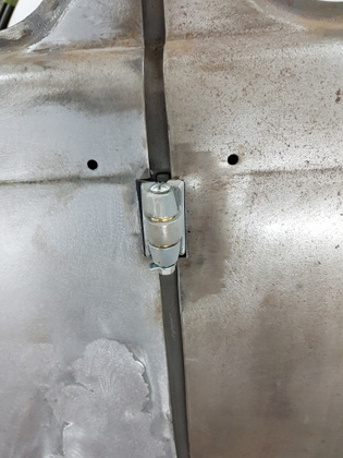

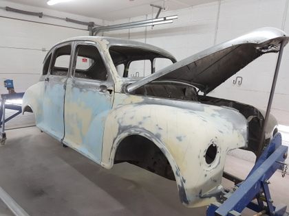

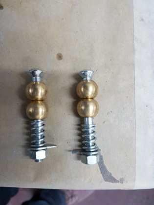

More progress today I found a supplier for door hinge pins sets which included new brass bearings (turned out the series 1 Land Rover has identical door pins) so with these fitted I had to make a few minor adjustments to the aperture gapping - Then cracked on straightening up the panels on the nearside and started skimming up - the rear door is being left for a photo shoot / article feature for PC which happens on Monday

Those hinge pins look really complicated, I always thought door pins were just sort of non-threaded bolts, if that makes sense?
