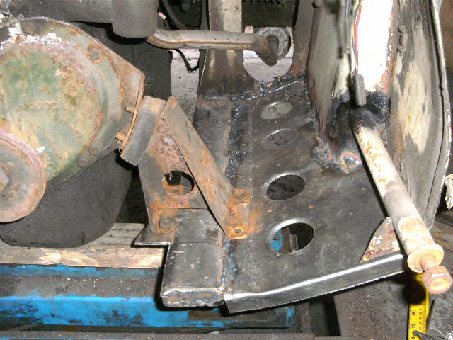

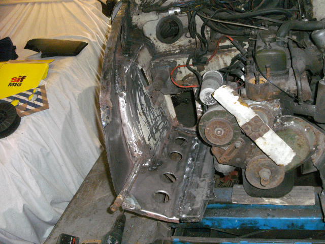

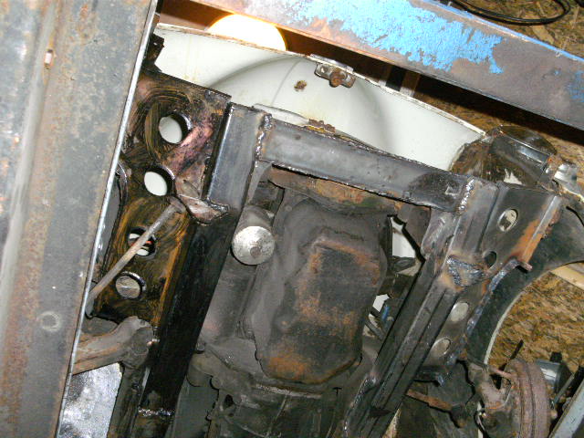

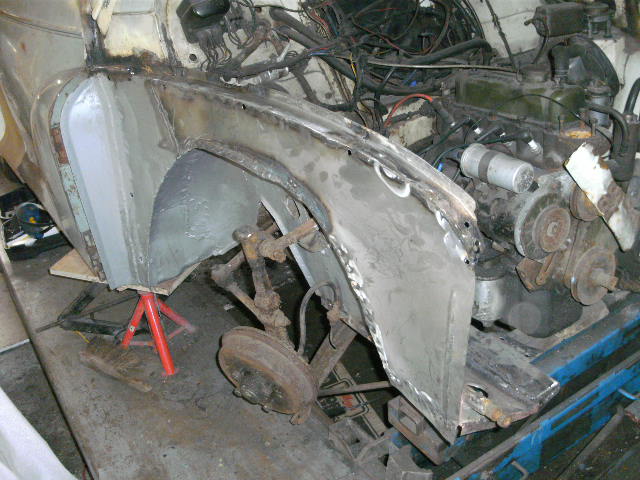

Not so much work on the cars at the moment, been fitting a new front door to the house as the old one warped with all this damp weather. I did manage some work on the minor before though, both front chassis legs, the tie plates, and rh inner wing have been replaced, all the panels being fabricated as I go along.

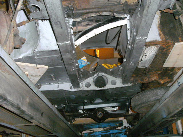

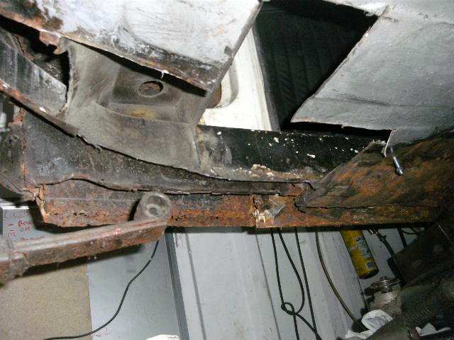

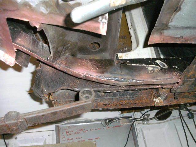

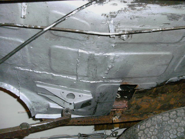

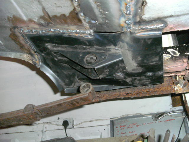

I have done a little more on the minor, this time the rear spring hanger, cut the old one away and repaired the lower edge of the inner sill.
Then welded the panel on from underneath, still a little to finish on the patch inboard of the repair section.

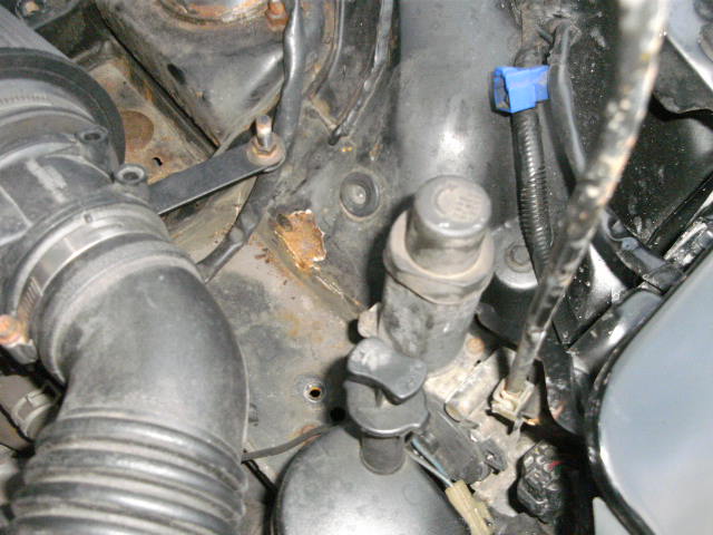

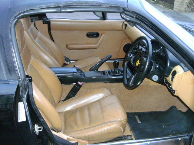

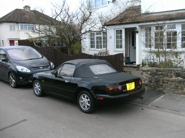

We finaly picked up the mx5 on saturday, drove it 400 miles back with no problems, generally very happy with it, the interior needs a bit of a clean, and the leather treating .
After a good look over I can only find one small area of corrosion on the rh inner wing, it looks like part of the inner wing has been replaced after accident damage many years ago and corrosion has got into the seam weld, will be easy enough to fix, a tiny amount of welding (patch about 50p piece size) and the rest cleaning up and painting.
Some pictures below. The last one shows the rusty area.

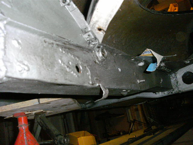

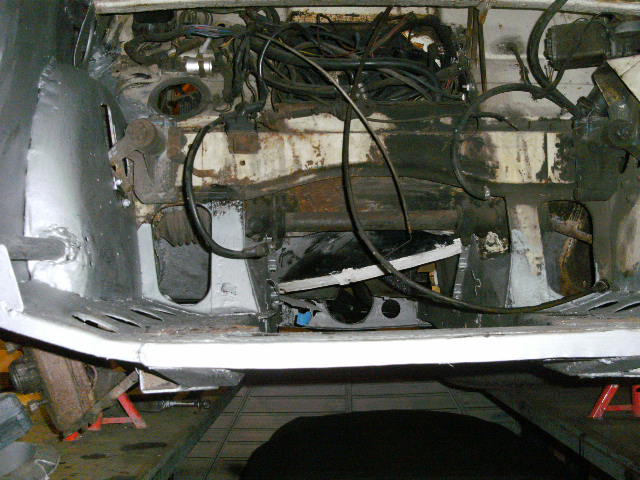

On the minor front all of the rusted areas have been primed and the engine, gearbox and most of the suspension removed ready to stone chip the areas which wont be accessable when it is back in it's corner of the garage.
Plan is to get this done and it back on it's wheels by easter.
