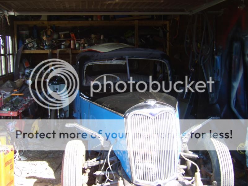

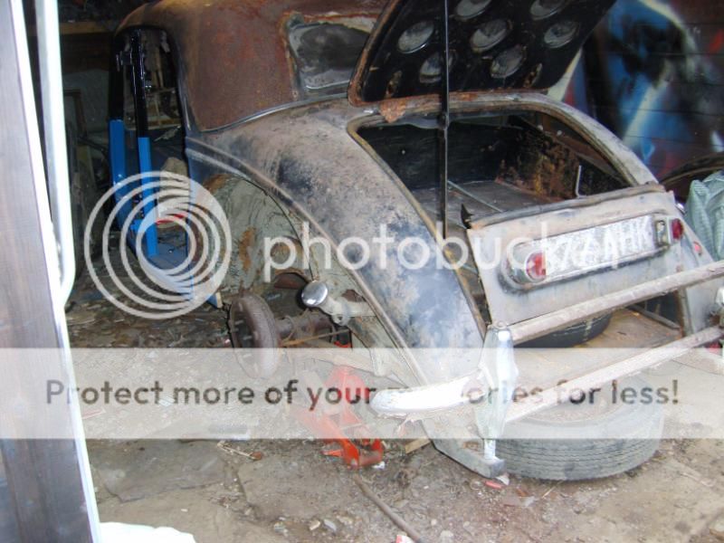

Anyway, time for a reality check as to how much still needs doing to the main body, so we turned her around ready for the rear end work and started stripping the bits off.
The rear window frame is going to need some joinery as its quite soft
Grotty inner arch and c pillar
Boot floor needs plenty of new metal
It is a little daunting starting the rear as there is plenty to do, so a little at a time and it will come together like the front. On the upside I found a "new" unopened can of duckhams oil from the late sixties along with an old tin of swarfega tucked away in a corner of the boot that proclaimed "For housewives and Grubby children too" which I rather like.

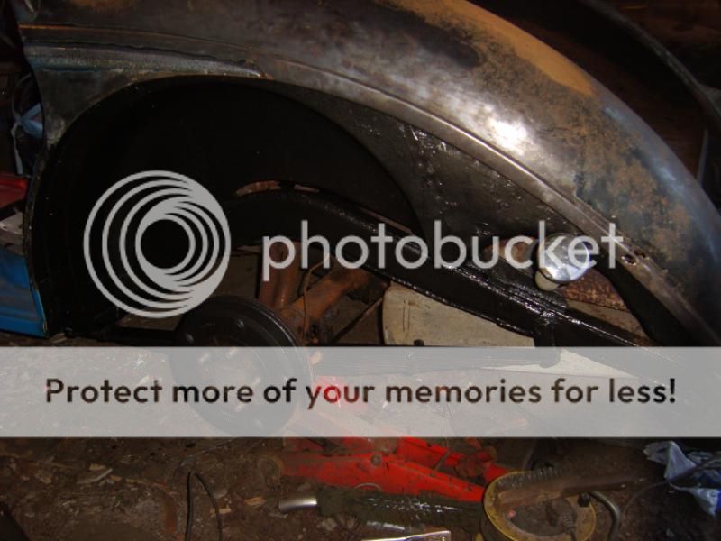

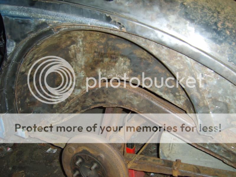

So, I decided to start with the passenger side inner arch and c pillar
Rot cut out and new metal welded in
This was followed by a good wire brushing
And a start at protecting it with my old favourite hammerite
So, thats one area nearly done, hopefully things will now keep progressing.
