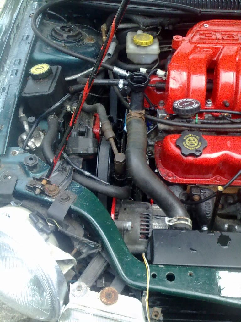

I just noticed what seems to be a straight and solid cooling hose from the engine to the rad. You'll want to change that to a flexi or convoluted hose or it will snap either the rad inlet or the other end.

A straight and solid hose?
I think you may have missed a few photos when looking through the
build, and hassle I had with the filler neck. Here is the same pipe from
a different angle.
a different angle.
3xpendable
- Posts: 814
Apologies, I was watching the video from my iPod and the angle of the camera makes it look straight.
2013 Dodge Durango R/T
2019 Ford Mustang Bullitt.
