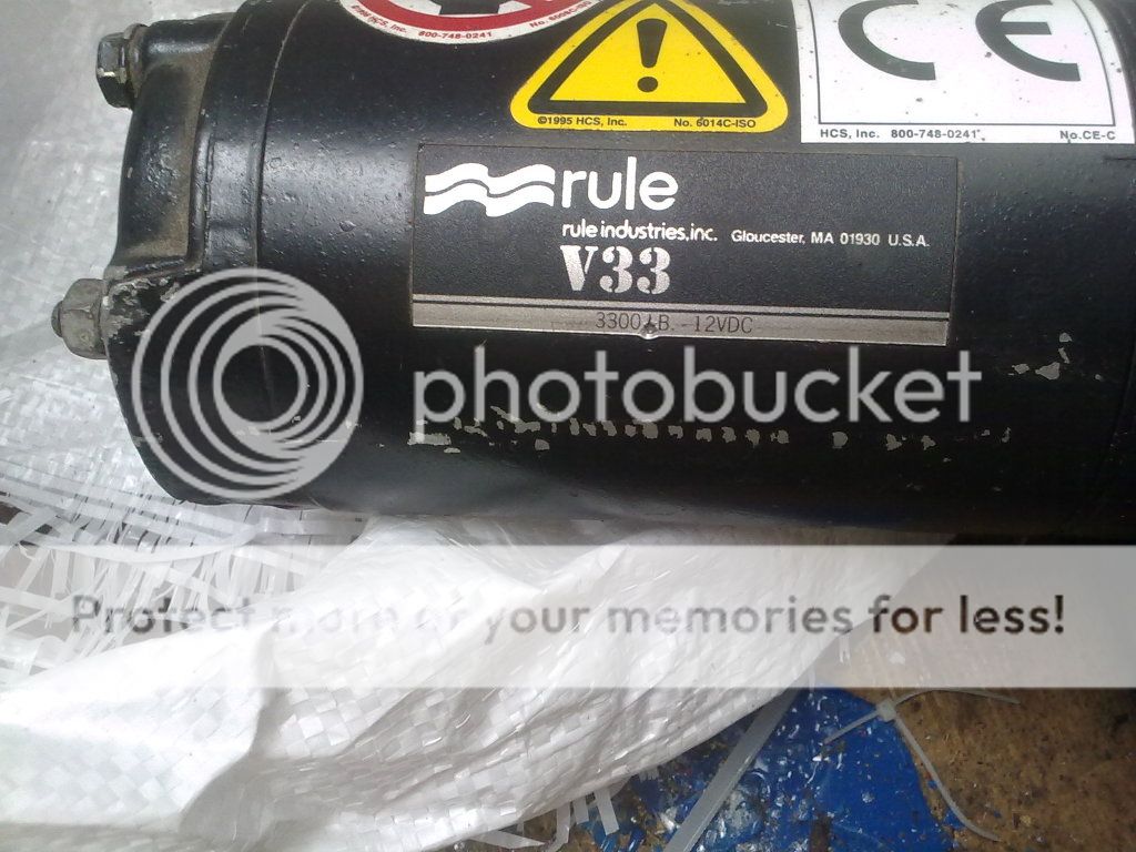

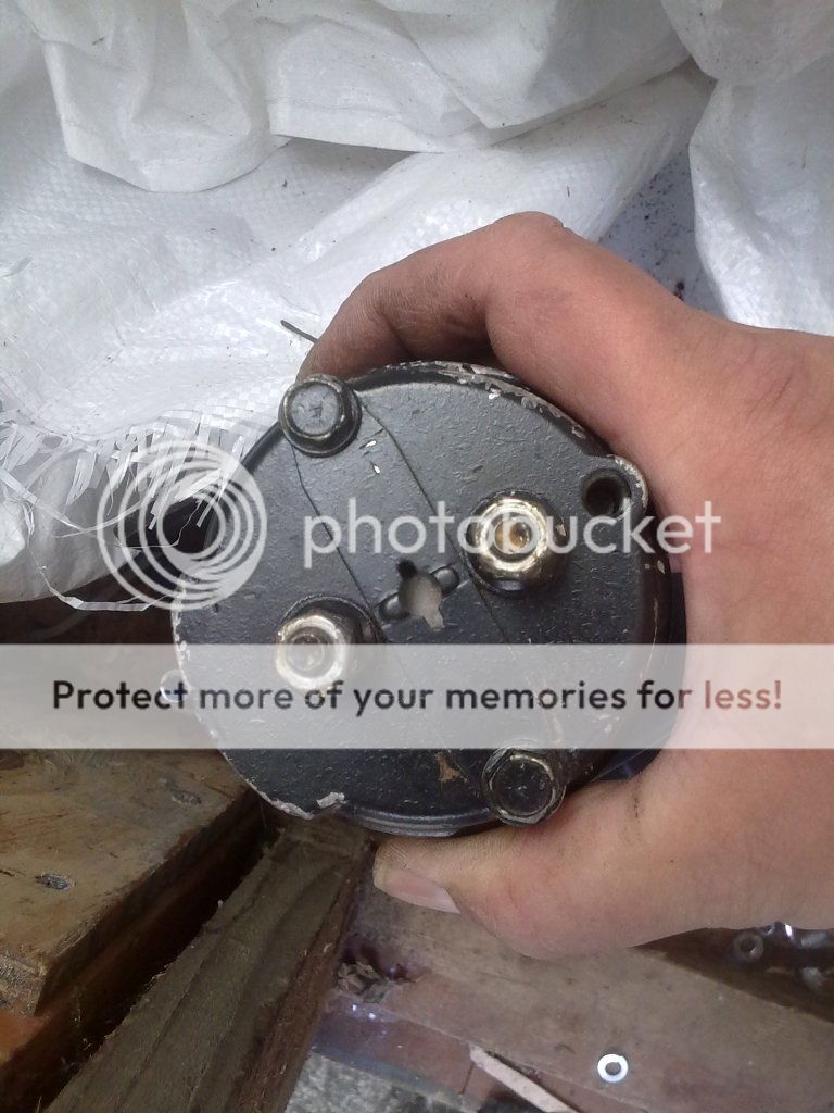

#627 Post by Mitsuru »

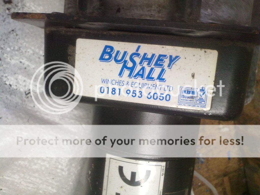

The winch arrived today so a couple of snaps so you you know what
I got for £40.00. I quickly unboxed it and hid it in my tool shed out of
sight so dad didn't see it! If he had seen it before I had mounted it to
the platform, it would have spoiled the surprise.
The end of the motor apears to be the terminals.

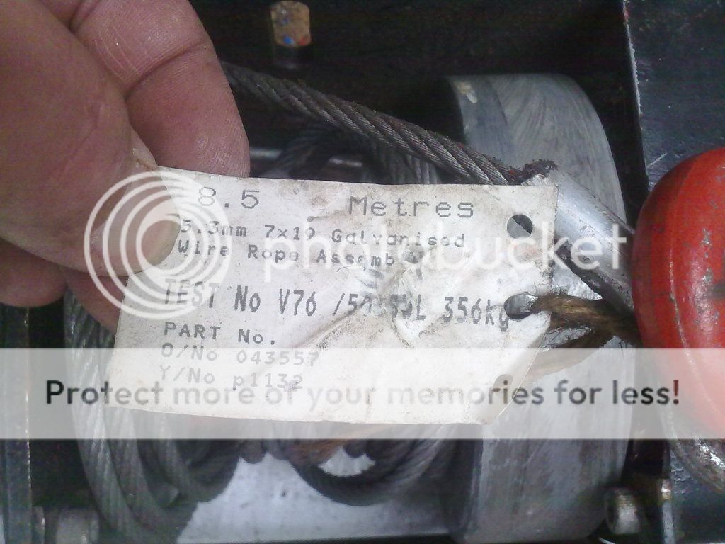

And the tag was still on the hook end of the cable, and shows 5.3mm
and length 8.5 metres.
I hope that the 356 kg marked on the tag is not the maximum weight
the cable can take!!
The max cable it can take is 5.5 mm 15.2metres long.
pryantcc
Posts: 289
#628 Post by pryantcc »
That's exactly what it is: SWL Safe Working Load.
#629 Post by JPB »
Oh well, never mind. If you find a stricken Aixam, MC or Ligier Ambra in a dyke somewhere, that string's roughly strong enough to extract one of those. If its Diesel tank isn't full that is. :o

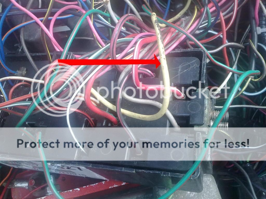

Okay a little news and it's not good!
Below is a photograph of a an example I am faced with. I have placed
an arrow against one of the causes of my headaches with the wiring.
According to the various destruction manuals I have for the Neon the
wire which the arrow is pointing to is supposed to be Yellow!!!
Does that look yellow to you? as it looks white to me!
Is it any wonder I thought I was loosing the plot! :(
There are others like this, which is why I am thinking it might me only
one option as I am dealing with two wiring looms here.
That option is to remove all the black tape I've wrapped the wiring in
and trace each wire from one end to the other, to check which plug it is
in and which pin it is for and where it should be going etc. :x
