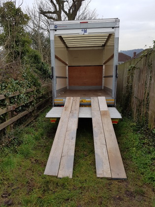

Have been looking to move a bare metal bodyshell 60 miles back to the workshop and enquired with several vehicle transport companies about covered vehicle transport but the quotes were galactic (£500 +) - then enquired about a covered vehicle trailer but would also have to hire a tow vehicle - so lots of messing about collecting a tow vehicle from one hirer and the trailer form another but at half of the above price - then at the suggestion of one of my fellow Jowett members resolved the issue with this idea - Transit Luton box van with a tail lift - cost was £70 for the hire + £30 in fuel

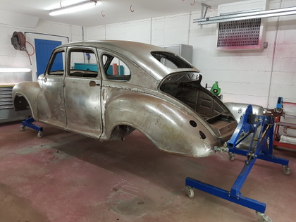

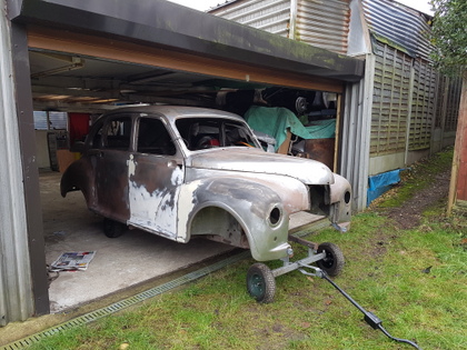

Net result of the transport logistics in the previous post is that of this evening this is in the workshop - anyone remember it ? - Yes it's the early Jowett Javelin that has already seen a massive input from me - now virtually untouched for the last 3 years since we relocated to the country - it's time to get cracking with it - it needs to be in in paint before the end of March so here goes

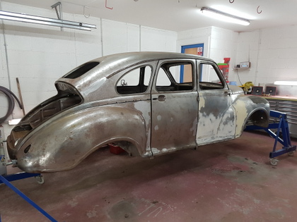

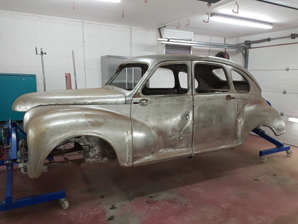

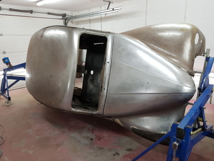

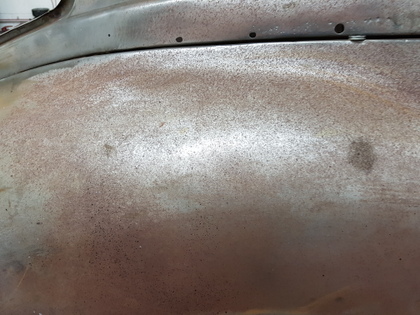

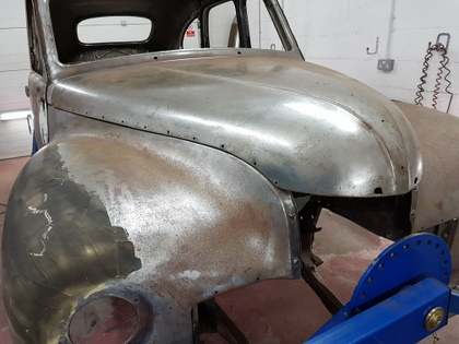

So got stuck in today - the shell has minor surface rust from being stood in storage (even though there was a dehumidifier running 24/7) - so spent much of the day with the DA sander with P80's discs & a rotary wire brush on the angle grinder in the difficult to access areas - just concentrated on the offside - still plenty to do on the inside / underside etc - but wanted to get the panels up to speed - straightened these up as required with a panel hammer & dolly prior to skimming with filler - I appreciate that most of the panels will have to be largely skimmed - it is the only way to get the minor deflection out of them - but it is only a skim - all body seams and larger areas of deflection have been lead loaded prior to applying the filler - the chassis tilter certainly makes an easy job of getting to the roof & underside
