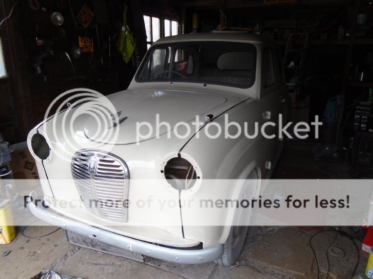

I did get on with the drivers side wing, more of the same so I didn't bother with photos though it did require more work than the nearside wing. Once I had everything fitting something like I got some paint on the wings and invested in new beading and sidelight plinths, worth noting here that wing beading from Woolies is a fraction of the price of Ebay sellers.
So a pleasant day was spent fully bolting up the wings and fitting beading etc, the brown rusty looking areas behind the headlight holes is actually lashings of cavity wax. I also splashed out the last of my pennies on a new windscreen seal and got that back in.
I've also taken care of painting the inside / bonnet / boot areas, nothing fancy, just a brush job in these areas, I also took the opportunity to drill holes in the inner sill areas and spray masses of cavity wax inside the sills in the hope of better protecting all that work.
The boot needs sweeping out again and another coat to finish
Although I have no photos I've also cleaned and undersealed the underside at the back end and got the petrol tank back on, made a new fuel line running the length of the car from copper pipe to replace the rusty one that was half steel and half rubber hose repairs.

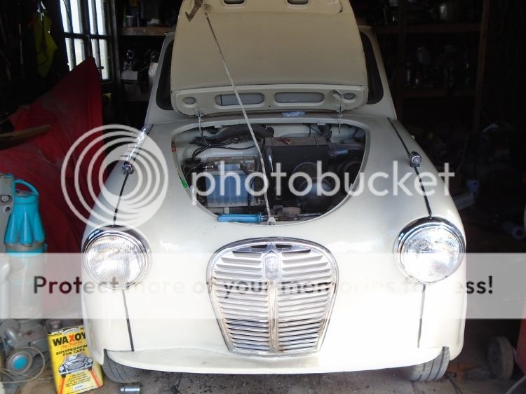

Thought I'd fetch this up to date as I'm away for the weekend and so won't get to achieve all I was hoping for a week or two, but things are coming together.
The new carpet has gone in along with the seats and door cards, I'm hoping in the future to recover the door cards and possibly recolour the seats but these are unnecessary jobs in comparison to those needed to get the old lady mobile again, so this is how she will stay for the foreseeable.
I've also fitted the lights and got all the electrics working so that's a much needed job done, two issues stored for the future now being I have used my last two sealed beam units and I bought Wipac plastic headlamp bowls which are a tight fit in the light apertures and seem to make the headlamps sit a little low to the wing tops, again something to be re visited in the future though nothing to stop the car from being used so they can be added to the "snagging" list. For now I need to get her mobile so I can make sure their are no hidden nasties with things like the gearbox or axle. She wasn't fit to do more than move her about slowly when she came so although all seems well in these departments I can't be sure just yet.
I then decided to get onto the brakes, hoping as she has had recentish pipes and hoses things might not be too bad, well, so far I have replaced the rear brake cable that was rather rusty and frayed then re sealed the master cylinder, which as mentioned in my last post is yet another thing on my growing list of bits and pieces to revisit later, it wasn't too bad at all really but just not quite good enough in my opinion to leave for the long term.
Anyways, here she is after a little love
Good enough at least in order to go over the rest of the brake system and to shake the car down on local roads.
I've also re-sealed the rear brake frame cylinder that operates the rather old fashioned even by 1950's standards mechanical rear braking system. That went better and the cylinder seemed a perfect candidate for a re seal so at least that hasn't caused further troubles.
