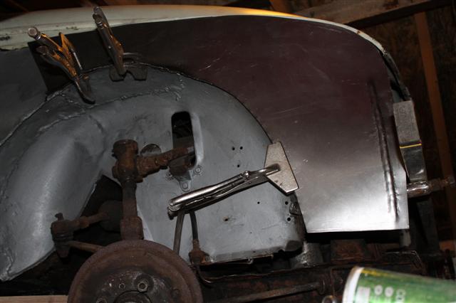

Also cut the remains of the inner wing off and started making a new one.

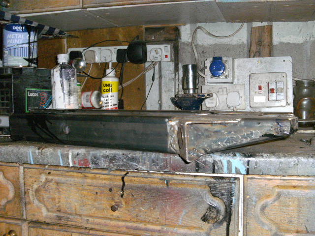

Also cut the very rusty and extensively patched front end of the chassis rail out and trial fitted the steel tube I plan to use to replace it with. THe tube fits neaty inside the existing rail, but being thicker will alleviate the rust traps in the double skinning of the original one.

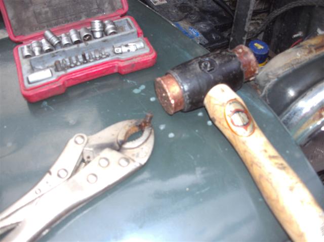

firsty I changed the waterpump, all went well until one of the bottom bolts sheared off.
PICT0253 (Small).JPG (78.57 KiB) Viewed 2640 times
Fortunately the rest came undone and the pump came off without too much of a struggle, a few taps on the end of the remains with my favourite X mas present and some mole grips got the remains of the bolt out. I then took a new bolt out of an old engine I had lying around.

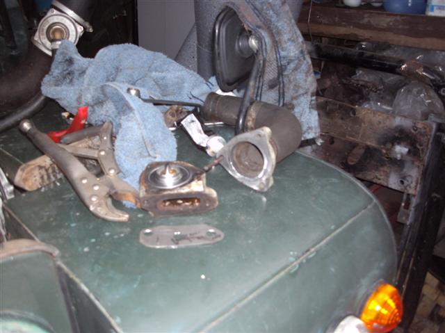

Next up was the improvements, I wanted to fit a 88c thermostat but you can't get these in the original shrouded design, so I changed the cooling sytem to something like the defender which uses a conventional thermostat. I blanked off most of the bypass except for a 3/8 hole using a steel plate and then modified the thermostat housing by presssing a piece of tube inside, the thermostat also had to have a small bleed hole drilled in it. It also has LPG which is permamant bypass flow in the same way the defnder has a permanant flow heater
PICT0258 (Small).JPG (78.92 KiB) Viewed 2640 times
FInally the air leak turned out to be between the manifold and carb adaptor, I removed it, made a new gasket and re-fitted.

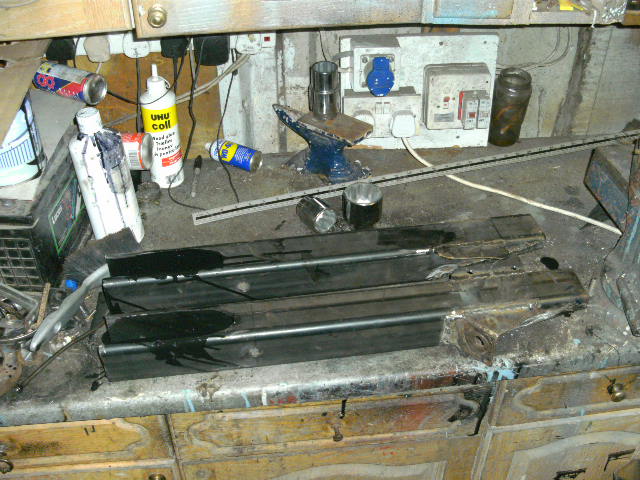

This did not leave much time for the minor, I have finished fabricating the chassis rails though, the only thing left to do is weld the lh tie bar bracket on but I dont want to cut the lh side around to remove it until I have used it to line up the rh side. I have also painted the inside by tipping half a tin in and swilling it around, you can see where I tipped it out in the photos.

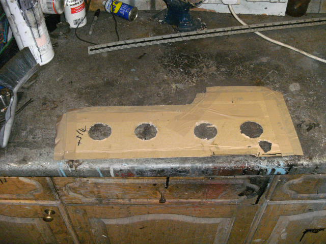

I aslo made a template for the tie panels, once these are made I can put the rh side together.
