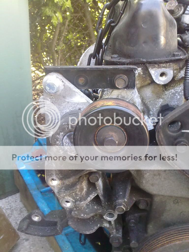

#68 Post by Mitsuru »
Ok today the Voyager belt arrived so did the pulley.
The idler pulley I bought is not mopar but for AUDI A4, A6, & A8.
Yes they use the same width and ribbed v-belt, but different
lengths so more options for parts.
But first lets get the power steering pump bracket sorted out!
I was thinking Just one bit of sheet steel wit the relivant holes,
and notches cut out. But that ment the pump has too far back.
It is easier to put washers in-between the bracket and the pump
to move it back if necessary for lining up the belt.
There is a fixing plate which if necessary could be made to rotate
it to adjust the belt a little more if needed, two small bolts holding
it in place at the moment. A spacer plate then the front pump
fixing/holding plate. I used the old bracket as a template to make it
easier for that one.
Iplaced the pulley on the shaft of the pump and put the belt on to
see what kind of adjustments need to be made.
Err how is the belt staying on you ask?
The alternator is not going to stay like that. And it's next on my to
do list. I have to make templates for it and the spring loaded
pensioner. I will be getting a new belt too as the voyagers is way to
big for my set up, but I will measure up after the brackets have
been finished.
