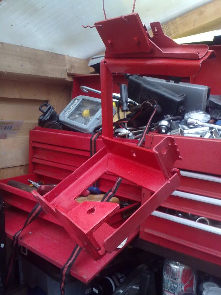

As I couldn't get the battery into the tray because the side lip
was too high and the metal backing/frame for the passenger
side headlight was getting in the way. So out with battery tray
and out with the grinder.
Before
After
And after 3rd coat of gray primer
2+ coats of primer to go then the colour.

#515 Post by Mitsuru »
After over doing it on monday the most of tuesday resting.
But when I went to give the battery tray a coat of colour paint,
I found 3 spray cans were full but couldn't spray, 2 empties, and
I got 3/4 of a coat of red before it too ran out!
I have to go food shopping so I'll grab some spray cans while I'm
out. I wouldn't have minded too much but with it being nice and
warm it was dry within 30 minutes, I could have done all the coats
of paint & had it refitted today!
A rare chance to sit in the garden and take in the sun.
The weather forecast from thursday onwards? RAIN
The battery tray red is going to be a lighter shade once done so it
matches the intake manifold and the rocker covers, so it contrasts
againtst the black and gray that is the battery, the fuse boxes, the
TCU and the wiring loom wrapped in black tape.
What do you think on the colour scheme?

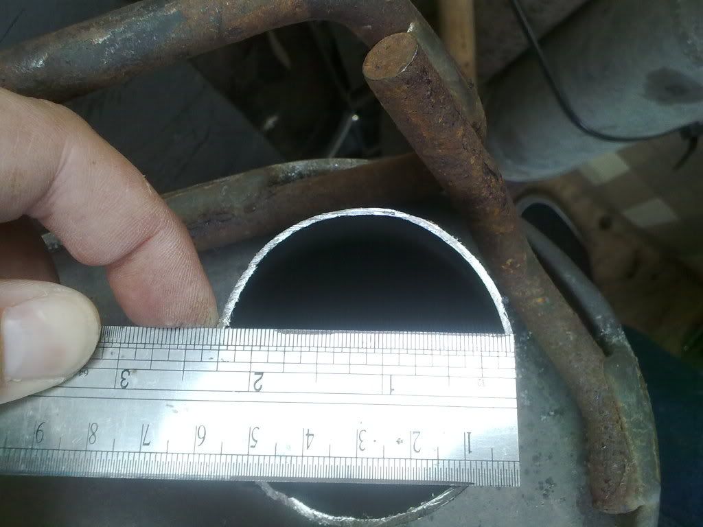

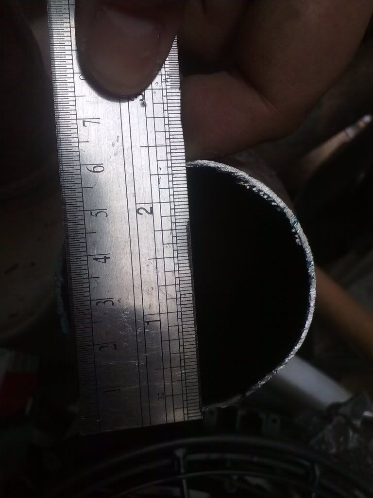

I had previously stated that the exhaust pipe on the Nissan 350z
was 2.5 inches. After I dug out the ruler and lined up the parts it
would appear that this is not the case.
It appears that the Nissan 360z exhaust system uses the 2.25 inch
pipe which the Neon uses. The information I had used from Jo@'s
thread and from a Nissan forum seams to be inaccurate.
This one is a little battered on the end but is still rather close
too.
The mufflers measurements hight about 7.25 inches, and approx
13 inches wide.

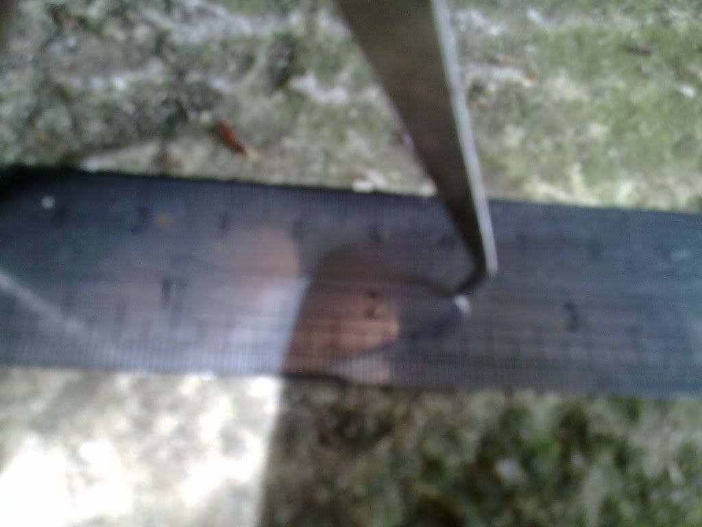

A quick measure of the pipe on the car, as on the ground I don't
think it worked quite right as it was too stiff!
The battery tray may need sanding before it's final coat.
