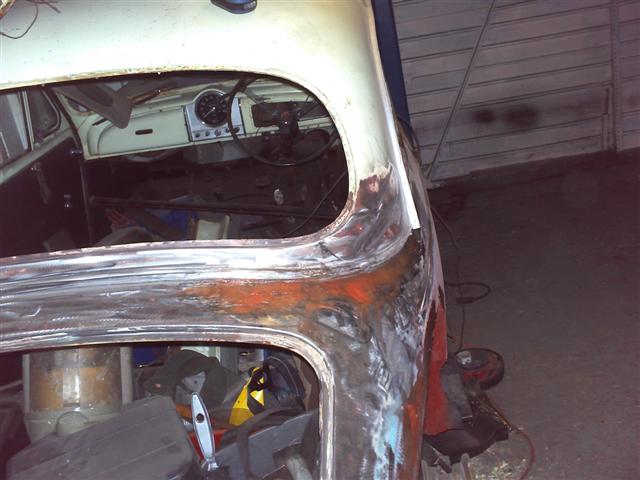

I have also done a little on the minor, we removed the A post rear face to enable the rusty flange to be replaced and any surface rust in the seams to be removed, It has been repaired and is now ready to go back on so this area will soon be finished.

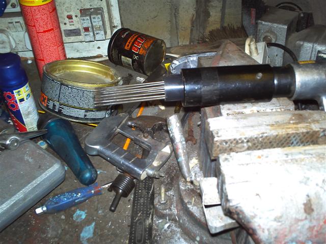

I also go a needle de-scaler for my birthday, does not get back to bare metal but certainly cleans all the deeper rust and underseal off as the picture of the wheelhouse shows.
PICT0050 (Small).JPG (70.51 KiB) Viewed 3216 times
PICT0048 (Small).JPG (69.02 KiB) Viewed 3216 times

Finaly I started filling the repairs at the rear, the deper parts where the lead had come out were filled with the fibre filler and a thin coat spread over the welds, being non porus this makes sure any porosity is completely sealed, plan is to get the rear filled and a coat of etch primer on to seal it.
PICT0049 (Small).JPG (51.08 KiB) Viewed 3216 times

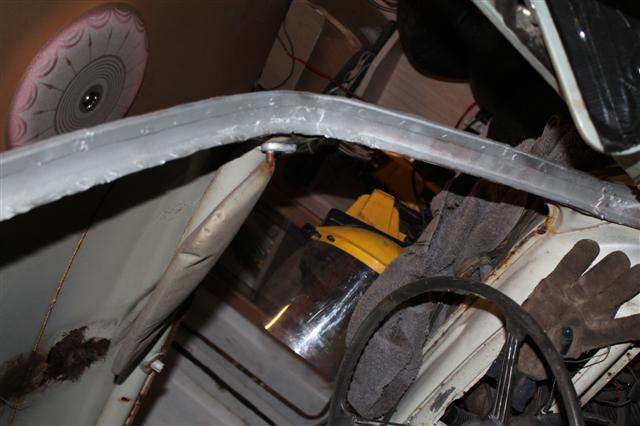

Also done some more welding on the Morris, cleaned up the welds on the gutters and primed, them.

I also had to modify the door frame to give better clearance to the roof, I cut 4 mm out of the divider bar and pulled the frame down to meet and welded it together, we now have great door to roof fit.
IMG_1313 (Small).JPG (47.19 KiB) Viewed 3177 times

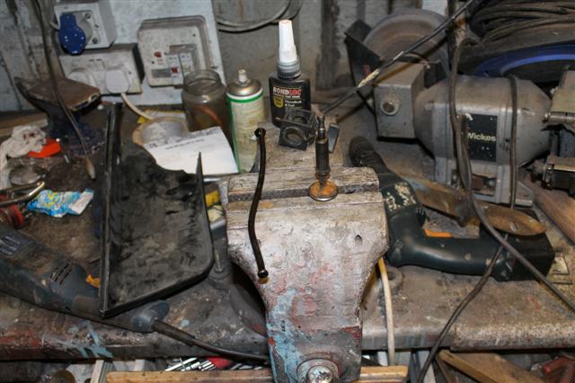

I have also pulled the water pump out of the elan, the original pump is part of the front cover and a major task to change, a couple of years a go I machined a removable cartridge type, this is done by machining the centre of the original pump out then machining up a new core.
The core came out easily enough with the radiator in place (just 7 bolts in total), the source of the leak then became obvious, the o ring which seals the core to the cover had been trapped and cut, the reason for this is there is quite a sharp edge on the cover, I will remove this with some emery paper and put it back together with a new O ring, the pictures are of the cartridge / core with a new O ring fitted (the one near the flange), the damaged O ring and a picture of the front of the engine (looking through a small gap from underneath)
IMG_1309 (Small).JPG (54.32 KiB) Viewed 3177 times
IMG_1310 (Small).JPG (65.26 KiB) Viewed 3177 times
IMG_1311 (Small).JPG (29.02 KiB) Viewed 3177 times
