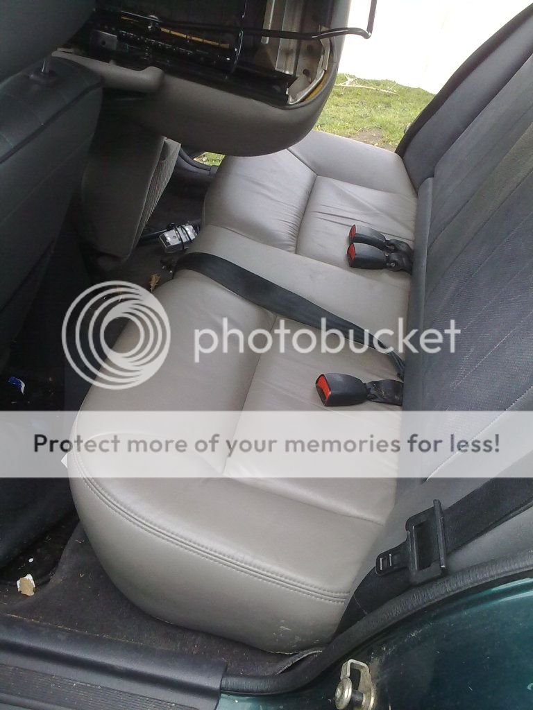

#427 Post by Mitsuru »
Sorry if you think I was screaming! but if I had it would be double the normal font size and in red.
MK1 Neon
MK2 Neon
I didn't realise till looking at those pictures the door locking mechanisms are different as well.
The seat frame on the mk2 Neon's have the same fitting pastern as the mk1, but have a
stronger/more robust frame than the mk1.
(As I use the door frame and seat to haul me out of the car it needs to be robust!)

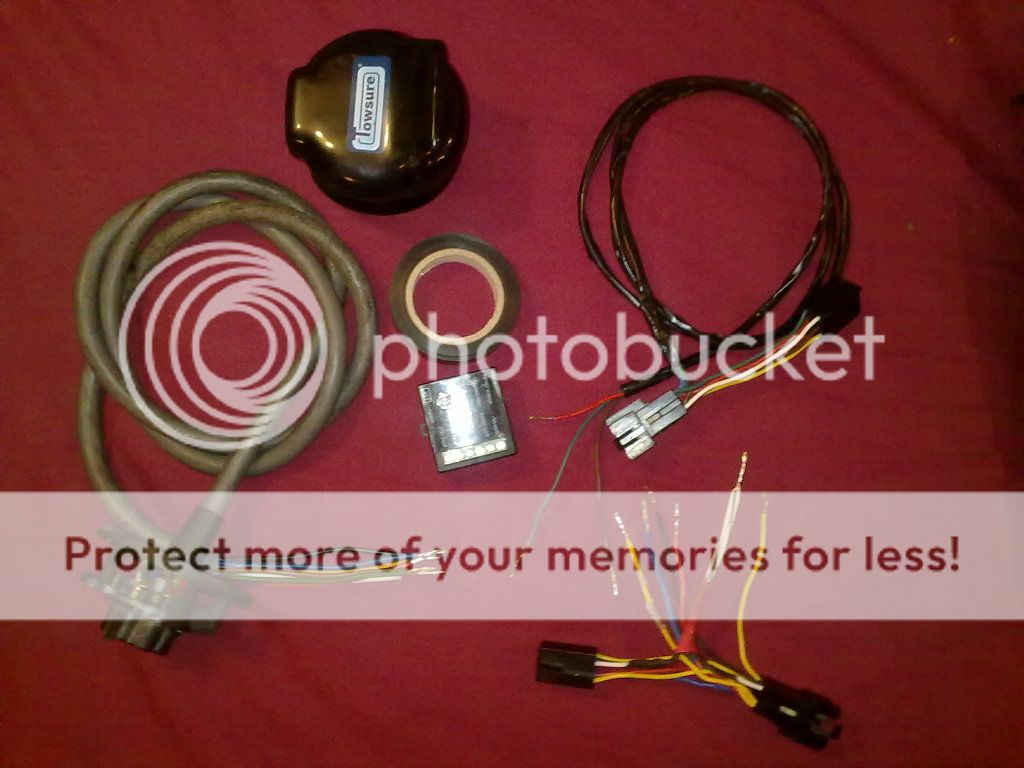

Well in a break in the rain, I pulled the cover off the boot off
the car, and removed the interior wiring for the towbar/hitch
electrics.
I am waiting for a socket adapter for the bracket to turn a
single into a double on the bracket.
As the car already has a FAULTY 12n socket, so I thought that
I may as well fit the 12s socket to the car as I redo the 12n.
I have soldered the cable ends to help with connections and
against water penetration. The 12s came with a triggered relay
which is also in the photo below.

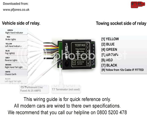

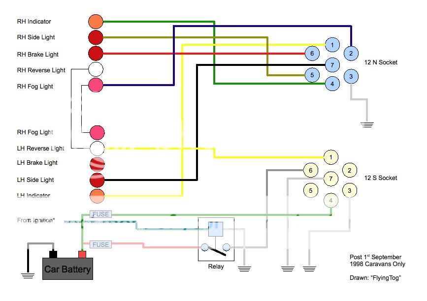

A few wiring diagrams.
I nicked this picture of a bypass relay for illustration purposes.
I have ordered on off the internet, but with it being the Easter
ban holiday weekend, I don't expect to see it till Friday!

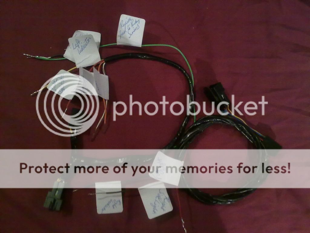

I decided to plug in the towbar electrics and see what wire was for what.
I found that there was a damaged wire on the interior lights kept blowing
the fuse. So that had to be dealt with too!
I shortened the 12n plug wires that were in the boot and soldered the
ends for better connection. I moved the box of tricks for parking sensors &
stuck it to the inside of the rear wing behind the electric car ariel. I will be
sticking the relays for the towbar right next to it, so it will not be in a place
that it can get damaged like the wiring did previously.
The MK2 Neon door cards are going to get dumped at the local skips. I have
no space or need for them. That and I damaged one of the rear cards. As I
was at the beginning of a hypo, and had over done it again, I stopped doing
stuff and tidied up and put the mk2 base in by mistake!
After good cup of tea a few biscuits to bring my sugar levels back up. I grabbed
the wiring and stuff I needed for soldering more wires. After a good few hours of
sleep helped with painkillers. So in the wee small hours of the morning while I'm
wide awake, and started back on the towbar electrics again
(in the warmth of my room as it rains outside)
After the loom was put in the car, and after I had removed previously removed the
damaged wiring. It was now time to add good wires to extend the loom so it will
reach where it should. I added a spur off the wire for the reverse light, this it
operate the reverse parking sensors.
At least now I know why the loom caused faults with the lights, and that it shouldn't
be a problem once the relay is fitted along with the 12s socket.
