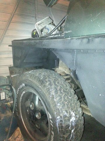

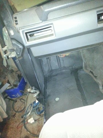

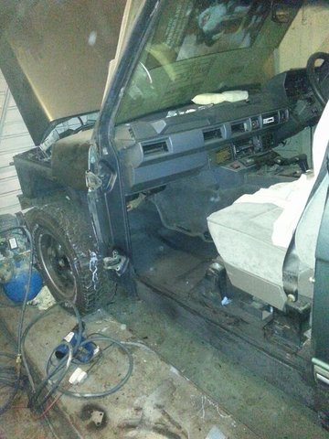

And where I am now, anothrer couple of hours and it will be finished.

it's been a bit of a marathon but hopefully it should be ready to take a for an MOT next week, I have checked over the obvious things and the only thing that worry me are the emissions but hopefully these will be OK on LPG, a couple of the dampers begining to weep (but still seem to work fine) and quite a few of the bushes are a bit perished but have no free play, so the plan is to submit it and fix whatever comes up, the rest will then be part of this years on -going work which at the moment is:
Repalce RH wing mounting rail and any rust on front inner wing
Remove radiator grille and clean / paint / weld any rust behind lamps etc
sort out slightly eratic idle on gas and LPG, idle speed drops as engine gets hot in traffic (suspect fault with the mechanical bi-metal strip controlled idle valve)
Remove non functioining alarm, tidy up birds nest of wiring
Paint and fit new rear doors
paint the rest of the vehicle.
