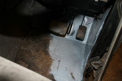

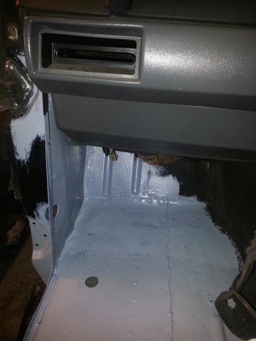

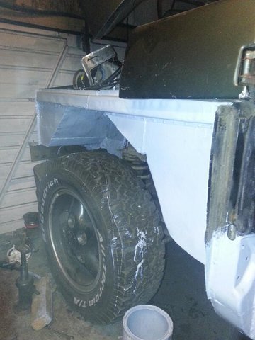

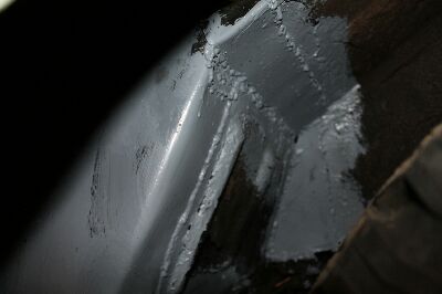

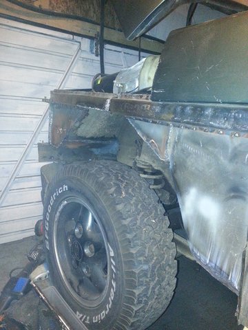

Some pictures of the progress on the range rover, firstly the repaired footwell from inside.

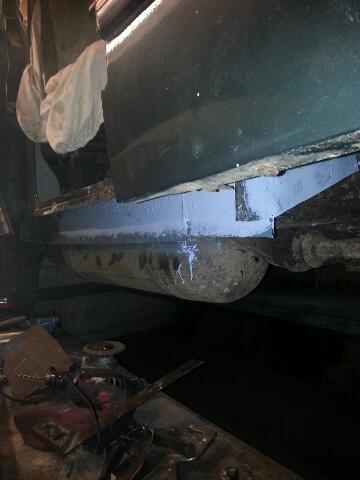

And from the outside, the panel to the outside goes right to the top inside and is bolted using the inner wing bolts, eventually I will remove both wings and the cowl and repir the upper area properly, for now it will just all be sealed up.

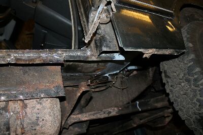

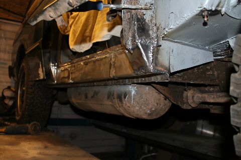

The base of the a pillar most of the outer sill and the front of the inner / body mount all removed, I have a piece of 5mm plate I put between the lpg tank and working area.
Still a bit to do but it should not take too long, hopefully by next weekend, though I am also decorating a bedroom at the same time!

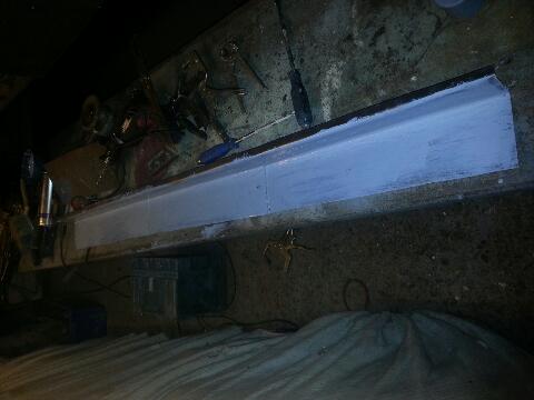

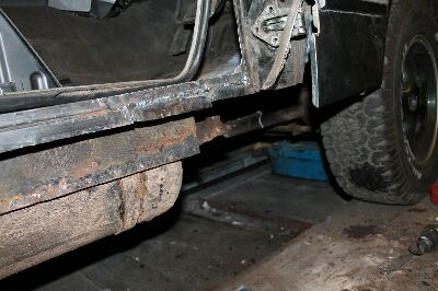

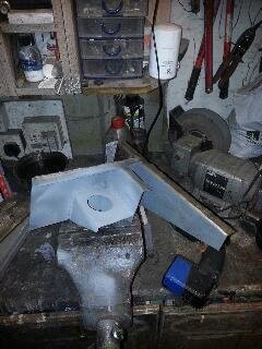

Some progress last night, the repair section has been seam welded up and fitted.
Ialso folded up the new outer sill.
hopefully i will get the outer sill on tomorrow then the base of the pillars and paint.

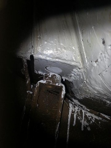

Finished the drivers side welding tonight,sills and pillars welded.
Then painted with epoxy.

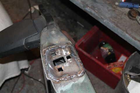

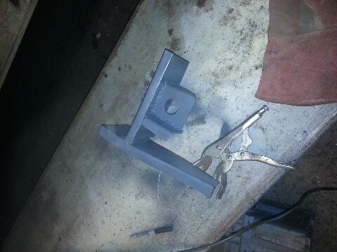

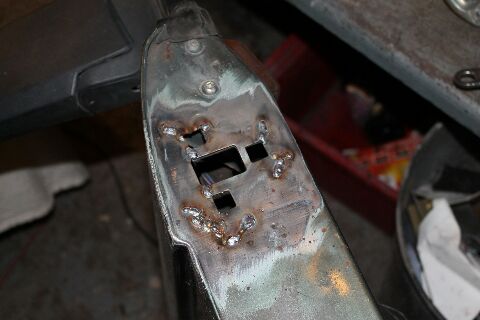

I then turned my attention to the front door, it is completely rust free but had cracked around the top hinge, firstly I welded the cracks.
Then welded a plate over the top, fortunatelly there were several shims so the thickness of the plate wont be a problem.

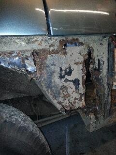

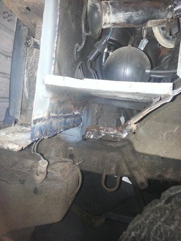

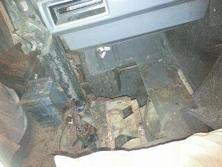

Spent most of xmas on the rr (when I wasn't laid up with flu) passenger sided rust was considerably worse than drivers, ended up replacing:
Outer sill
Front of sill body mount
Front floor
Kick panel
Wing mounting rail
Large parts of inner wing
Base of bulkhead body mount
base of front panel body mount.
Its all now painted just awaiting re-assembly and hopefully it should be ready for an MOT.
