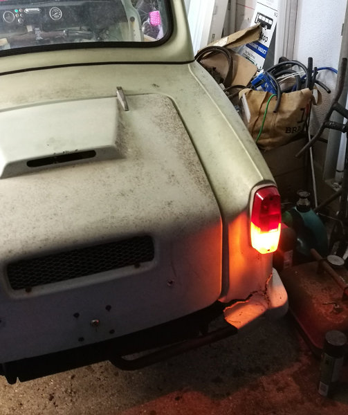

Have successfully had life out of the indicator circuits now - especially having worked out which terminals to short out on the stalk (which is *utterly* knackered) so I can actually get life out of both the dash lamp and the exterior ones. Looking at it more carefully I think there's actually an entire part of the assembly outright missing.
The flash rate is a little higher than I'd usually like, but I think it'll be perfectly fine for a vehicle of this age. If anything else, the pattern being different to you'd expect from a modern car is a good thing as it makes it more visible, and with a car this small you want every bit of visibility you can get.
The more exciting part of this for me though is this...
Which confirms to me that the front-rear lighting loom is in fact intact.
...Even if the fact that it was the brake light that started flashing did initially confuse me. The previous owner has managed to put the backplate on upside down. The indicator is actually meant to be at the top, I'll turn it around tomorrow. Now I better understand the lighting loom, running the missing section from left to right shouldn't be too hard. Just three wires. With a bit of luck, tomorrow I'll have fully functioning rear light clusters.

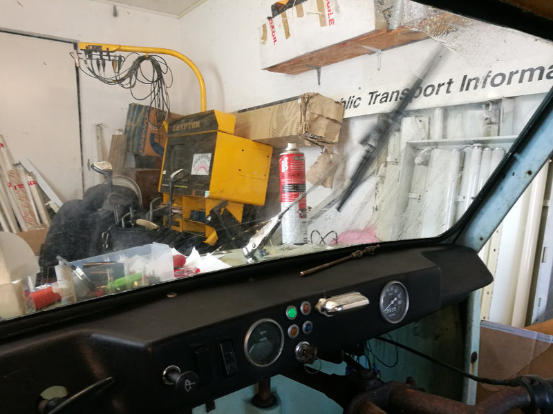

Yep, the windscreen wiper is now working just fine too. Self parking is a bit touchy, but that's entirely due to the rocker switches which we've already mentioned. I note that the Lucas replacement for the wiper one is actually a "two speed" version, so if I do fit that later I may well stuff a timer unit in there to give me an intermittent option, as that's actually a nice thing to have.
The list of vehicle systems needing to be brought back to life is actually shrinking quite a bit now.

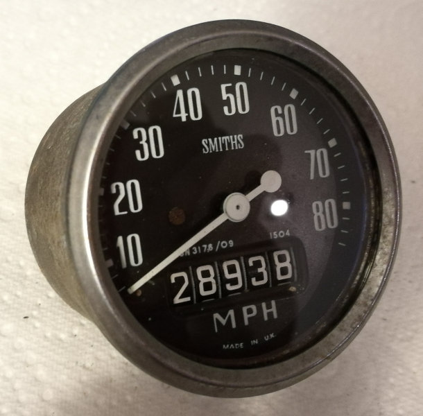

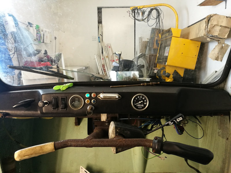

I decided to clean the speedometer up a bit. It was full of cobwebs before and one thoroughly dessicated spider. That was going to drive my OCD mad.
Being a typical 3.5" Smith's motorcycle style unit it had the twist-off bezel so was easy to get in to. Everything internally was actually in surprisingly clean condition behind the face, so I didn't mess with it. The only thing which seemed amiss was that the grease on the input coupling was quite gummy. Cleaned as much of that out as I could then put a fresh blob in there, it turns nice and freely now.
Didn't clean up too bad at all.
The wiring isn't proving too bad really so long as it's tackled methodically - quite a few bits just didn't initially make sense because so many bits were missing. Having plugged a few of the gaps it's making a lot more sense now. Especially now I've mostly tracked down the bits which differ slightly from the diagrams that predate the car by 3 years. Given the degree of hand assembly involved no two seem to be the same.

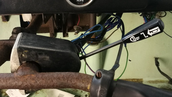

A fair bit of head scratching was caused also due to a dodgy indicator stalk as behaviour wasn't making sense due to how many contacts are involved and it behaving inconsistently.

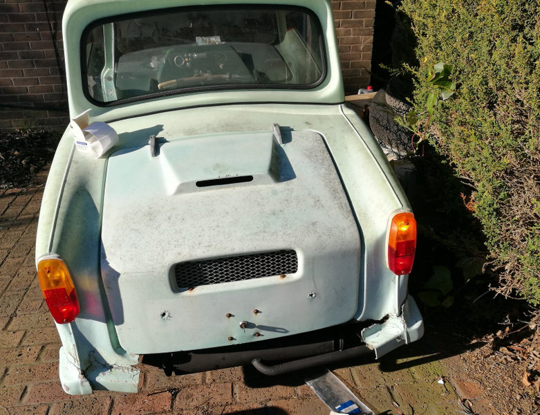

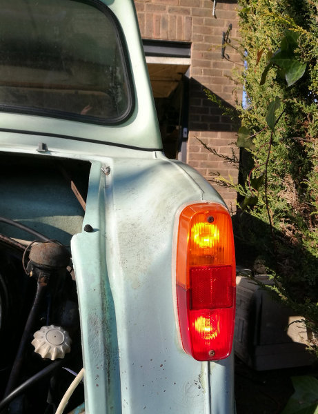

Couple of hours spent sitting out in the lovely sunshine this afternoon tidying up some of the engine bay wiring and reconnecting the tail lights properly. One thing I did change was to do the earthing locally. Originally they were grounded through a wire in the loom which went all the way back to the front bulkhead ground point. I decided that was daft, so grounded both ends of that wire, and stuck a ground connection to each cluster to a bolt under the ignition coil bracket on the near side, and the voltage regulator bracket on the offside.
Sure enough, look at that...we have fully functioning tail lights.
(Note that there's no hazard flasher functionality - I may well add that via a "bolt on" unit as it seems a useful feature to have).

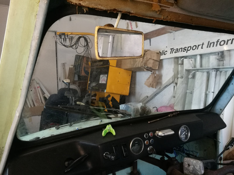

I was expecting a bit of a battle to get all three bits working at once, but nope...Brake, tail and indicators all operate correctly without having any effect on each other.
They are currently missing their gaskets, so I'll need to come back to that at some point in the future, but it'll do for now.

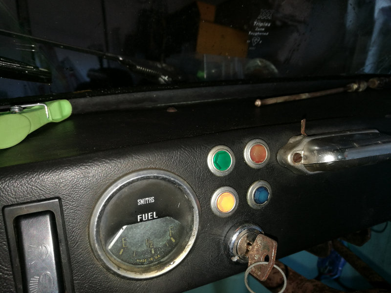

Glad to report that the dashboard indicator is also behaving itself. You've no excuse for forgetting to turn the indicators off in this thing as it's by far the brightest light on the dash - I had to use the flash to get this photo without it totally washing out. Amber is the one for the indicators, again like quite a few other cars from this era (and still quite common on motorcycles I believe).

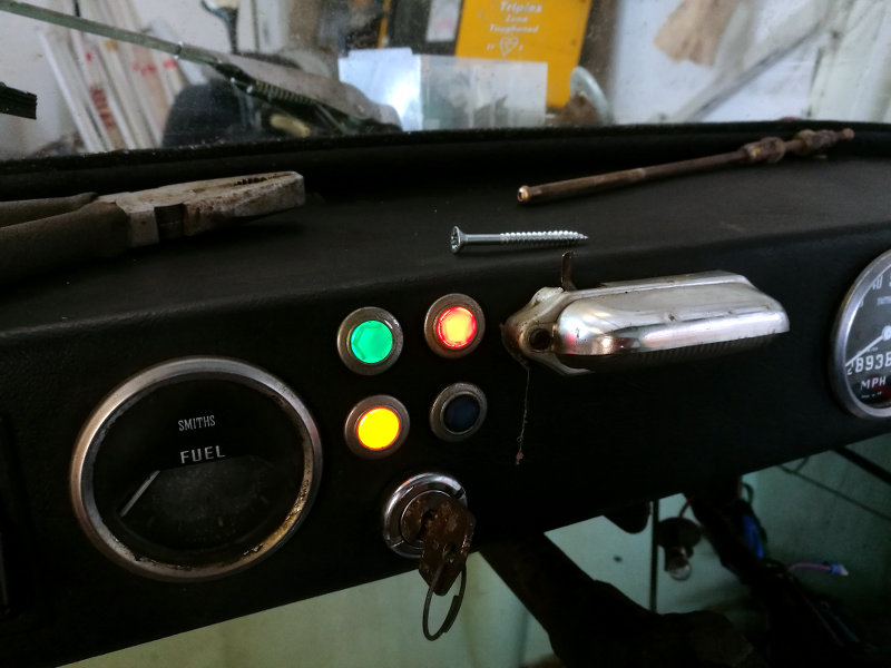

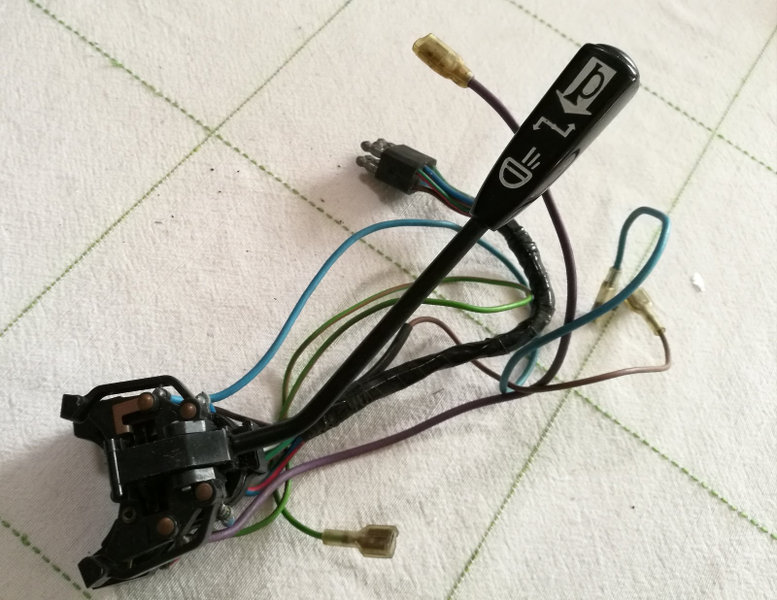

New indicator stalk arrived today...
The only difference (aside from the connector - which may well have been on the original one when it left the factory for all I know) I could see on the new stalk was that the new one has a purple wire that doesn't exist on the original. I've just terminated it and left it alone for now - guessing it might be a feed for a dim/dip device or something like that as it looks like it leads into the contacts that handle the headlight switching.
Pretty quick and painless job to get it wired in and the cover back in place.
...Though we did initially have a bit of a head scratcher, in that turning the indicators on resulted in all four flashing (and the flasher unit sounding distinctly unhappy about this). Took a bit of head scratching, but it turned out to be that the screws I'd used to fasten it to the column were too long and were bridging the contacts for the left/right selection. Switching them out for some that were slightly shorter resolved that issue and got things working as they should.
The offside ones still flash slightly faster than the nearside ones for some reason, will sort that out later. My money's on dodgy tail light earths until proven otherwise.
Funny how adding something like this does so much to make the dash look more complete.
I've not wrapped the wiring for this again yet, as I think I want to make it a bit longer as it currently pulls more on the loom at full right hand lock than I'd like. That's a job for another day when it's warmer though and I've more time.
In other news, the fuel gauge has revived itself! Noticed today that it was "twitching" when I turned the ignition off - and sure enough, it now responds as it should do to varying the impedance between the connections for it. Guess I'll pull it out of the dash for a clean then if it's going to work.

That column stalk (as well as the side/head lamp switch) appears to be of the same type as that found on Reliant kitten and Robin, as well as a few BL things. The purple wire should be for the horn and was also the colour used for random things such as lighters, interior lamps, etc. where fitted.

Cheers for that - I'll double check. The horn feed is purple with a black trace on the original, and looked to be brown with a black trace on the new one. I'll get the meter out to check.
Can't directly check the old one for that as the horn push was totally seized.

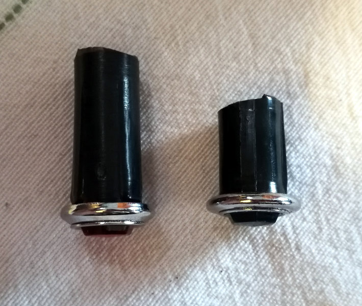

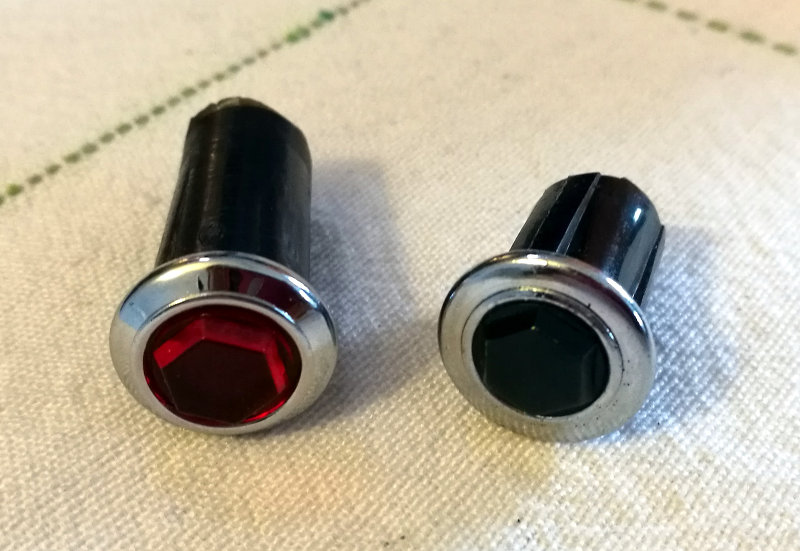

So despite Snowmageddon going on outside, our post arrived as normal. This meant that I finally received the new ignition warning light for the AC.
Unfortunately, on closer inspection it turned out that the bezel on the new lamp was slightly different.
New one on the left.
This would have proven hugely annoying to me, and probably would have meant replacing all of the existing warning lights so they matched. Luckily I was able to salvage enough of the housing from the original ignition light after I extracted the rotten lampholder with excessive amounts of brute force that the new lampholder would still sit snugly in place.
With the new lamp in place however, the ignition light sprang back to life for the first time in probably many years.
The other plus side of having salvaged the original lamp assembly is that I don't have one lens that's far less faded than the others - they all match nicely.

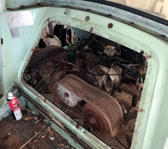

Right, so when we left things yesterday (and I was getting scolded for being out in the garage too late) we had achieved the following:
[] FINALLY managed to get the access cover off so I could get into the drive system properly. No more trying to reach through the wheel arch and shredding my wrists on rough fibreglass.
Sadly the cover surrounding the one screw did get slightly mangled, but it should be easy enough to sort - especially as it will be hidden behind the driver's seat when in use. I wound up having to actually hacksaw through the clip the screw was held into - the two had just utterly fused together.

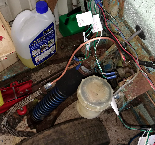

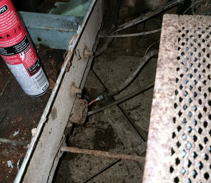

[] Front brake pipes all swapped out. Flexi is a NOS item as the original had collapsed internally apparently as I couldn't get any fluid through it.

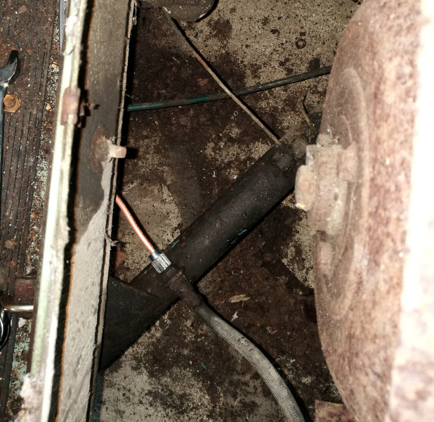

[] Nearside rear centre to axle rigid line replaced.
[] Likewise the offside...
Was somewhat relieved to discover that I did still remember how to use the pipe flaring tool given it's probably been more than a decade since I last used it.
I was originally of two minds about whether to change the rear flexis now or come back to that later. I've got two NOS ones to hand. The ones on there seem absolutely fine (no perishing, the rubber is still nicely flexible), but the ferrules are quite rusty. I've told myself to stop procrastinating and just get it done - so they'll be swapped today. While I'm at it, I may as well just change the last bit of metal line that goes to the wheel cylinders. It's totally covered in grease so has been well protected from the elements I reckon, but is hard to see to inspect in normal use, so I reckon I'll just get it done. Peace of mind and all that. Not as though making a couple of 4" long bits of pipe takes long.

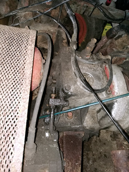

[] Got a proper look at the drive belt and ascertained that it definitely needs adjusting. Belt itself seems in fine order though. The bolts in question weren't too impressed with the idea of moving, so everything's been left soaking in Plusgas overnight.
So...This afternoon I shall attempt the following:
[] Replace both rear brake flexi hoses and the flexi to wheel cylinder rigid lines. Bleed brakes again (given the crud that was originally in there, I was planning to do this several times anyway). At this point *every* brake pipe will be either brand new or new old stock.
[] Adjust drive belt tension.
[] Try actually driving the thing around the driveway a bit!
[] Check if any wheel cylinders are either not working, leaking or sticking. If so, order replacements. I know at least one or two are working though.
[] If time permits, get the pressure washer and degreaser out again to clean up the transmission now that I can get at it.
Oh...and buy some more petrol as she's pretty much used the entirety of the original gallon I got now.
I'll let you know (hopefully this evening) how I get on. If I can figure out somewhere to stick the camera (I don't have a cameraman today) I may record some video of it moving around slightly less tentatively than last time.

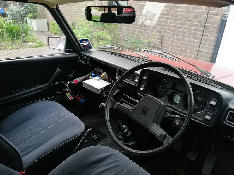

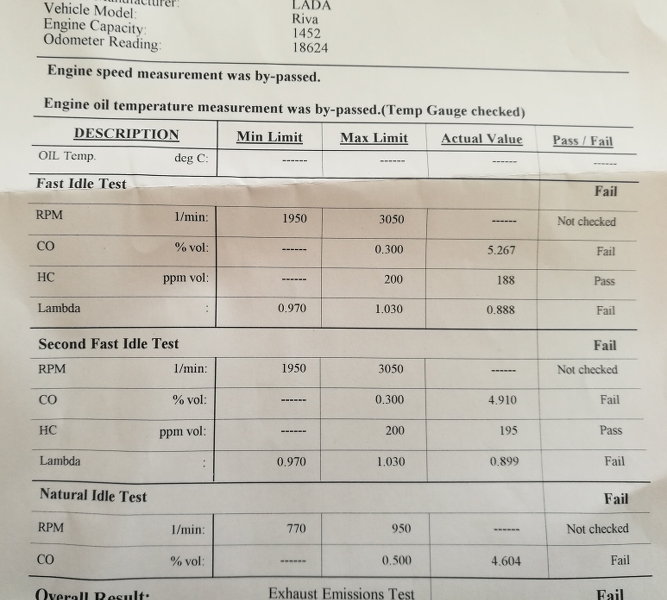

Today it was the turn of the Lada to get some attention. Time for an MOT.
Despite the car not having been on the road since October, she seemed happy enough (even if the brakes feel mildly terrifying after driving the Activa for several months!). Generally the test was pretty uneventful, even my cable-tied repair of the rear silencer hanger passed muster only earning an advisory.
What did cause a headache though was the emission test.
...Quite spectacularly.
First port of call was of course to check the coolant temperature sensor, which while slightly out wasn't massively far off the mark. The table in the manual does state very clearly that "all values are approximate" as well, so I think I can tick that off. I might order a new one anyhow if they're available as it can't hurt to have a spare and Lada spares are comically cheap for the most part.
Next up I think is to check to see what the lambda sensor voltages are doing, as disconnecting it didn't have anywhere near as notable an effect as I think it should...I want to see for certain that the system is running in closed loop mode...if not I'll need to hunt down why not, and cross my fingers that it's not a problem with the ECU that seems to be made of Unobtainium.
Given that there's no easy way to break into the signal path for the lambda sensor at the engine end, it will be measured at the ECU connector, so the cabin has been left looking like this for the night.
Fingers crossed tomorrow I'll get a bit deeper into it, and *hopefully* work out what the heck is going on. The thought that it's a throttle body from quite a high mileage car has crossed my mind, so I'd really like to check the fuel pressure to see if the regulator is doing its job properly and doesn't need adjustment (it is accessible), though I'm not going to start "twiddling" stuff like that unless I've a clear way of measuring it or I could well wind up chasing my own tail endlessly.

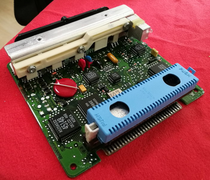

Okay, so we definitely have a problem with the ECU.
A bit of digging around revealed that Niva ECUs are indeed rather hard to come by these days. In fact I could only find one, and that was on German eBay, with an asking price north of £170...for a used one from a scrap vehicle. Now I'd have been happy to consider that sort of price for a brand new one that had been floating around for goodness knows how long in its protective packaging...but for a secondhand one that's no more of a known quantity than the one I have, just nope...If I'm going to have to spend that sort of money I'd be just as well picking up a Megasquirt or similar kit, even though that comes with the attendant hassle of having to get it properly set up, and probably having to do quite a bit of wiring.
So it was time to engage a bit of lateral thinking. I know that Lada bought the entire injection kit as an assembly from GM in the mid 90s. In the eyes of GM this would have been a pretty small order, so they weren't about to go and make up a custom ECU from scratch now were they? No, they'd use an off-the-shelf part simply configured to suit the vehicle. The actual ECU is probably identical to one used in a heap of GM (and probably other makers) vehicles from the mid to late 90s...the only differences being in the plug-in component which is variously referred to in bits of documentation as the "vehicle identity module," "engine calibrator" or "vehicle data unit."
...It's the blue thing plugged into the slot at the right hand end of the ECU board in the photo below.
The fact that this appears to contain the only non-volatile memory on the entire board seems to back up this theory.
A quick bit of Google searching turned up that the unit used in some versions of the Corsa B were also made by Delco, used ALDL comms, and had an identical case, and identical connectors. I'm pretty certain that other than the plug-in module with the vehicle configuration data and the label on the case that it's identical to the Lada one...Given that they're available for £20 including shipping, I've ordered one and will give it a shot.
If it works, brilliant! If not...well...I'll need to have a very serious think about where I'm going from here. It'll either be Megasquirt or pull the whole engine and stuff a pre-cat generation one in there...Before anyone suggests the Fiat TC transplant, I'd rather not go down that road. It's over-done I think, and totally changes the character of the vehicle. I actually quite like the character of the old Lada unit...and given it's only got 18K on the clock it seems daft to cast it aside. Not to mention that I've already invested quite a bit of time, effort and money in the injection work so far.
I did have a look at the potential of repairing the faulty ECU, but I think this is a non-starter. Virtually every bit of silicon on the board, whether it be a transistor or IC has a custom Delco part number on it, which makes it really hard to do any meaningful tests on anything without a known good unit to compare to.
Watch this space...Hopefully once I've got the new ECU here we'll be well on the way to a fresh MOT.
