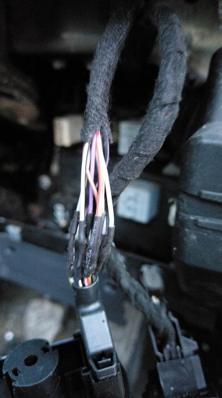

Today's no1 job was to demolish the pantry. So after putting a sledge hammer through it (very satisfying btw, I highly recommend demolishing walls to vent frustration) SWMBO went out to get something for dinner, i took the opportunity to whip out my soldering iron
headlamp switch fixed.jpg (168.29 KiB) Viewed 8130 times
The wire is about 1" shorter than it was before after trimming the nibbled ends back a bit and soldering it together. I had to fix 1 wire about a foot back up the wire but I can now turn the headlamps off with the battery connected :)
One earth wire fixed and now all the column switches work.
Now I know the drivers side rear cluster is still dead (not surprising), the passenger side front indicator doesn't work and it's not the bulb but it's definitely better than every light on and no way of turning them off :)
I removed all the crud from the foot well too, its still a mouldy mess in there but less of a mouldy mess than it was. VW appear to have used torx bolts but with twice as many points to bolt the seats in so i need to order a set of those then they can all go in a skip, the only one that may be saveable is the passenger front seat, the rest are nibbled to death. The airbag warning is being caused by the wiring to the drivers seat having been nibbled through so no side airbag and no pre-tensioner.
I'm hoping to get some time to work on it in the evenings but i have a week off at the end of the month while the building is re-wired so i should get at least a couple of days of that to spend working on cars assuming the other half doesn't want any more walls removed.

Dash is out, car is running :)
5 wires going to the engine on the right hand side behind the relay block were responsible for the non-starting issue.
Various other little repairs done but now the car runs and I have reconnected the OBDII socket, I can scan for codes:

There's your problem ;) one of everything. Codes cleared and the new list is a little bit shorter as various things are repaired / reconnected

The airbag warnings are because there are no airbags in the car at present, the a/c errors are because it's all disconnected as is the radio, no steering wheel, etc. the loom to the passenger door hasn't been repaired yet so that side is dead but the drivers side is all good :)
The errors that concern me are the sensor for oil level / temperature, the steering angle sensor, the engine codes and the brake switch as the brake lights were stuck on until I repaired a section of loom and now they don't work.
Still plenty to do. I've got to pull the remainder of the interior out to check the rest of the wiring inside then give it a good bleaching.
