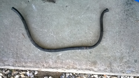

Upon returning home I found a slight weep of coolant down the nearside inner wing, cause being a bodge on a heater pipe from previous ownership
This was hidden under the horn / radiator so had gone undetected - quick trip to the motor factors to source a new heater hose and this was sorted. I adjusted the carbs again but noticed that the engine was quite clattery from the top end - so I checked the tappets the following morning when the engine was cold
