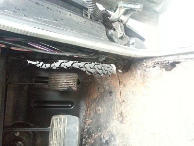

I started digging around the drivers footwell of the range rover which looked pretty solid.
Turns out most of the solid area was filler!
so to add to the. List I need to replace the outer edge of the footwell, the kick panel and the outside 2 of inches of the wheelarch.
Looking at it positively it is not the end of the world as it saves me having to unpick loads of welds, instead I will cut virtually the whole corner away and start again.

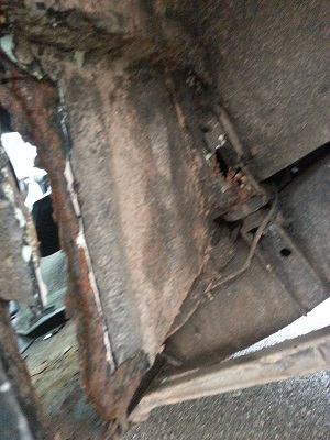

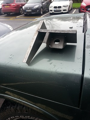

The body mount is strong but begining to go, it has already been patched and the seams are begining to swell, I have already made a new inner sill / body mount / floor support section so will all be cut out and replaced.

#400 Post by kstrutt1 »
here are some pictures
the rust in the drivers footwell.
The inner body mount (the green is the filler someone had used to hide the rust), this looks pretty easy to drill out from the inside and plug weld in a replacement.
and this is the new end of the inner sill / body mount and floor support, mostly made from 4mm steel, which is only tacked together at the moment but will be seam welded eventually.
plan is to repair as far as about 300mm up from the floor on both sides for now and fill in any issues higher up this will enable me to MOT it and use it for the winter, then next summer I can take a month or so and remove both wings, the bonnet and cowl and do the upper areas.
