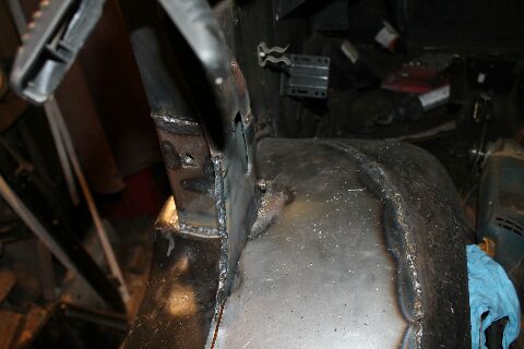

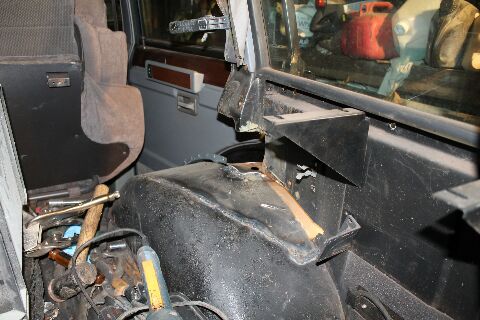

New metal was then welded into the arch and the outer arch fitted, once this was done the c pillar was cut back to sound metal.
So the bulk of it is now repaired, I just have the base of the c pillar and a couple of flanges to replace.

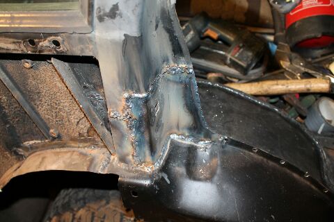

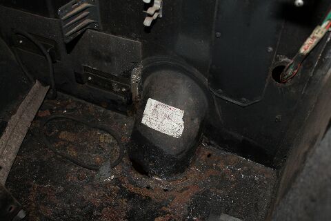

Another couple of hours on the range rover, c post and inner wing are all done.
A bit more of the post had rusted this side, I ended up replacing the area around the striker as well which involved making a new cage for the nut etc.
Just need to add the flange between the inner and outer arch then this area is done.
Then a small repair around the base of the fuel filler neck (the floor looks worse than it is).

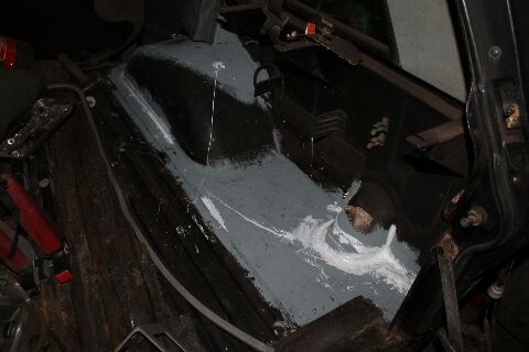

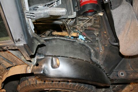

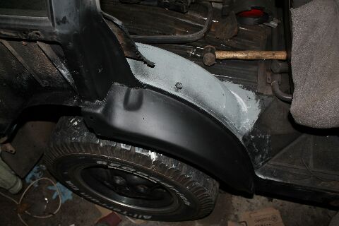

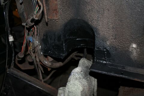

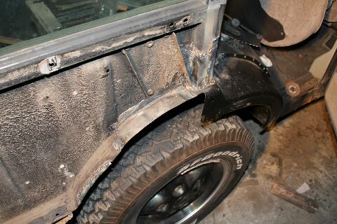

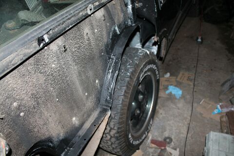

The rh rear corner of the rr is now more or less completed, just need to underseal the wheelarch over the weekend.
Welding completed primed and sealed, with wheelarch and area behind wing painted in black stone chip.
Behind the wing
Around the fuel filler
In the door shut
Inside, complete with dribble of sealer!
Just need to paint the interior and put the trim back together then I can get onto replacing the outer sills in a couple of weeks time, I have cut the metal out allready so it just needs forming, then chop up so e 4mm for the front body mount weld it all together.
