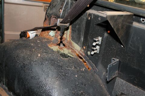

Spent a couple of hours on the range rover this afternoon, as it has to have the lpg inpected I decided to start sorting out the clipping of the fill pipe.
The fill pipe had been clipped along the lower edge of the rear wheelarch, this had led to mud being trapped around it and now the lower 2" of the inner arch where it joins the floor needs replacing as well as the clips which had also rusted away, this alll led to me cleaning the underseal off the rest of the arch, the area around the seat belt and c pillar has rusted much the same as the other side and will be done soon, but the rear of the sill was much worse with the body mount being almost non existent, the inner and outer sill were fine again though.
So in the end to gain access I cut the end 9" of the outer sill and 6" of the inner away then made a new inner from 4mm steel with the body mount fabricated out of the same and all butt welded together, this is now welded in and I just need to fold up a new outer sill and cut out the closing pieces to go in the arch, this will probably monday evening as I am collecting 2 new rear doors tomorrow.

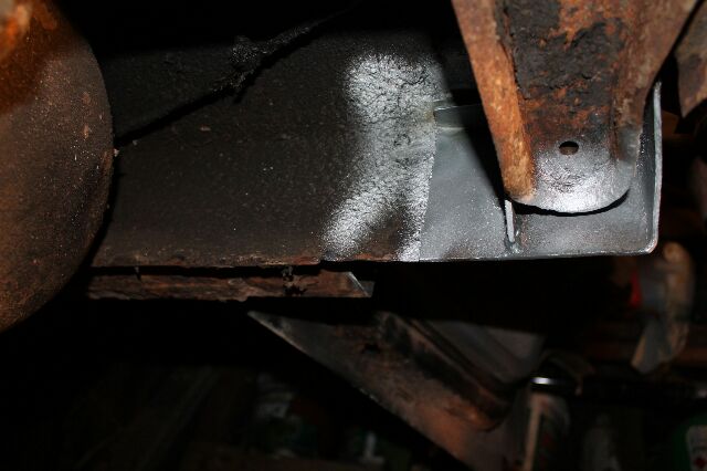

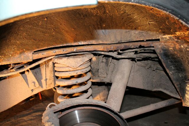

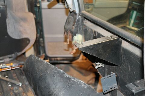

Some pictures of where I got to yesterday :
fistly the new body mount from the centre of the vehicle?
And from the rear of the vehicle.
Finally the base of the carch where the lpg pipe was, you can see it where I now plan to route it over spring seat and clipped to the boot floor x members with p clips.
Hopefully should get the new metal welded in tomorrow evening.
