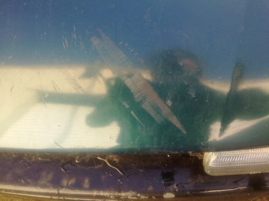

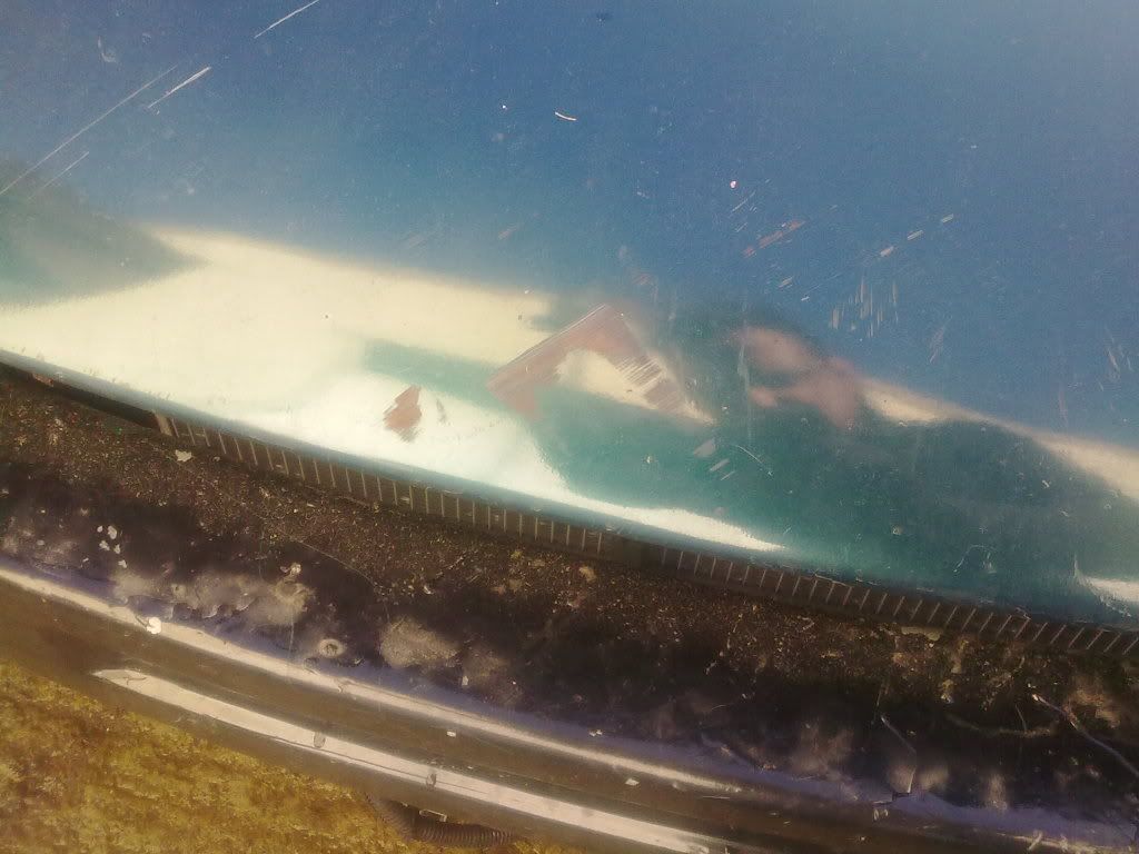

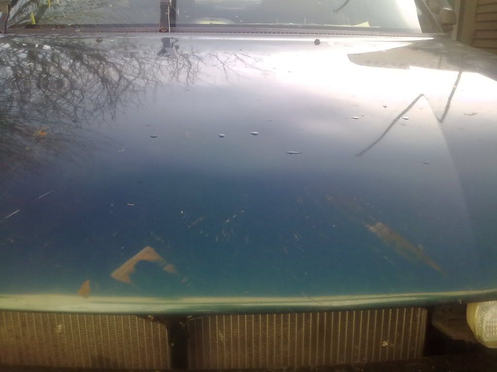

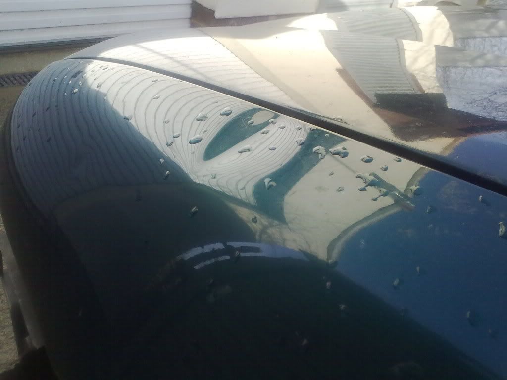

Well today we had a few hours of lovely clear and bright sunny weather.
My father had said spe wood had fallen on the carat the weekend, and
that the scratches will buff out!
He doesn't do cars and what he knows about cars or paint jobs you could
write on the back of a postcard!
So good weather to take a couple of photographs as I inspect the damage!
Then there are the dents on the wing as the wood fell like a karate chop!
Looks like it's respray for the bonnet and maybe a replacement wing.
I had stated earlier that bodywork and interior will be dealt with in the
summer when the weather is warmer for the paint to dry better!
Even more money to fork out for!

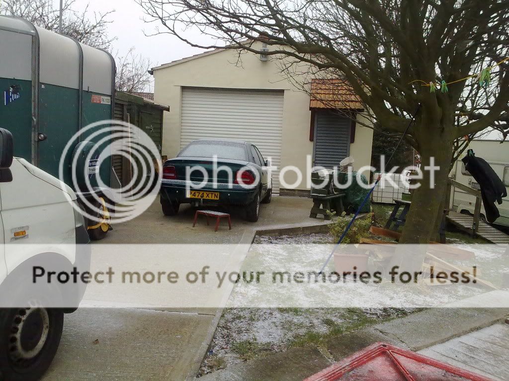

Well I took this photo at about 2:30pm local time, and the
snow is just starting to come down.
The temperature is -1 degrees C.
I will not be doing anything on the car in this weather!!!!

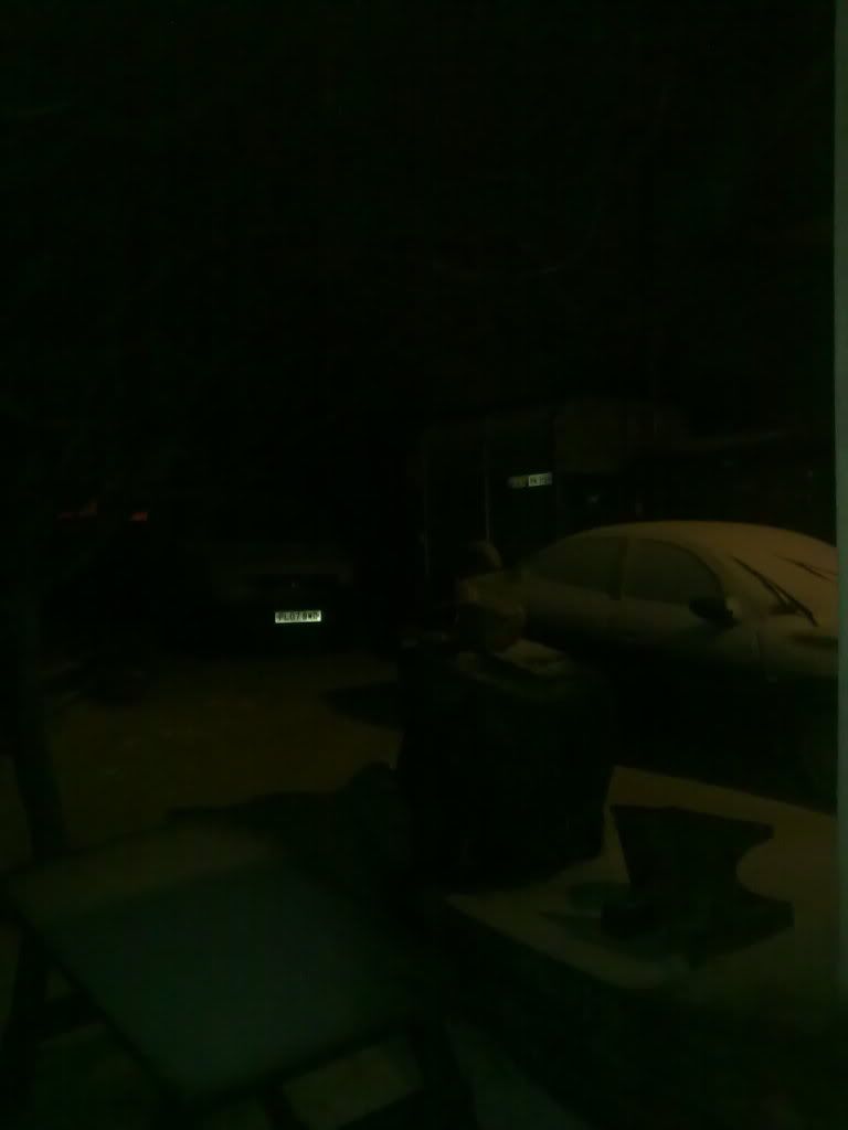

Just checked the temperature gauge it's now 1 degrees C,
and the snow stopped a couple of hours ago.
Could the sensor be bust?

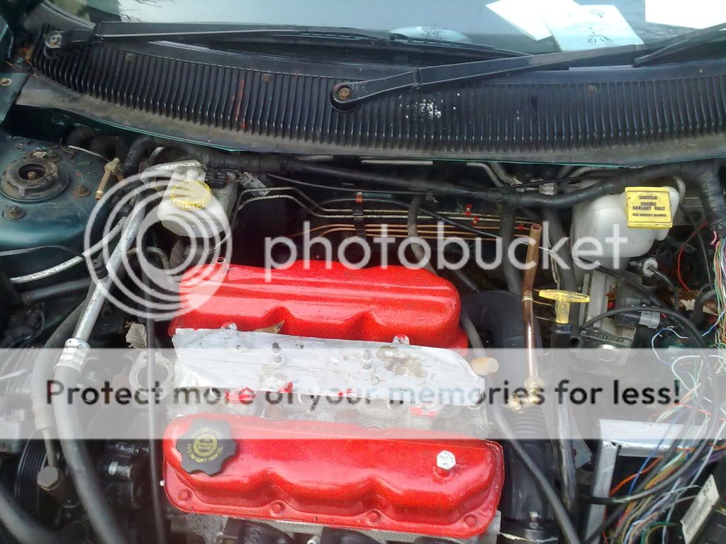

It looks like I slipped up!!
I hadn't realised that on the 3rd of February it had been
precisely a year since both me and my mother went and
collected the engine, transmission and drive shafts!!!
From this jumbled mess
To this (a few months old this picture but you get the point)
I will finish this soon
(Well as soon as the weather hand health allows)
As I do not want this to carry on for another 6 months,
let alone another year!!! :sorry:

As the temprature was on the warm side for a change.
I spent a few min under the car removing the lower radiator
hose and marking up for further alterations to the radiator.
As I have seen on Mishimoto and other Neon race radiators,
they state they are only 2 cores and under 1.5" thick.
However the radiator I am which is over 2.5" and ment for a
different car, I don't mind having it altered to suit the engine
swap.
I would rather have a larger cooling capacity radiator than
needed radiator, than find out that an expensive race radiator
for neons wasn't big enough and have forked out way too
much money for one(also if from the official mishimoto dealer
in the Uk I would be waiting till july or far later in the year!!)
