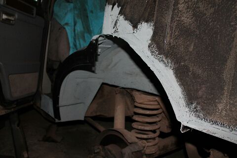

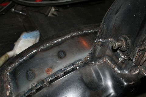

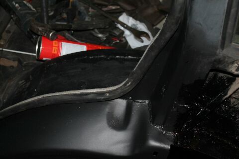

Firstly tacked in a large area of new metal to the inner arch.
It was then seam welded and new metal folded up to replace the lower c pillar.

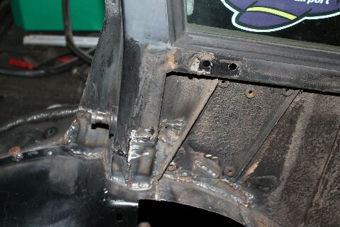

Finaly the finished article.
The welds now need grinding down and then painting and sealing can begin, a job for a couple of evenings this week, hopefully it should all be back together by next weekend, then I will have to think about doing it all again on the other side!

From the factory it should have a clear-ish (yellow by now) cavity wax inside all the box sections. Yours seems to have worked rather better than mine has. You work MUCH faster too. One C post repair like yours took me 2 days!

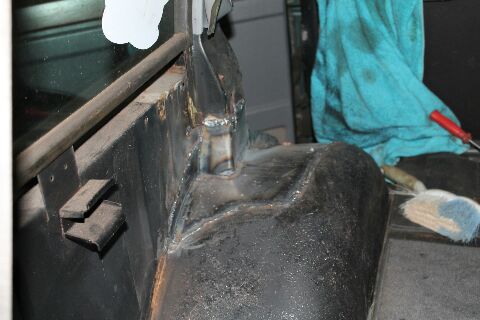

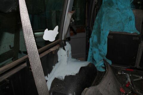

Further progress on the range rover, all the repaired areas and the wheelarch have been stripped back the welds in the visible area ground back and treated with rust converter then painted with cold galvanising paint.
Next up is seam sealer then paint followed by schultz in the wheelarch.
I also had to rivet a new piece of alloy into the wing as the flange it bolts to the wheelarch had corroded where it touched the steel, it will be re fitted with a membrane between the two.

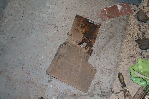

I also need to make something to replace this, amazingly it unbolted! I have some old truck mudflaps somewhere so I may replaced the whole thing with rubber.

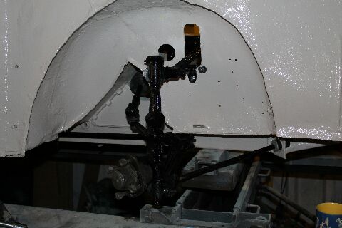

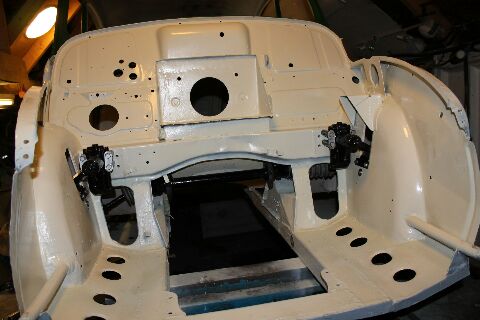

In betweem painting the Rangie I have also started puttting some of the suspension back on the minor. The trouble is I seem to be missing a few small seals and nuts which will slow progress.

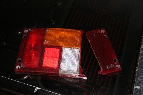

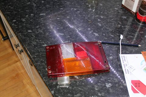

Finaly I have also been repairing the broken rear light filling tge gap with epoxy, plan is to flat it back smooth when it is really hard and paintIng the inside red, not perfect but certainly functional.
Tonight it will go in the dishwasher to clean it up!

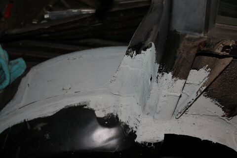

Applied the seam sealer and a skim of filler to the visible part of the C post this morning, Should be able to get some paint on it tonight.
Dishwasher did a superb job on the rear light lenses as well!

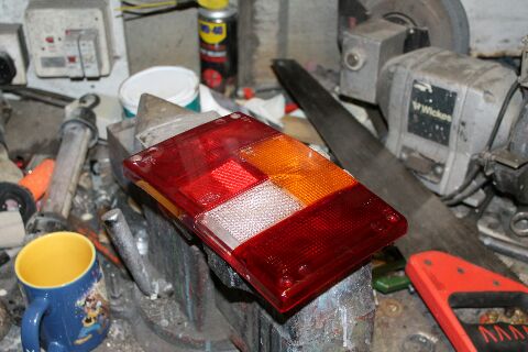

Door shuts now painted in the original satin black, aerosol stone chip seems a good match. The other areas were painted with teamac agricultural enamel. Just need to schultz the wheelarch once some of the fittings are back in place.
Also finished the rear lamp lens repair, araldite to repair the holes, red ink to add the colour then sealed with laquer, not perfect but new ones seem to cost around £60 so it will be fine for me!

I have also been making progress on the minor, the rh front suspension is now fitted, just need to tighten all the bolts and add the split pins when it has some weight on it.

On the minor after several attempts at getting it right the minor suspension is all together on the lh side, firsrt time I managed to get the top trunion one turn too far on so the steering would not turn, then I put the ride height plate on the wrong side of the crossmember and missed a washer out of the rear of the torsion bar, the biggest problem was pre loading the torsion bar, the body is so light it just lifts up, in the end I had to strap it down to the ramp.
