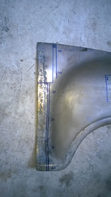

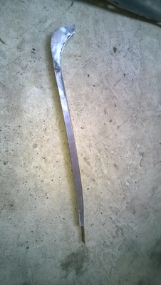

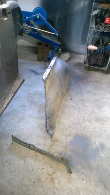

The underside being no better - I made up the rear support edge with the help of the shrinker
And then cut the dead section from the wing

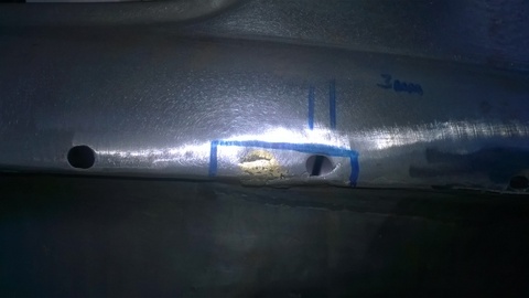

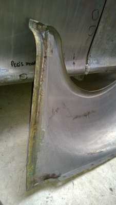

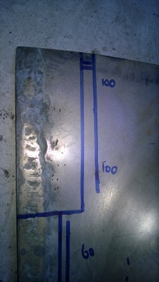

The flange edge that meets the inner wing had also suffered in several areas
Difficult to see in the image but just above the marked cut line is the stamped number 2077 - this is Jowett factory body number for each panel and all the panels for the car have this unique number stamped on them
So that's the flange edge sorted I can now bolt the wing in place and work to the door gapping - due to compound curvature of the wing the repairs shall have to be under taken in several sections

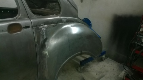

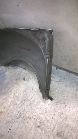

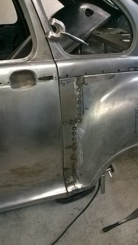

Not abandoned nor forgotten but the day job simply got in the way of everything for the vast majority of this year - now back on my home patch work can recommence on the car - start date yesterday ;) Main mission currently is to complete all the welding to the outer panels - last panel to complete on the nearside is the rear wing which just happens to be the most difficult panel to repair due to the complex compound curves
Sections carefully let in and tacked
The panel has to removed and refitted several times

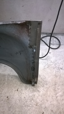

Fastening brackets spot welded to side rail of the wing which now allows for the wing to be held in shape whilst the the sections are fully welded
Welds dressed back - just some final shaping with the hammer & dolly required

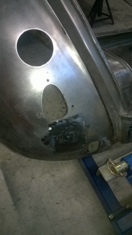

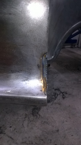

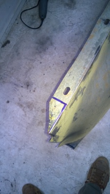

Underside of panel cleaned back
New wing mounting brackets fabricated and welded to the inner rear wing
Another couple of hours work and the car will be one panel closer to getting painted

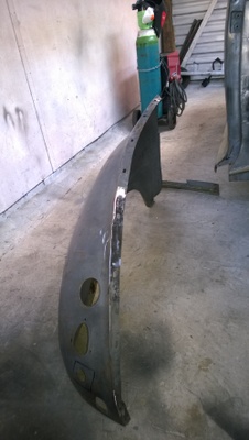

The Practical Classics Restoration Show is looming and the car will be on the club stand so time to crack on - with the rear wing back off there was a poor previous repair made up in brass that required sorting on the rear shroud
Cut out
Fresh metal let in & cleaned up

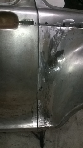

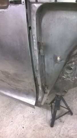

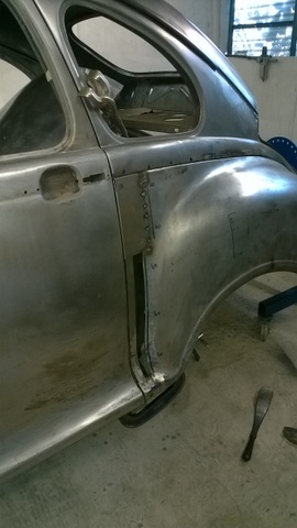

With the wing reattached next task was the gapping between the door and wing - looks ok in the image but believe me it's dreadful in the cold light of day - correction to the door alignment includes building out with weld on the edge of the door skin then cleaning back to achieve the correct profile
Panel gapping on Javelin was not particularly good when they were new - still it's not an excuse to get it looking right at this stage - after quite a few hours of fettling I was at a point where I was happy with the results

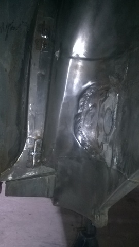

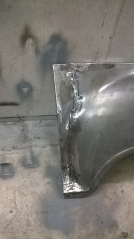

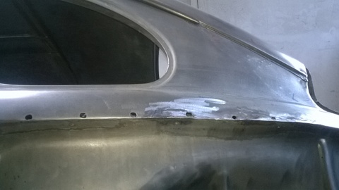

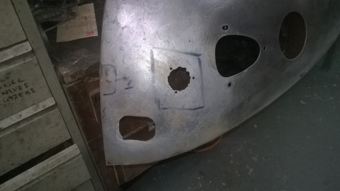

Further repairs to the wing included the closure of this non original rear lamp aperture
Several areas reshaped plus a couple of splits in the metal on the edge flanges around the wheelarch and lower edges of the panel

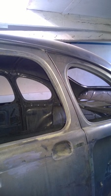

Now starting to get somewhere with the panel fit

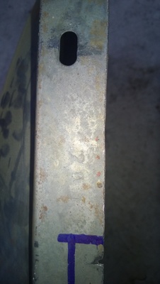

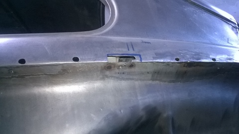

There is a piping bead that goes between the rear wing and the shroud once the car is painted
Inner wing / D Post brackets to outer wing
