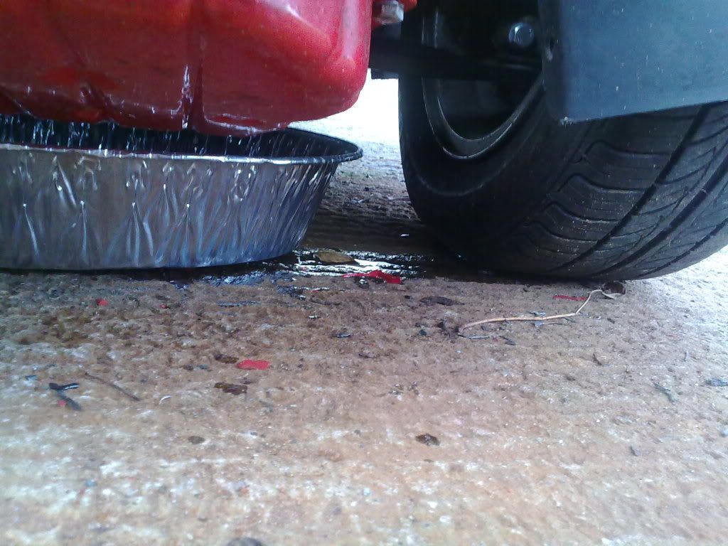

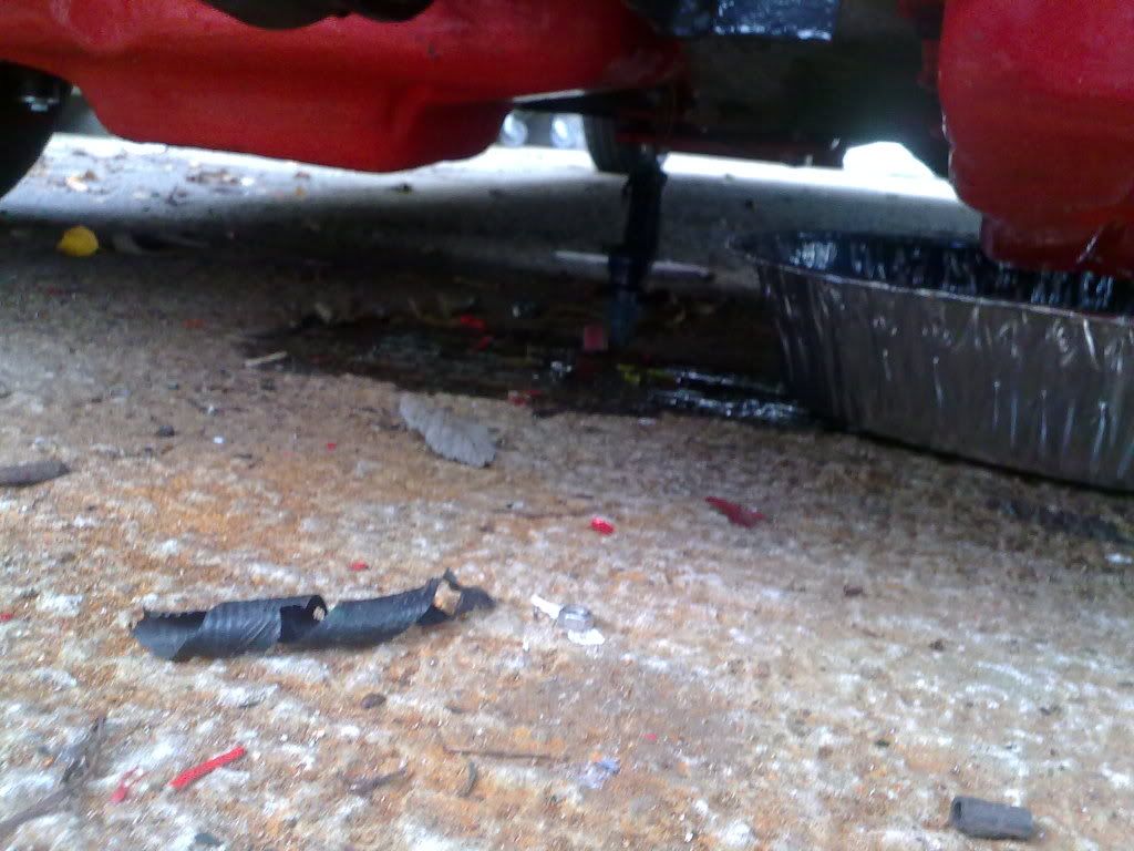

Christine had peed on the drive, my first thought was great it
will be that bloody transmission again!!
I jacked the car up, took the wheels off, and put them under the
floor pan with 4" x 4" posts on top for the car to rest on.
The front got the axle stands, I wasn't wanting a car on my head.
It wasn't the transmission, it was the drain plug on the engine's
oil pan. The drain plug was new and supplied by the Chrysler
dealership, and didn't fit right!
Luckily only about half a cup of oil went on the drive, but dad was
angered by it! When was the last time he looked under his
discovery? as it is dripping oil from all over!!!
I drained the oil refitted the original oil rain plug, and poured the
oil back into the engine. As I was pouring the oil back in, I did
notice that there were dark streaks in it off the old oil.
After the car has been running a couple of months I will give her
another oil and filter change.

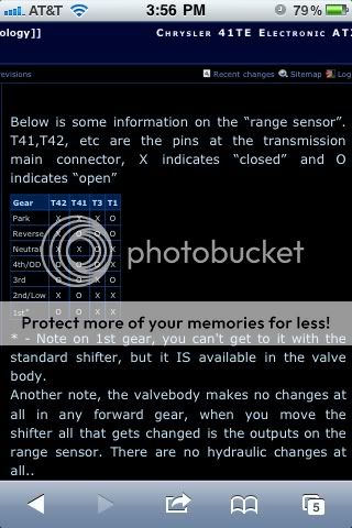

#328 Post by Mitsuru »
guhfluh of neons.org wrote:Image
This excerpt from the wiki is a direct copy from what is in my Chrysler
training manual.
I would simply try it as you had planned. Shift the range sensor into 1st
without the shifter cable connected and see how the controller reacts.
It will not harm or break anything. At most it could throw a code, then
simply reset it. If by chance it does work for you, then you can start
figuring a way to get the shifter to work. I believe I have seen
aftermarket shifters which allow that position with the correct gate.
Also, L/2nd would probably work perfectly fine for you, as I believe it
starts in 1st gear from a stop and only upshifts at engine redline.
And thank to guhfluh, as the manual only said to fully turn it clock wise
for valve body removal this may have been miss interperated by some
as just for removal and not that it could be 1st gear.
I will be trying the manual shift before sending the car to have it's MOT.
If it does happen to work perfectly, then there is no question about it,
I MUST be able to get to use it. As it will be safer for going down banks.
That is hopefully a task for next year and will be part of this thread as it
will be utilizing the full operation functions of the 41te transmission.
So there will still be things to do and enjoy me cocking things up!!
(or blow up :lol: )

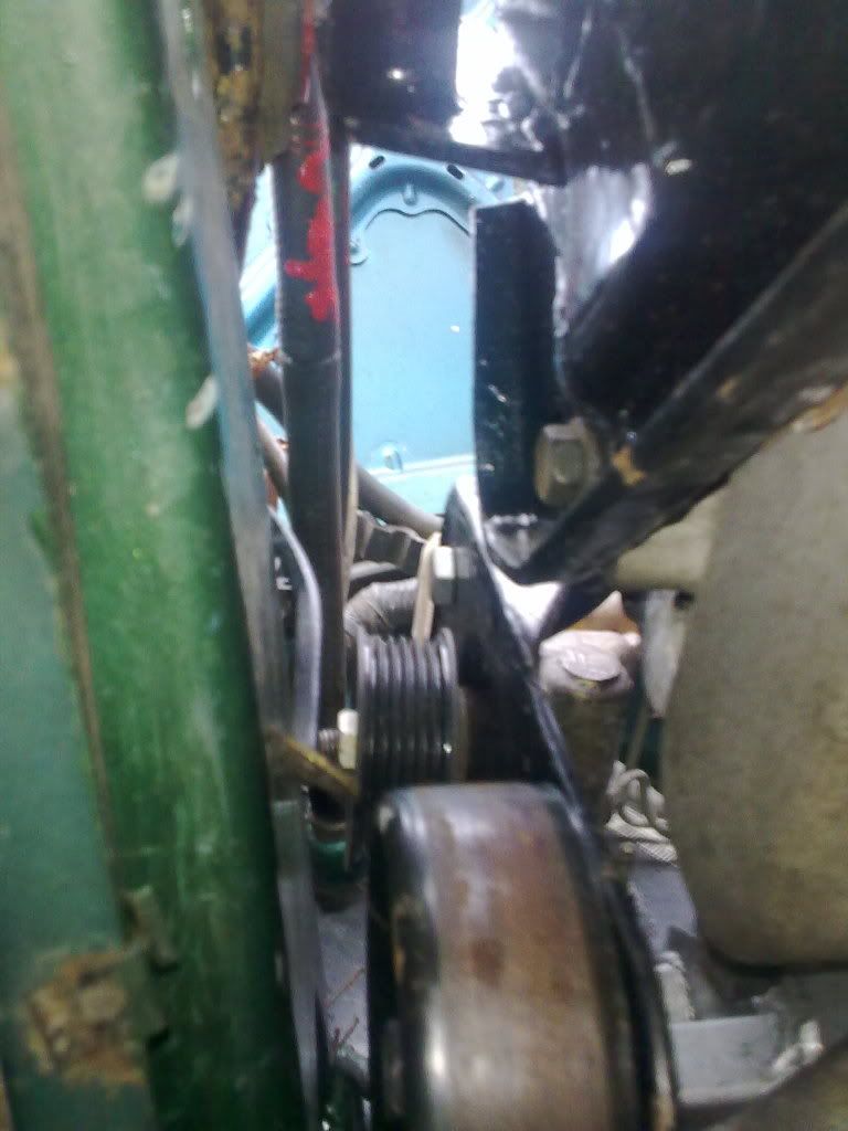

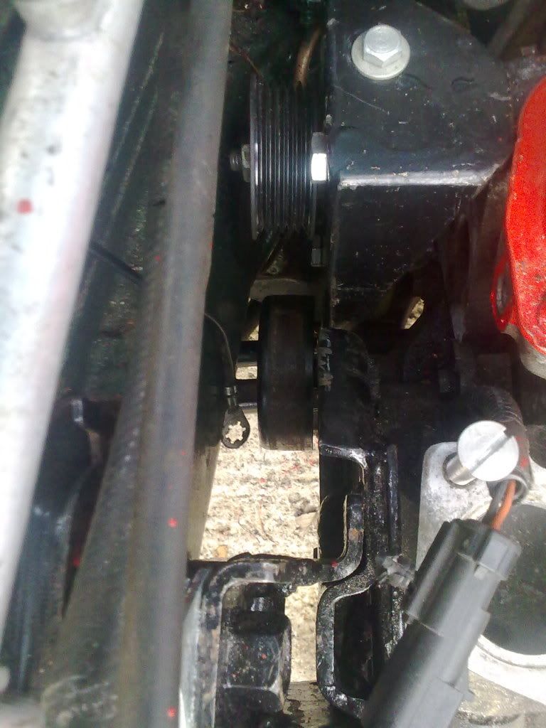

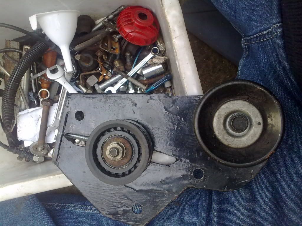

Before starting on the tensioner bracket I had to replace
a nut and bolt for the right side of the subframe.
The bolt was ratelling and rotten.
The Bracket was bolted together before being dismantling
before being fitted onto the car. As I needed to make sure
that all nuts, bolts, washers, spacers, etc were there.
I will need to get a longer bolt for pullund the pulley up!
As I think that I am missing out on alot of the bracket use.
Tomorrow the Crank Shaft Pulley goes on!
