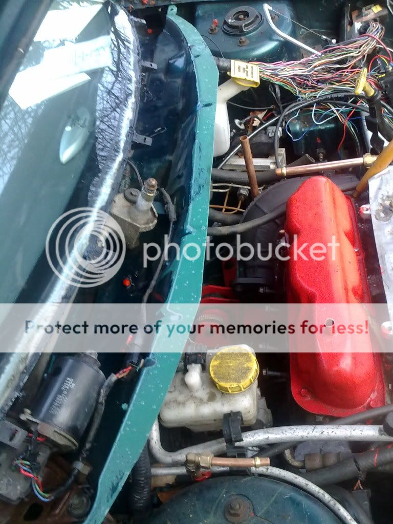

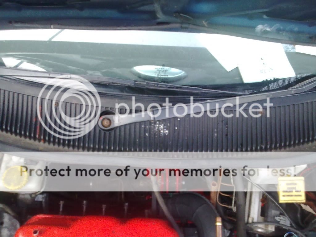

I had painted the lip at the back(the bit I just trimmed) yesterday,
but with the thick fog, it went pale green as it hadn't cured enough.
The cover went back on and so did the wiper arms, after I removed
excess sealant.
Then finally the weather strip.
Then dropped the bonnet
No problems, I then connected up a battery to the fuse board to get
the wiper motor going and adjust the arms before I forgot.
The battery tray was removed, ready for me to deal with the gear
selector tomorrow if it's dry enough.
As an after thought I removed the old hoses which went from the
transmission to a cooling radiator, and fitted 2 new hoses to connect
up later.

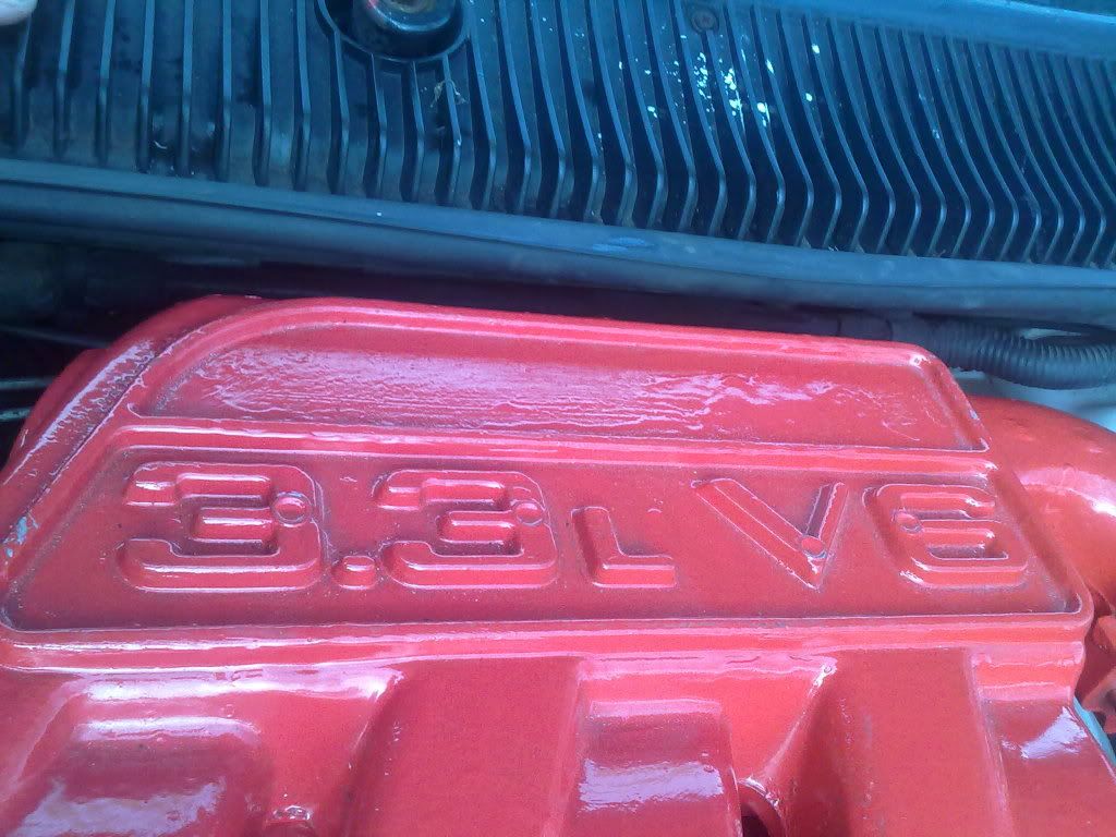

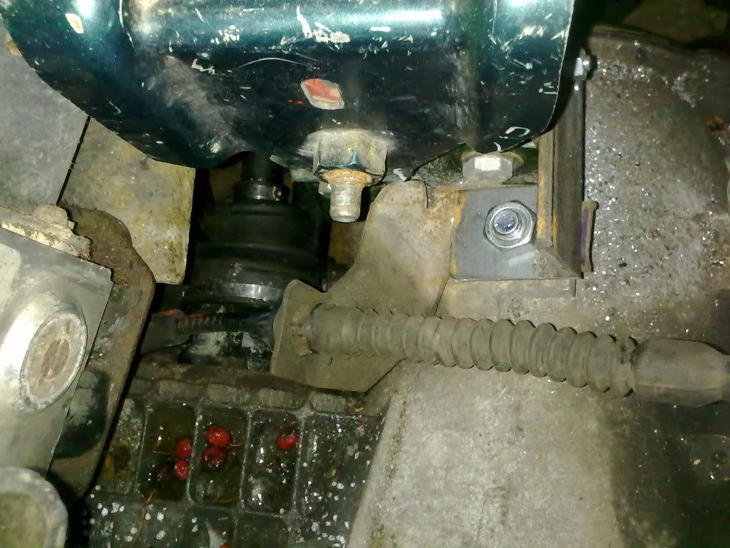

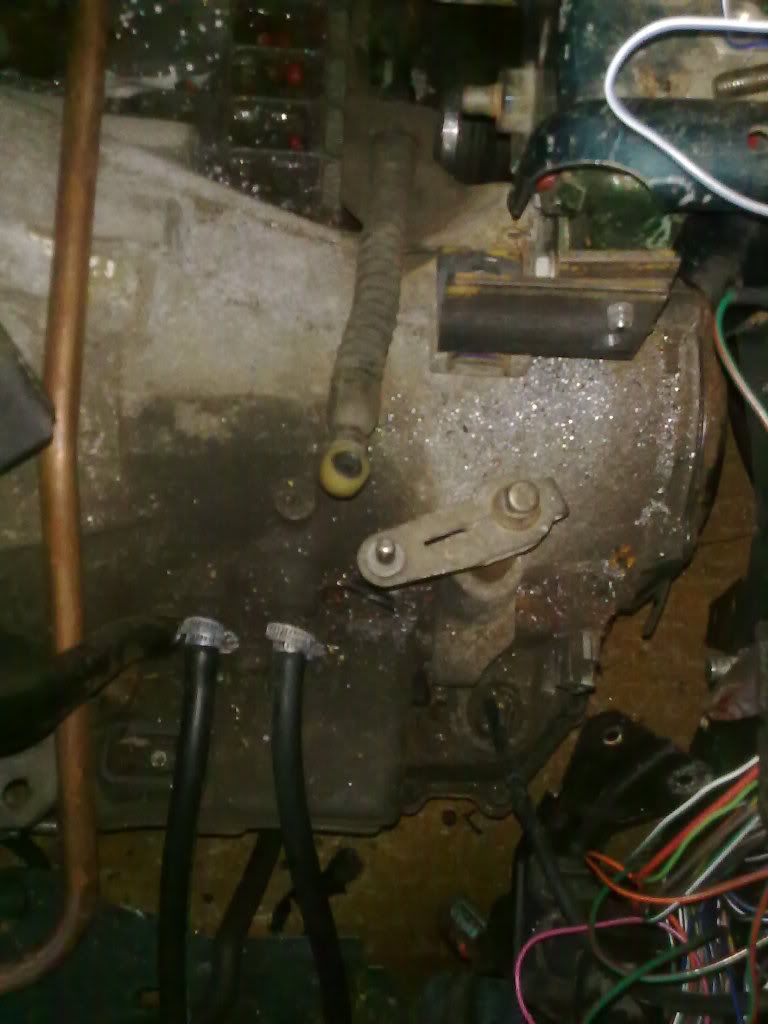

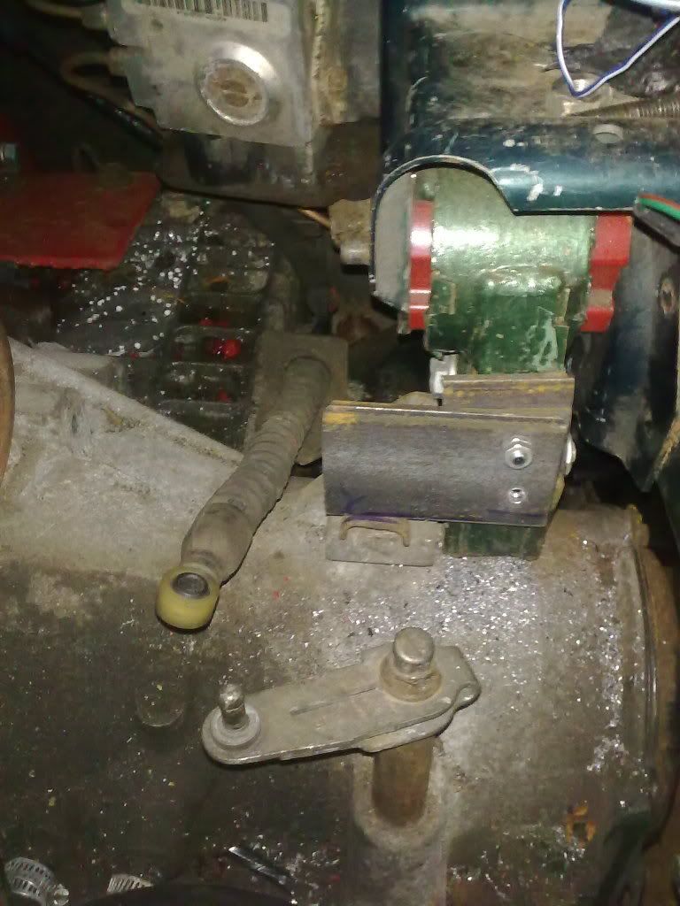

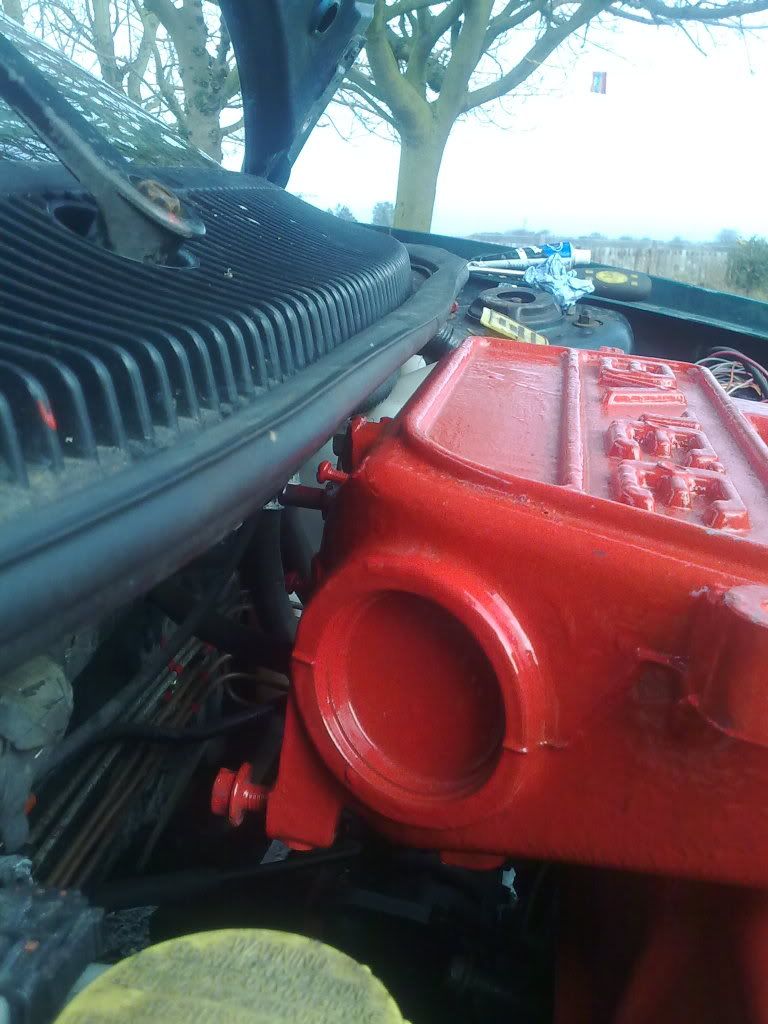

First task of the day pop the intake manifold back on for a
check against the clearance again with the weather strip.
The bracket used for holding the gear selector cable off the
Neon's three speed transmission is being used, this is due
to the fact it is made out of sheet metal so easy to adapt.
Where as the bracket that came with transmission was cast
alloy and damaged.
I cut a bit of angle iron an bolted it to the front not the side
of the transmission mount. This is so spacer plates or
washers can be used for fine tuning the selector bracket.

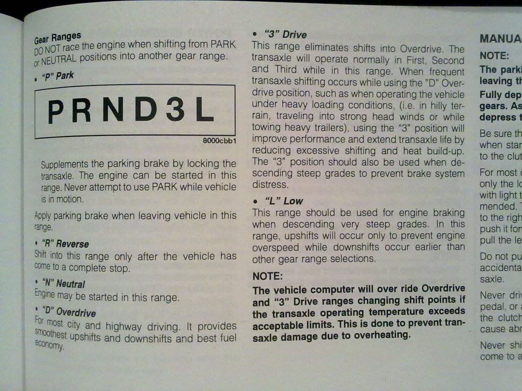

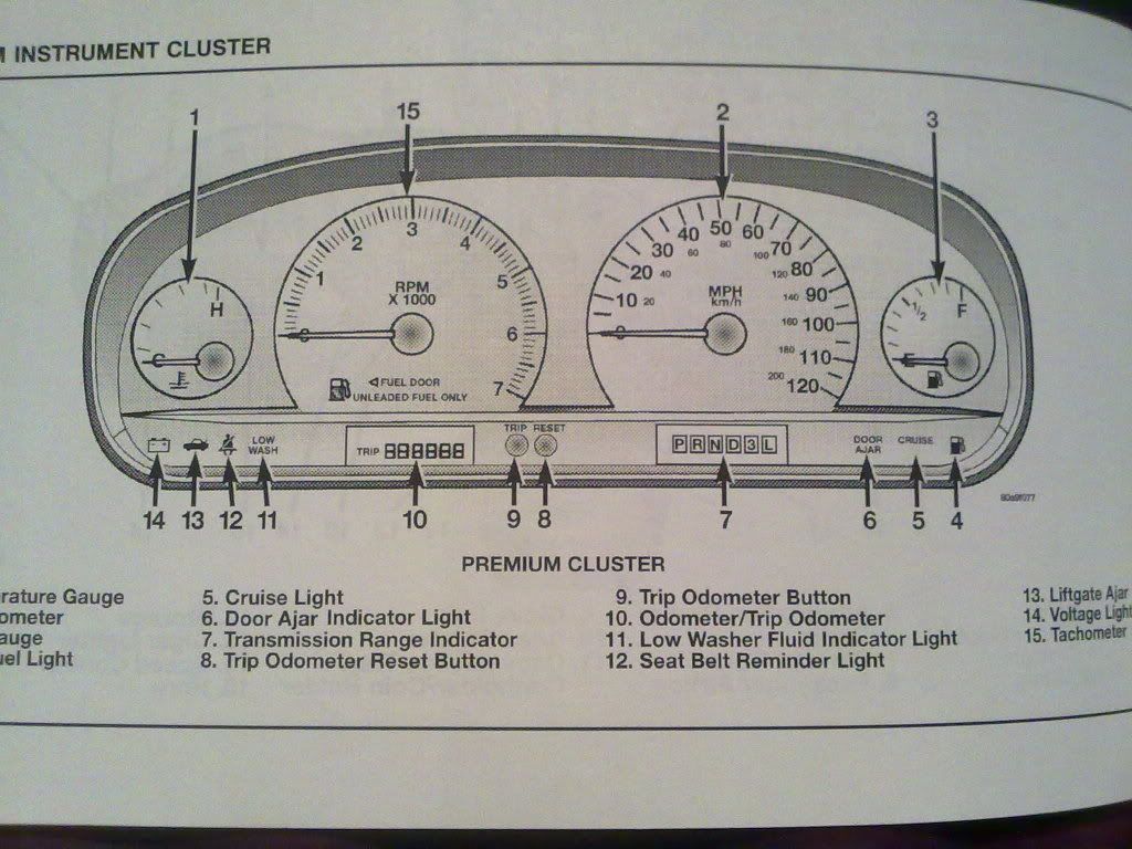

OKAY I HAVE SCREWED UP SOMEWHERE !!!!!!!
The gear selector on the mk1 neon has 6 positions, where as
there are 7 positions on the transmission.
And yet the operators manual which I got from the Voyager
states the below with the neons:
The Neon..........P, R, N, D, 2, 1.
The Voyager......P, R, N, D, 3, L.
Anybody know why I have seven positions on the transmission
and why the handbook/operators manual says six?

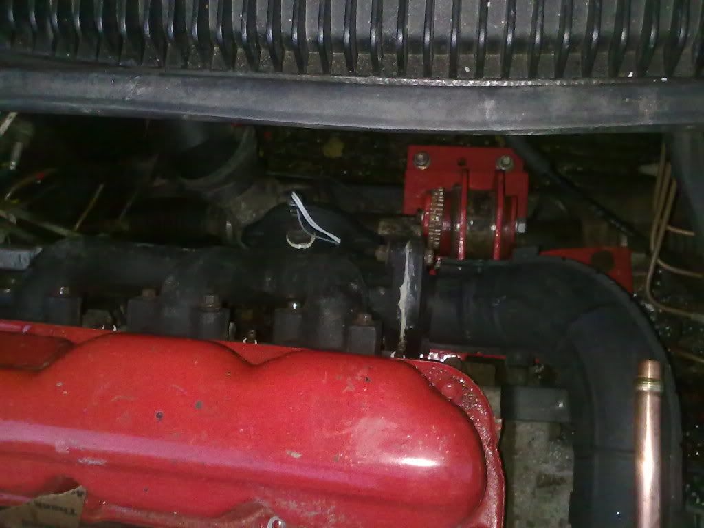

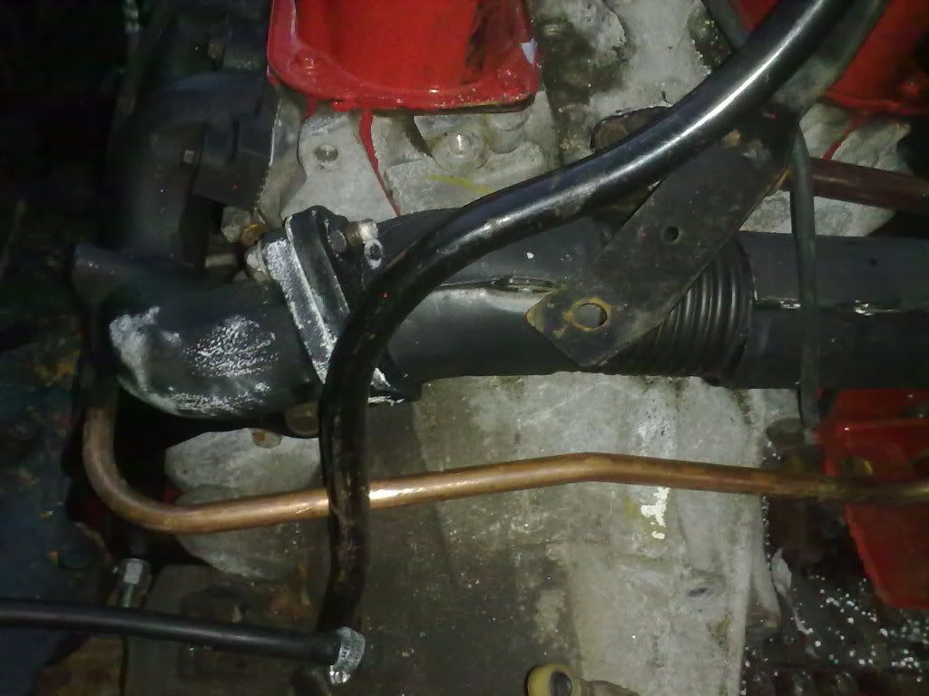

Now for pipes!
Dad's handy work on the bending of the copper 15mm copper
pipe for the run from the water pump to the heater matrix.
For that pipe I need to cur and solder some strips of copper to
the pipe for bolting it in place.

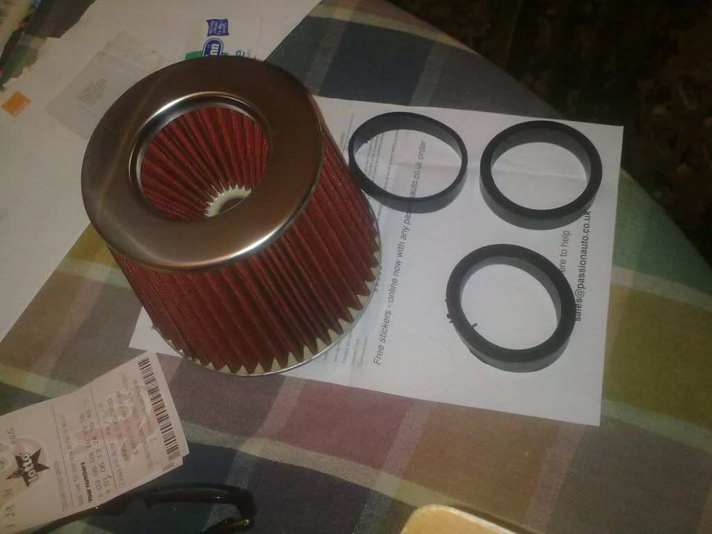

And the air filter arrived at 5pm which was a little late for
the last post!

A little research shows the early Voyagers were available with either a 3 speed or a 4 speed auto box. I didn't take this any further, not knowing the year of the engine/box you are using. I suggest you try Wiki (like I did) and see the types used and compare to yours.
The transmission is the 41TE made in 1998 and is the 4speed electronically controlled.
Here is a couple of photos of the operators handbook
showing the gear selector positions.
Which would be 6 positions not 7.
As I understand it, this is a 4-speed device, so the seventh position would be to allow manual changes from 3rd to 2nd. A quick glance at a colleague's PT Cruiser shows that 1st isn't on its quadrant either, so if there are seven indents on yours, use the matching quadrant & job done.

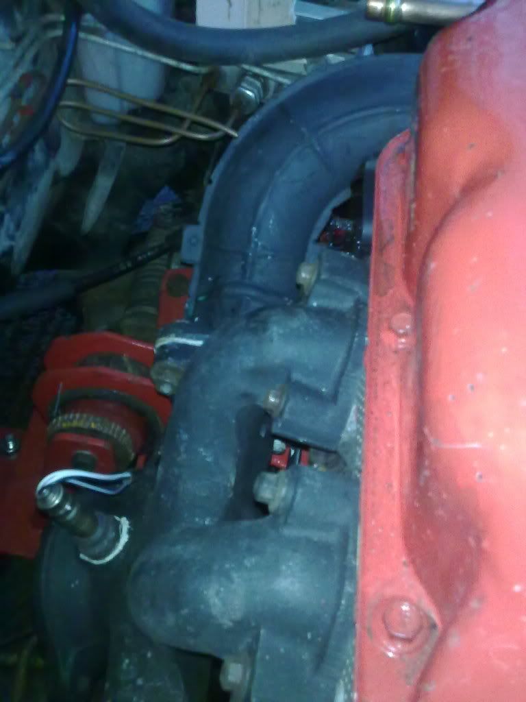

Today the rear exhaust manifold went on, all but one nut,
and bolt. That nut and bolt is under the manifold an not
accessible from above.
(not when my hand was painful with arthritis)

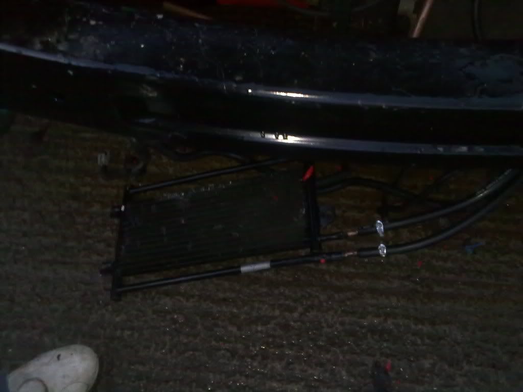

Before they arrived I had trimmed the pipe from the transmission,
and connected up the oil cooler radiator. Yes I finally found a
split pin that fit the drain plug on it.

As the above picture shows I have the Oil radiator through the
grill and with the pipe ends up over and the other end on the
floor. This is so that the air can escape when the fluid is pumped
through the system.

Dean listened to me and I showed him the details and even he is
wondering why the transmission selector on the Voyager only uses 6
positions when there are 7 positions available.

Then use all seven. PT Cruisers have the suitable layout printed on the quadrant and it's only a sheet of cellophane or similar to change over.
Sorry jpb I missed your original pt cruisers post.
for driving in snow and ice. I'm wondering if the 7th position isn't in fact
1st gear, and L is 2nd gear!

As in the hand book it says if put in position '3' the transmission will select
1st, 2nd and 3rd gears.
If the gear selectors for both the 3 and 4 speed transmission selectors were
made the same they must have changed the lettering and not bothered
about being able to select 1st manually.
Why do you think they did that then and made it so they could have a clip so
that on the 3 speed selector go that far?

As the three speed transmission you could select the gears individuallyjimbo in MI wrote:Every 4 speed ever has had the same number of positions as the 3 speed.
They did this so it was compatible with either shifter on vehicles that got
a choice of 3 or 4 speed on the assembly line. I am not sure what you are
feeling.

Mk1 Neon P, R, N, D, 2, 1
Voyager ...P, R, N, D, 3, L
The idea....P, R, N, D, 3, 2, 1
