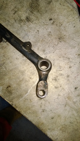

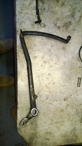

Next to sort is the wear in the yoke of the brake pedal lever

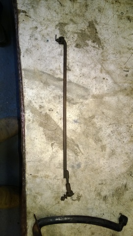

Whilst bodges from pervious owners call for a remake of this gearbox selector rod

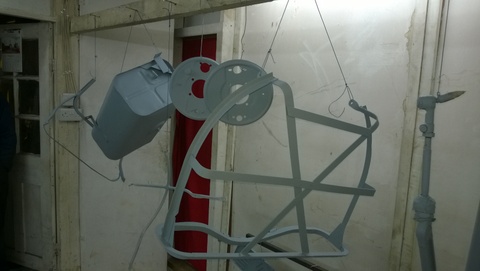

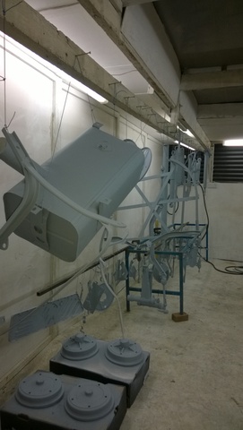

Progress has been a little slow with my day job holding things up but Keith has been very busy behind the scenes prepping all the running gear / mechanical / brackets etc - so with everything shot blasted and in transit primer I spent the day keying the parts up with a scotchbrite pad / masking up as required / wipe over with panel wipe and hanging everything up ready for paint

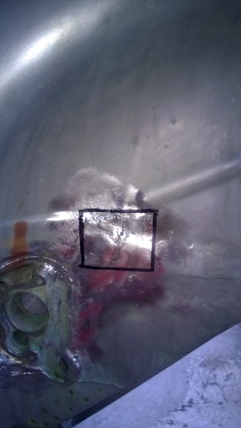

I wanted to tidy the petrol tank up a bit this had a couple of cosmetic dents on the underside that I skimmed out
Once rubbed back we were ready for primer - all 150 items that is :o

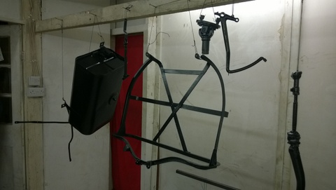

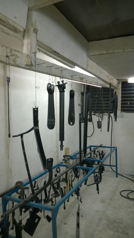

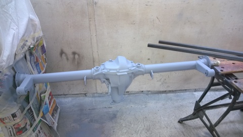

So with Keith assisting by passing the parts individually - I then sprayed them up and passed them back to him to rehang and leave to dry
Fortunately we have a large industrial extractor fan fitted in the corner of the workshop so that keeps the spray dust down
3 litres of zinc phosphate primer later and we have a result - all ready for the satin black top coats which I hope to get done sometime this week - all being well.

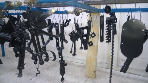

Spent several hours late afternoon / evening applying 4 litres of satin finish chassis black to this lot
Keith once again acting as my assistant - passing the prepared parts once they had a light keying with a scotchbrite pad and quick wipe over with panel wipe - and once sprayed carefully rehanging them to dry
So that's 98% of the running gear / drive train / body & trim brackets in paint - Keith can now start to reassemble the running gear into sub assemblies whilst I crack on with the final odds of welding to the bodyshell along with the second panel fit up .

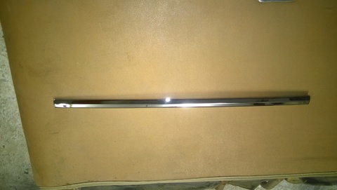

The hinge plates for the doors are on captive nuts so I spent some time running a tap through them to ensure that the treads were clean & sound - then a load of time with the bench grinder wire wheel cleaning the threads / heads up of the countersunk machine screws that fasten the hinge plates to the doors (then I wonder where the day goes and how little I have achieved in a full day) The chrome is done and Keith has been and collected it - all 110 pieces - here is one of the door trims - I am pleased with the quality - much like paint work you can see a decent job from sight alone

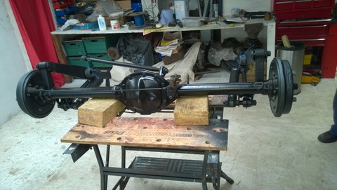

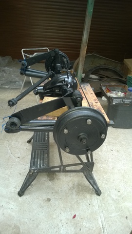

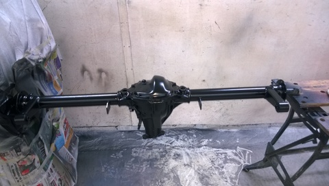

Keith had kept himself busy in the week with the fit up of the rear axle - after shimming the end float to factory tolerance the brakes / linkages & suspension arms were attached and the unit can be set a side ready for refiting when the shell is painted
Complete with new wheel studs & nuts

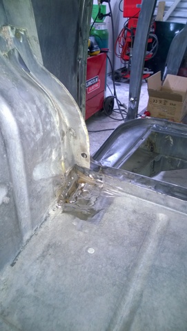

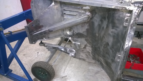

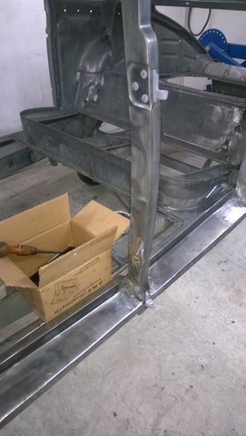

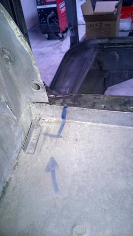

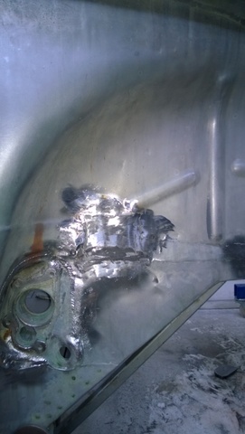

Meanwhile a couple more of the areas that showed up as weak from the dipping process were sorted
Awkward corner in the boot floor immediately above the rear shock absorber mounting
Along with the vertical face on the rear inner wing adjacent to it
After some careful dissection and letting in of fresh metal the areas were sound again

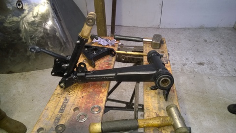

Here is the front suspension / stub axle sub assemblies going together

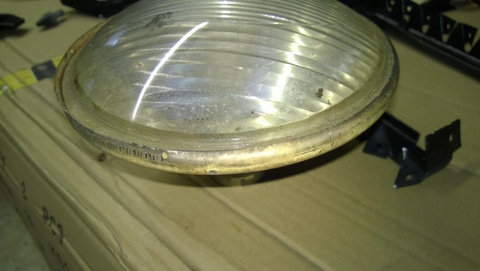

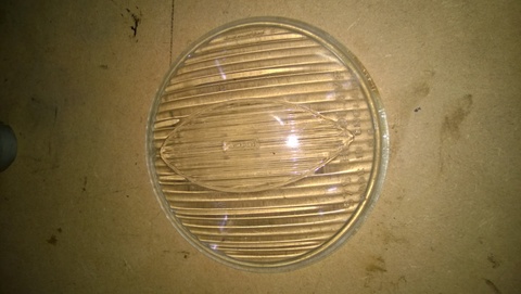

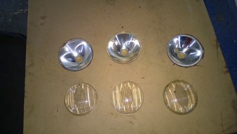

Whilst progressing things in the workshop we are aware that the project will get held up when it comes to the fit up stage if we don't stop on top of the parts / reconditioning of the numerous bits that will be required to complete the car to the planned level of quality - The headlamps on the early cars are very rare - being 5 3/4" and only fitted to 2 or 3 different cars between 1947 - 1949 - and are just about unobtainable - we had the original pair off the car but one of the reflective bowls was rotten - we had a spare but it had a non matching lens fitted to it
So with some careful work with a set of grips I pealed the retaining edge of the bowl back to release the lens on all 3 lamps
This gave us 2 solid bowls and 2 matching lenses - one knackered bowl and a odd lens - the 2 good bowls will be sent for re-silvering and I will rebuild the lenses to them once returned
