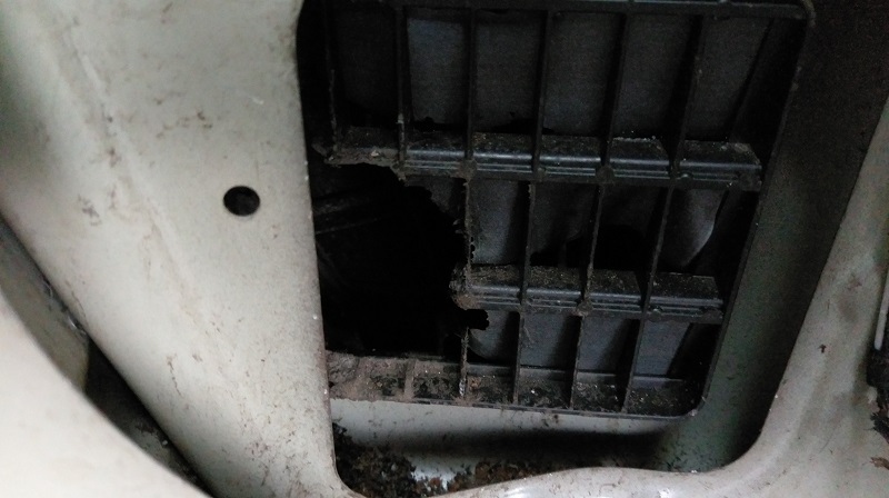

This is where the small furries were getting in (osr quarter panel vent, replacement ordered)

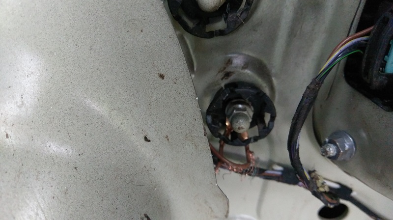

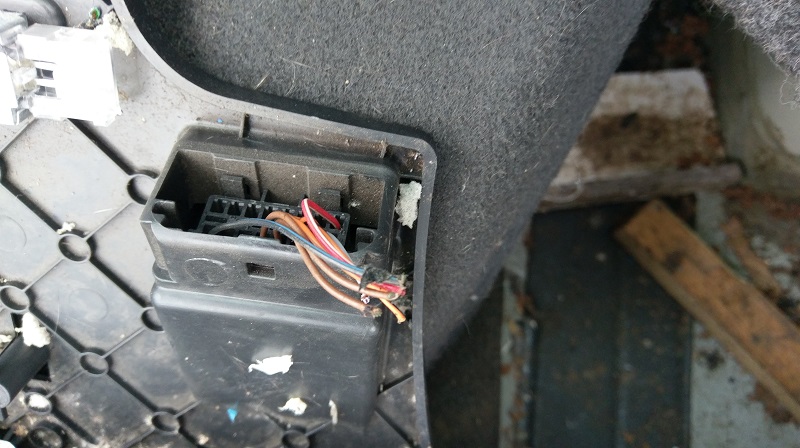

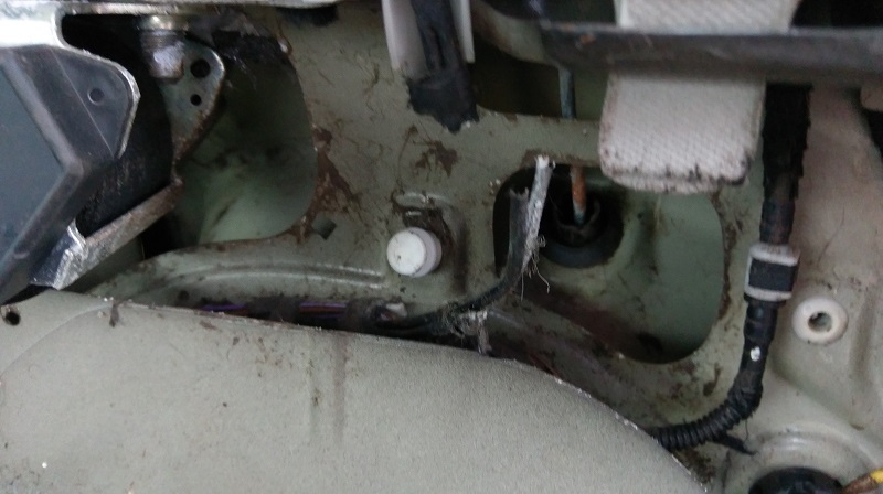

They appear to have gone forwards in the car down the rodent super highway (behind the side carpet in the boot) where the loom runs, all the way to the front of the car under the trim and up to the dash.
they have nibbled the wiring for the aerial (I think) the wires that run to the rear light cluster on that side, the cigarette lighter, the boot light, a couple of earths

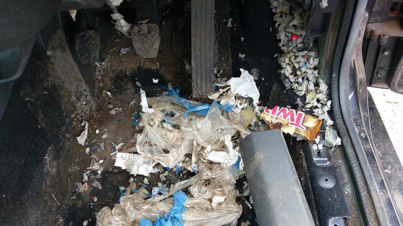

At the front of the car, I removed the lower dash trim on the drivers side and all this crud was inside the dash:

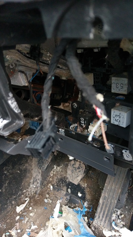

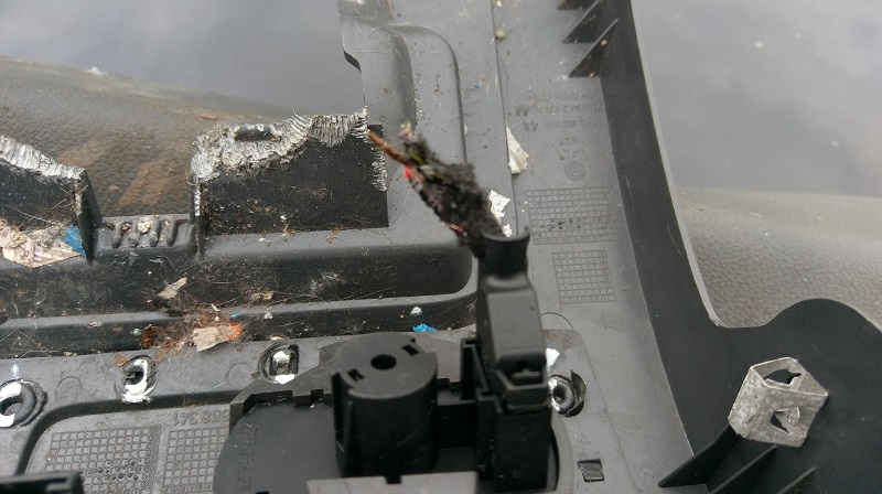

The panel was rather too easy to remove as the OBDII connector was no longer connected to anything
the reason the headlights don't work is because the switch isn't connected to the loom any more (and the plastic trim has been used for sharpening teeth)
headlamp switch.jpg (173.78 KiB) Viewed 7180 times

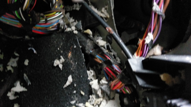

various wires are no more
And then I had to go back to painting in the house as SWMBO arrived home. I'm going to have to remove the whole dash and inspect all the wiring as there appears to be nest behind the relays next to the steering column which must be where the wiring damage is that is stopping the car starting on the key.
