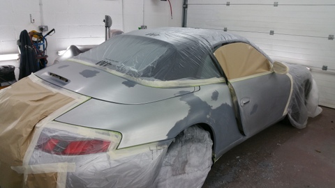

Meanwhile - there are a few motors I need to get back to clients before the holidays so:
Late 90's Porsche Carrera convertible in for panel & paint repairs
panel repairs & paint prep largely complete - ready for paint in the morning

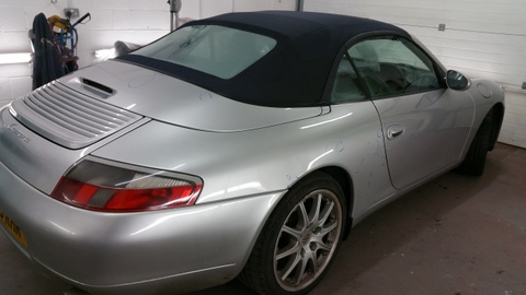

by Grumpy Northener
Painted, flatted & polished
Demasked & fitted up - I could not convince the client to have the rear bumper done at same time which now lets the car down especially as it has been repainted at some stage in the wrong variant shade of the original colour - anyhow just a quick valet in the morning and I can deliver it back to the client :D

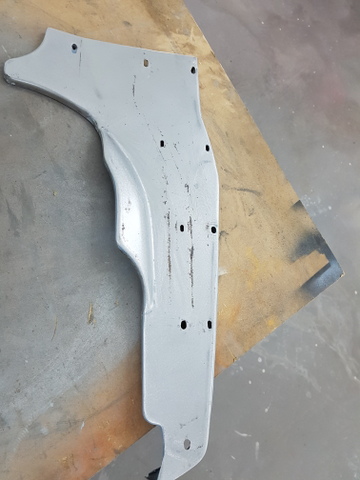

So next on the list is something a little different
1967 Lambretta GT 200 in for some minor welding where a previous restoration had bodged the floor side trims on with self tappers - so weld up the holes / dress back - weld up a couple of minor splits in the floor plates - little bit of reshaping on the same panels and make good the paint
Glad I took the panels back to bare metal as the previous paint job had seen the paint applied directly over rust

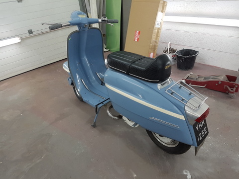

by Grumpy Northener
Primed, Painted & polished - bit of minor touching in on the scooter it's self - now ready for collection and assembly by the client (who was made up with the job) - so unless an emergency job turns up that's it for this year (will get a few jobs on my own motors done over the hols) but most of my resources have to be applied to getting a new kitchen fitted / floor tiled / utility room refitted over the hols. Plenty booked in for next year though - I have the the camper to get painted & finished plus there are three major classic paint jobs booked in already plus a fair bit to do on a Jowett Bradford van and the odd modern creeps in now & again - not complaining it's a nice problem to have - have a great Christmas all :D
