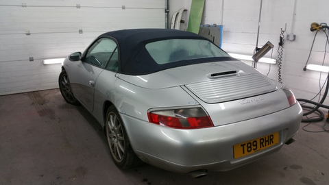

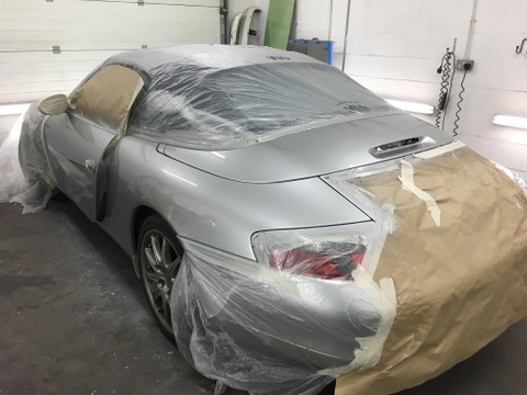

Meanwhile - there are a few motors I need to get back to clients before the holidays so:

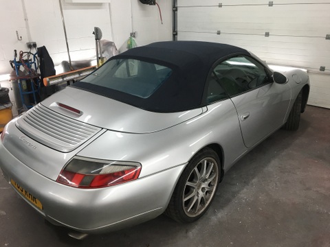

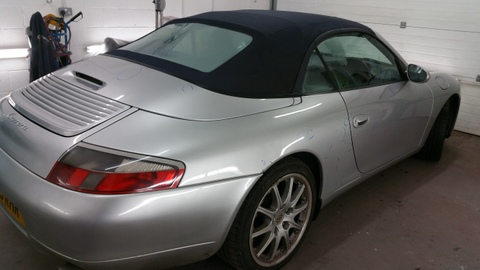

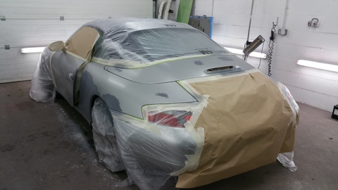

Late 90's Porsche Carrera convertible in for panel & paint repairs
panel repairs & paint prep largely complete - ready for paint in the morning

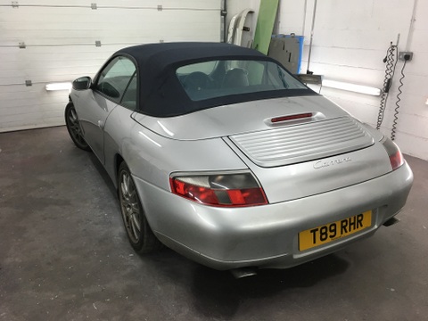

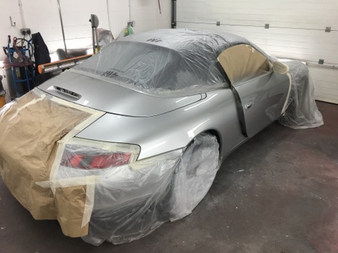

#32 Post by Grumpy Northener »
Painted, flatted & polished
Demasked & fitted up - I could not convince the client to have the rear bumper done at same time which now lets the car down especially as it has been repainted at some stage in the wrong variant shade of the original colour - anyhow just a quick valet in the morning and I can deliver it back to the client :D
#33 Post by kevin »
it will probably be back soon for the rear bumper paint given the stunning look of the new paint. great work Chris

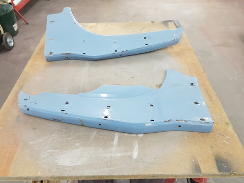

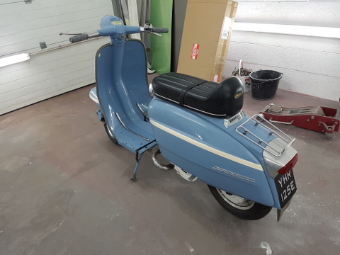

So next on the list is something a little different

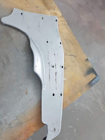

1967 Lambretta GT 200 in for some minor welding where a previous restoration had bodged the floor side trims on with self tappers - so weld up the holes / dress back - weld up a couple of minor splits in the floor plates - little bit of reshaping on the same panels and make good the paint
Glad I took the panels back to bare metal as the previous paint job had seen the paint applied directly over rust

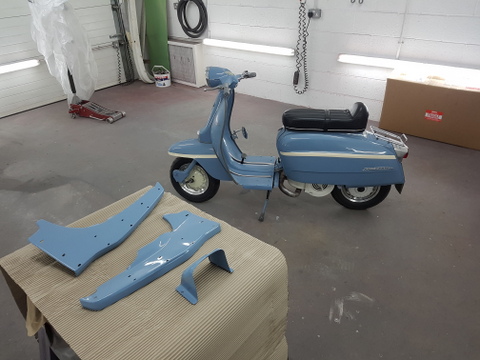

#36 Post by Grumpy Northener »
Primed, Painted & polished - bit of minor touching in on the scooter it's self - now ready for collection and assembly by the client (who was made up with the job) - so unless an emergency job turns up that's it for this year (will get a few jobs on my own motors done over the hols) but most of my resources have to be applied to getting a new kitchen fitted / floor tiled / utility room refitted over the hols. Plenty booked in for next year though - I have the the camper to get painted & finished plus there are three major classic paint jobs booked in already plus a fair bit to do on a Jowett Bradford van and the odd modern creeps in now & again - not complaining it's a nice problem to have - have a great Christmas all :D

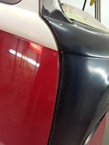

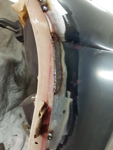

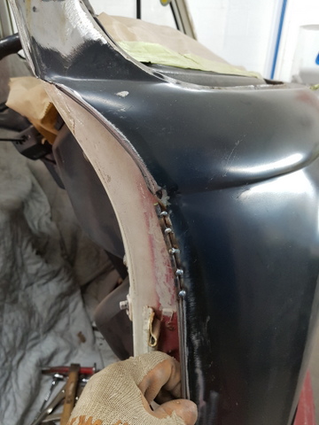

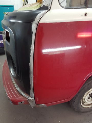

So onwards with the camper - as explained previously with the pattern front panel fitted I was left with excessive door aperture gapping of 10 - 12mm - I would like to reduce it to somewhat nearer 5mm - JPB said -
Does the work involve building up the leading or trailing edge of a door with welding rods.
- John you are so very close :thumbs: - But I opted to build the edge of the front panel out with 5mm mild steel bar

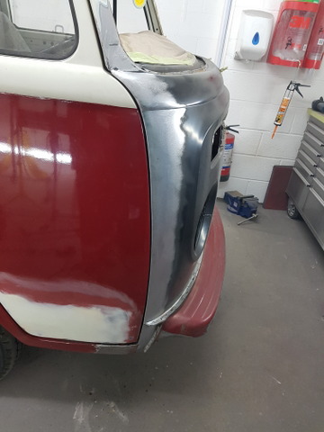

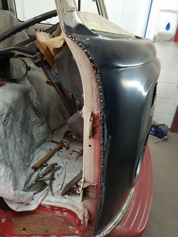

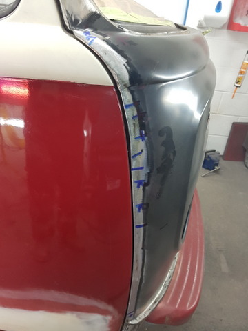

#40 Post by Grumpy Northener »
With doors removed & refitted several times - you just have to keep working methodically and take your time
Mark up any areas that require further work
You can further build out areas that require it by stitching weld to the area in question and dressing it back - but slowly the results will come
