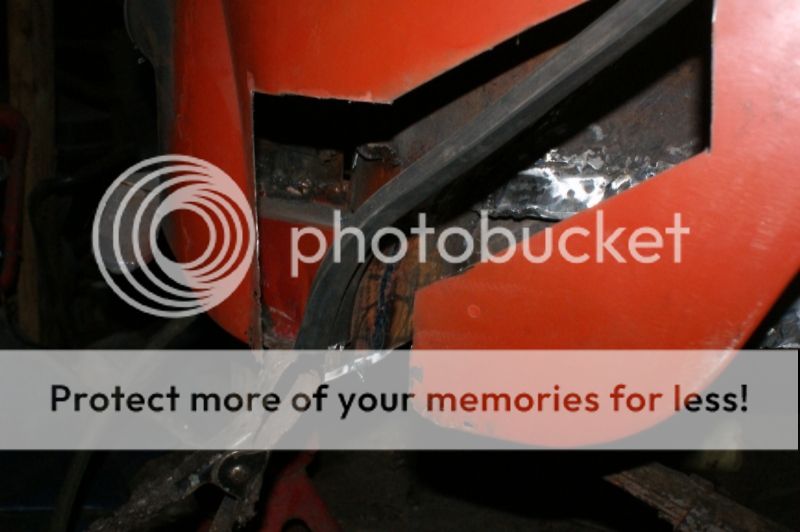

Anyway, a bit of progress made around all the other stuff that always seems to get in the way, I made up a rear quarter and quadrant piece that ties the boot floor / spring hanger / arch and rear quarter panel together and fitted that, forgot to take pictures but this is the old part to give you an idea

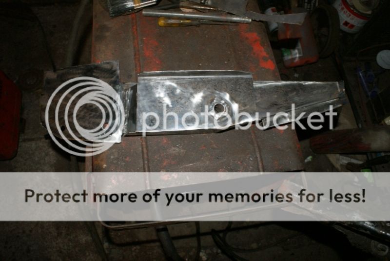

I did remember to take pics of the new spring hanger / chassis leg along with rear bumper mount that I made.
Spring hanger is now in place and I have started putting the rest of the metal in, pictures of the completed job soon I hope.

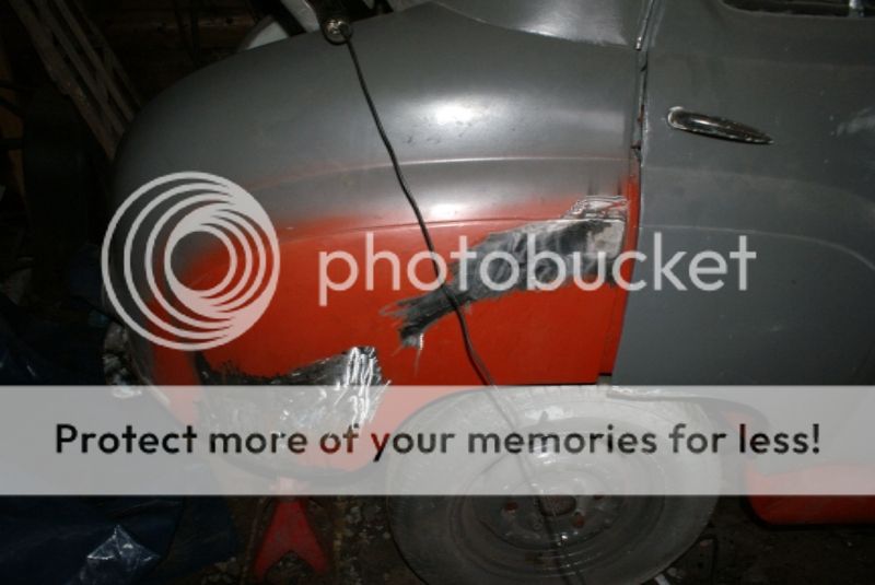

New chassis leg / spring hanger went in along with associated metal & wheel arch repairs
Then I could get on with the rotten rear quarter which was a fiddle but eventually came together and tied in to the other repairs.
So, that done there were a couple of repairs to the rear door required
And so structurally at least this half of the car is done, the next step is to shift it over in the garage so I can work on the structural repairs required on the near side. before this happens though I wanted to start attending to the cosmetics down this side so that everything is protected.

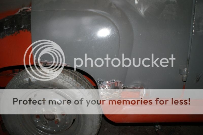

I got busy but didn't bother with photos I'm afraid, but basically sanded off the last couple of paint jobs down this side of the car and skimmed the repairs with filler, windscreen has come out now also.
This is where it stands today
That is the first coat on and drying, I'll flat it back a little in a day or so then give it another good coat before going to work on the other side.
I decided to go with synthetic enamel paint this time as I need to do every bit of the car inside and out eventually and don't want to bare metal every last nook and cranny, so given the various paint jobs over the years I thought this would be the safest option to avoid paint reactions.
I will point out this time it isn't a cheap option either, the paint is "proper" coach enamel mixed to order to the original Court Grey colour, which isn't a grey at all really but a very soft cream. Its from Craftmaster paints and at £27 a litre there are cheaper options but it is actually very nice to use compared to the industrial / tractor type enamels i've flirted with in the past.
