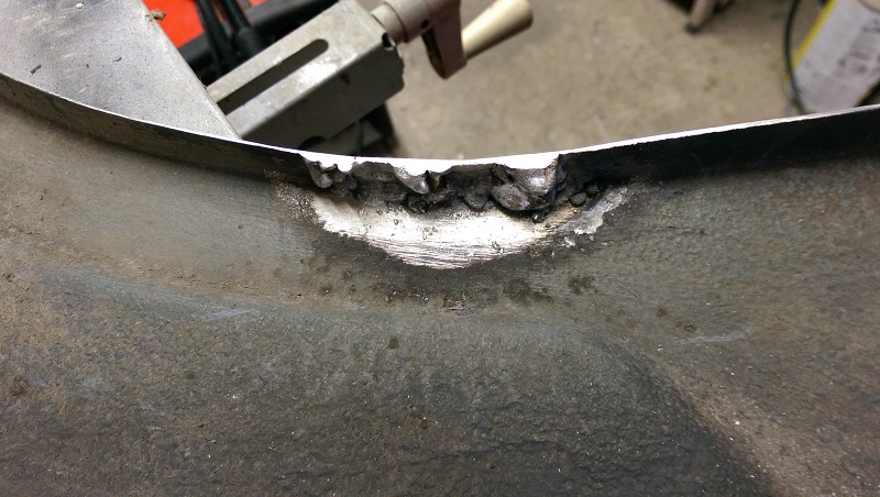

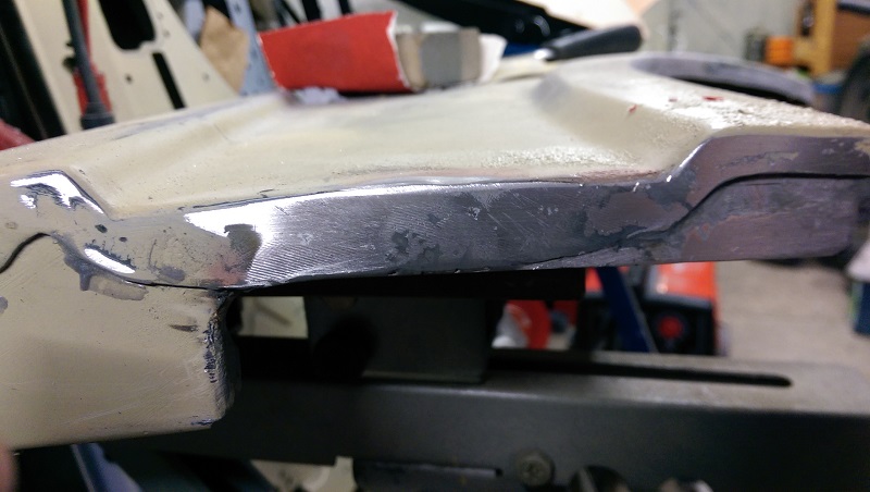

OK, I am 25 minutes late.
This is what the outside looks like after yesterdays filing down of previous attempts.
Plug welds after 2 minutes with a file
This is what the inside looks like. It needs some serious cleaning up which i will do with a grinder at the weekend then i can prep the wing for paint.
Blob tastic but damn solid!

Yep, that works for me! Just be careful when you use a grinder with ally - wear that mask!
Re: Aluminium welding with a MIG
Posted: Thu Jul 17, 2014 10:14 am
:thumbs: Yes, that'll do to be going on with. 8-)
