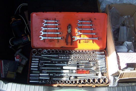

I think now would be a good time to tell you about one of my father-in-law’s prized possessions. A truly massive and comprehensive imperial and metric Draper socket set with almost every socket, hex key, screw driver bits and ratchet drives you ever possibly need in life. It was bought for him as a birthday present by his eldest son with his 1st proper paycheque back in the early 80’s (Sadly, one of the bereavements mentioned above.)
I knew of its existence because I had been allowed to look, and only look, at it when he was rebuilding my Marina engine all those years ago. So, it was with some trepidation that I asked to borrow it when I set out on my re-commissioning. To my surprise and great honour he said yes. He pointed out that the sockets may not all be in the tray in the correct size order. I took this as being his way of saying that “They had better all be in the tray in their correct size order when I get it back” and duly noted this.

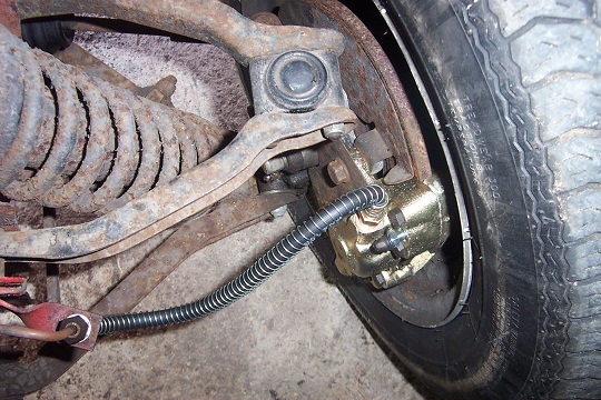

It was getting dark now but buoyed up by my success, I decided to remove the front callipers and hoses ready to fit the new shiny ones when they arrived. I put the front of the car on axel stands and had the job done surprisingly quickly all by the headlights of my strategically placed modern... Which then suffered the embarrassment of having to be jumpstarted off the new triumph battery before I could go home! :oops:

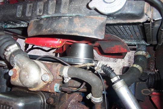

The water pump and recon callipers arrived along with all the other brake parts required and my trusty flask of tea and I were back at the lock-up bright and early the following Saturday. The plan was to fit the water pump, refit the radiator, fit the front callipers, hoses and master cylinder before turning Poppy around so I could work on the back brakes in the light from the open door.
Well I soon had the new water pump fitted and after searching for over an hour for the “safe place” refitted the fan and the radiator. Then filled up with the correct mix of water and antifreeze. The callipers, hoses and all associated parts were also fitted up properly and looking lovely and shiny. It went so smoothly, it was almost as though I had a clue what I was doing! The fly in the ointment though, was that while I was so successfully fitting all these shiny bits, I noticed that the bush had come out of one of the anti-roll bar links, the track rod end gaiters were horribly split and there was a small hole in the offside steering rack gaiter.

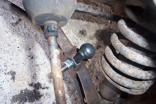

I started by removing the anti-roll bar link and tried to get the bush and tube back in, but it all refused to co-operate. Pushing with fingers didn’t work. Hitting it with a hammer didn’t work and neither did hitting it with a bigger hammer. Nor did a Fatbloke standing on it or jumping up and down on it manage to get the bush back in so I gave up and went home and decided to order a new one with all the rubber bits now required.

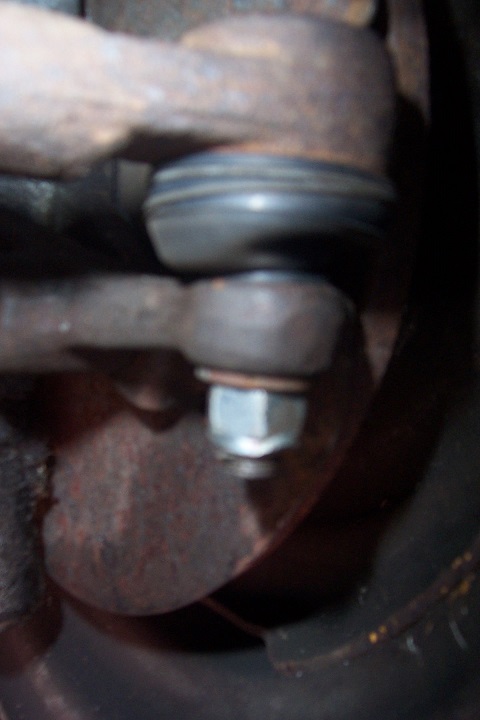

The new anti-roll bar link was quickly fitted and it was time to turn my attention to the track rod end gaiters which looked easy. Just a matter of undoing the single nut slipping the track rod end out of the steering arm and swapping the new gaiters for the old.
I am sure all the old lags out in forum land have already spotted the flaw in my plan. The nut was undone but I could not separate the track rod end from the steering arm. I tried pushing it, wiggling it, pushing and wiggling at the same time. I then tried standing astride the wheel and lifting it until I remembered the calliper incident. I even consulted my trusty Haynes manual which had never let me down so far. It simply said “remove from steering arm” which I didn’t find particularly helpful! I am ashamed to say I then resorted to a big hammer…which didn’t work either.
It was time to cancel the MOT and consult the experts… I posted a plea for help in the technical matters section and you didn’t let me down. The first reply from “Zipgun” said “Whatever you do, don’t hit the threaded bit with a hammer”…oops….I had left the nut on the end though…
Apparently, track rod ends are also known as “ball-joints” that I need to “split”. I did consider Zipgun’s two hammer method but Mrs FB pointed out that I was dangerous with one hammer let alone two. Luxobarge then came to the rescue. He pointed out that there is a cunning tool imaginatively called a “ball-joint splitter” which of course, I didn’t have. I quick trip to my local machine mart rectified this and my ball-joints were very quickly and efficiently split, gaiters changed and all reassembled and I’d discovered a new favourite tool. It’s called “the right one for the job”!! Handy hint though. NEVER pick up the Machine Mart catalogue. I have wasted an awful lot of time drooling over it planning my “lotto win” workshop full of all the “right tools for the job”!
