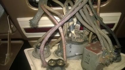

The ignition switch had been playing up and a spare was located among fellow member Keith's 40 year stash of Jowett spares - no key with it but Keith managed to find two matching keys the following week at a local rally
Simple access - a couple of screws later
Slight rats nest and very elderly wiring (new wiring loom on the books over winter - but might wait and do it at the NEC restoration show in March)

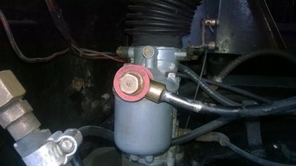

Job one sorted next was the minor petrol weeps on the carb feed pipes - there are several unions & joints all bodged during previous ownership - bits of plastic plumbing washers etc
Some of the banjo unions required refacing to ensure a sound seal
Several copper washers later and we had the petrol system issues resolved.

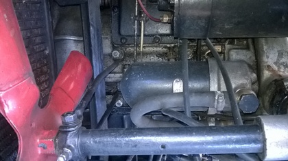

The engine has now done about 750 miles since its rebuild (rebuilt immediately prior to my purchase of the car) so time for a oil & filter change
Filter housing sits centrally over the top of the crankcase but there is a valve that allows the filter to be drained into the sump prior to removal -still quite messy though
On the plus side - never have I owned a car (in over 40 modern & classic) with such easy access to the dipstick and oil filler

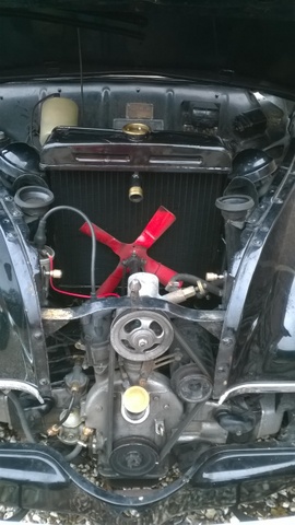

Old radiator had a couple of weeps on it plus a large majority of the cooling fins looked like they been to war so I had the club spares department exchange it for a rebuilt one - I also removed the Heath Robinson electric fan that a previous owner had fitted at some stage - the car really doesn't need it
New radiator in - I took the liberty of fitting new hoses - one each side to the heads at the bottom and one at the top from the water pump.
