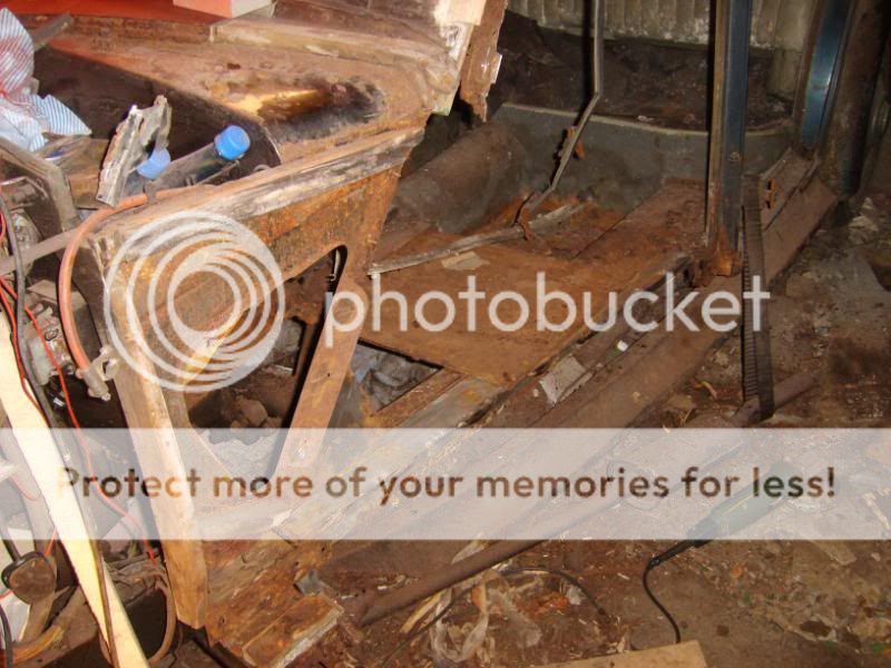

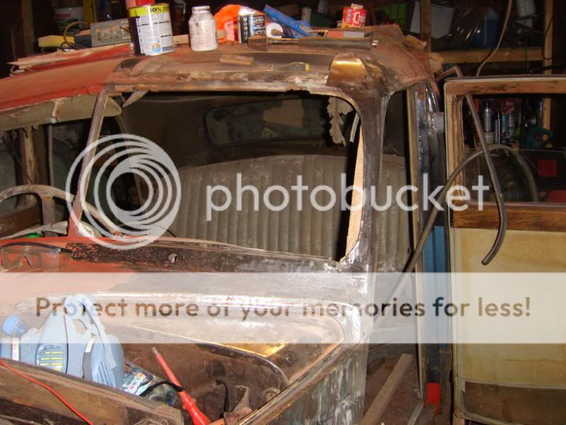

A little more sanding allowed for a coat of red oxide to protect things until I reach the same stage on the near side, this will be gone over eventually with a high build primer and flatted off until good enough for top coats.
A little bit more of the nearside dissapears, and a lot more debris is added to the floor beneath it. Its ready for wood and metalwork now. Although this side was much better than the drivers side it was soft enough to warrant replacing some of the wood while I have the chance, a lot had to be removed really anyway in order to do a proper job of the metalwork.

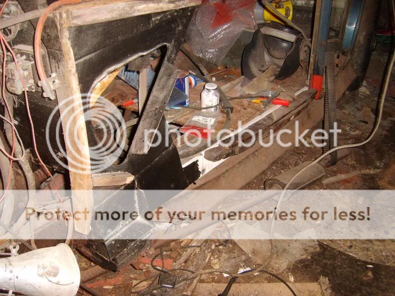

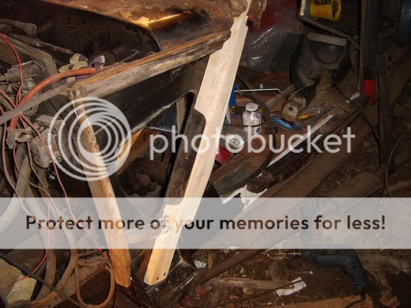

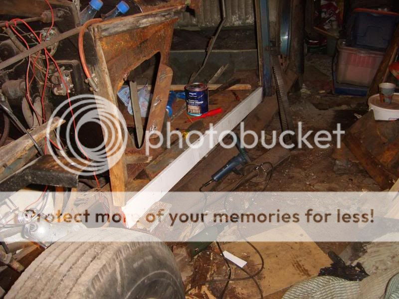

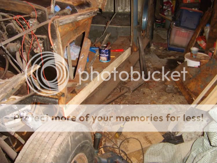

This week I've let in some new timber starting with the vertical section of the bottom runner / sill
This then got covered with a sheet metal channel section as per the original, I'm not absolutely sure why though it will protect it a little I suppose.
With the channel section on I was able to re fit the old Cill timber that carries the steel sill and makes up the inner sill / door shut section.

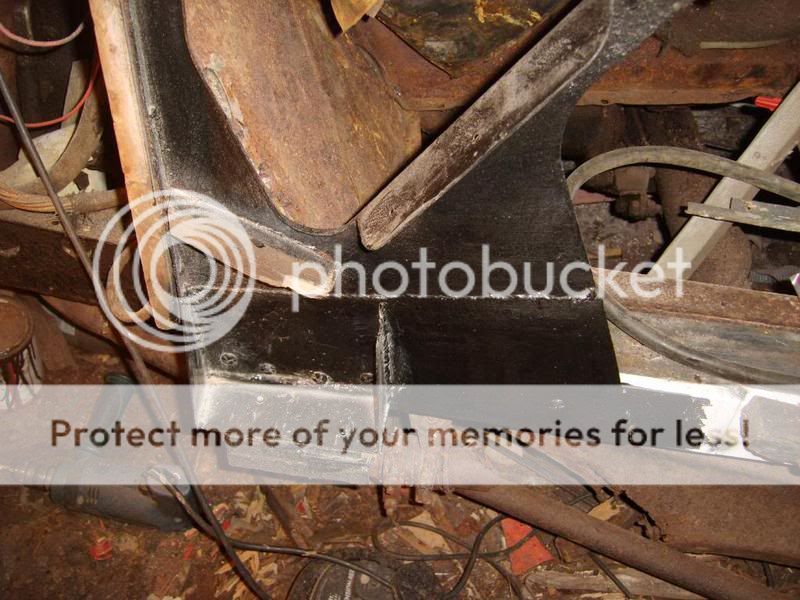

This left me ready for welding in some new metal to the bottom of the inner A panel along with fabricating a new body mount. My old friend hammerite got another outing to protect it all.

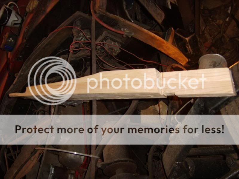

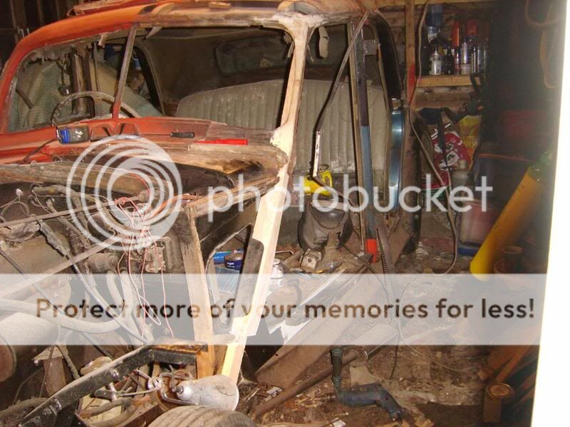

I then set about shaping the new A post, which reminds me I really need a new hand saw, this was the end result.
This was then glued and screwed in place
So at least now I have some solid timber, I need to make up a couple more sections and figure out the curved section that meets the sill board then I'll be able to get back to some metalwork. I think though that I might need to clear a bit of floor space again first so I actually have some room to work.

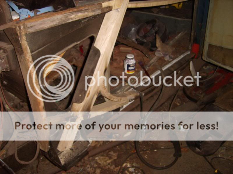

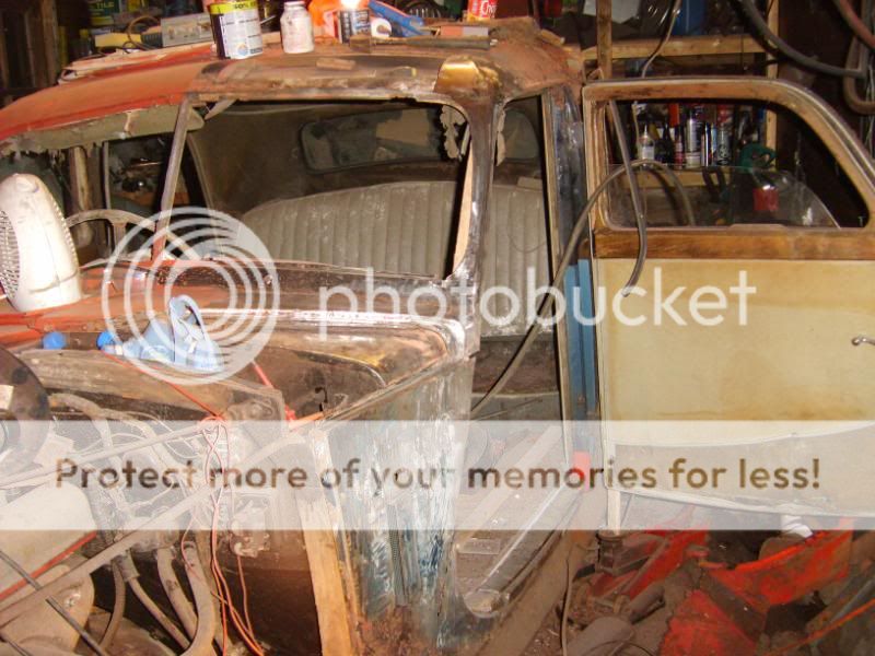

So, wood frame is done for this section
What I have found is that this side has also sagged on its door pillar and the front body mount being shot as it was I've been unable to gain the correct gaps to the door, so its been a bit of a compromise between finding a height for the centre door pillar that allows the back door to open and shut, and the panel gaps for the front door. For now the door pillar is jacked to the position I have decided is best ready for a new bracket welding on to fix it firmly in place, I Have to plate a fair bit of the A panel anyway so I can alter it slightly to get the correct gap for the front door shut.

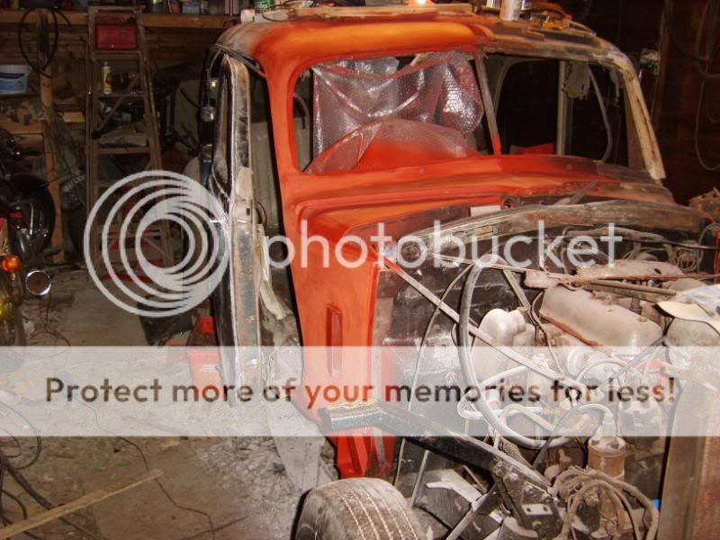

In the meantime I've re hung the A panel which can now be repaired in situ, and started on replacing the windscreen surround.
Note the nice shiny new filter mask, much to everyones amusement I'd been refusing to use it as i was saving it for spraying and fumier work, as a nod and a wink to my health I relented and its been seeing some serious use, its that or give up the fags completely I suppose ;)

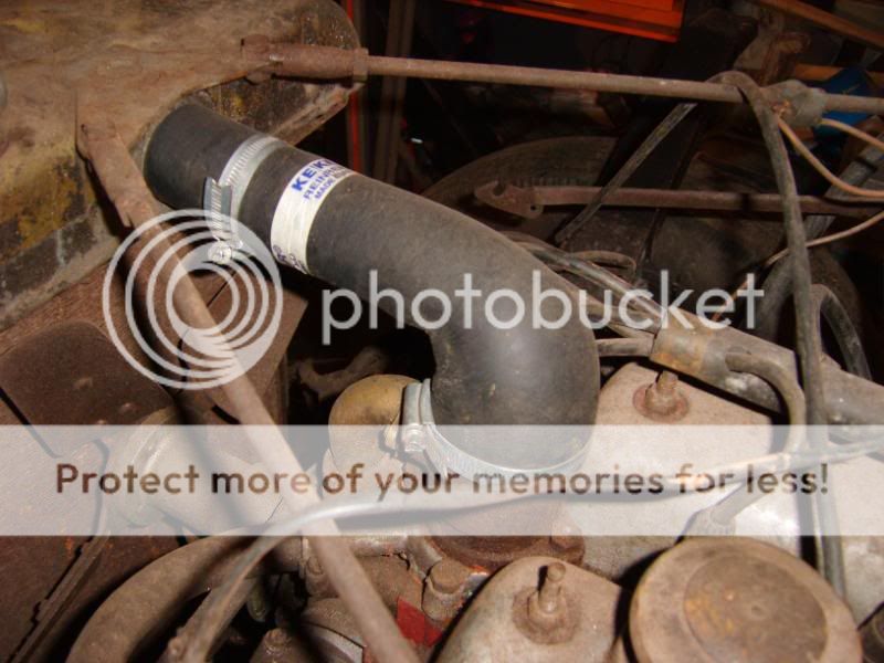

The snow and ice has arrived now, so I figured it was time to drop the water out of the cooling system from initial testing, I hadn't added anti freeze due to needing new hoses so I couldn't put it off any longer.
The system is empty now, I have a gallon of antifreeze ready, so it was time to find some hoses, Ebay provided a new kevlar reinforced top hose which I thought would have been harder to find, the bottom hose is actually a bent steel pipe which had a couple of pin holes in that I'd welded for testing the engine, I can't leave this on long term as it is bound to give up the ghost sometime, so I've ordered some supposedly flexible radiator hose that has an inner coil that should hopefully allow me to route it the same as the original steel pipe.
The top hose is on

So, I got the new bottom hose and fitted that, should have took a picture as its quite good stuff and can be routed quite tightly, no matter how hard I bent it I couldn't get it to kink.
