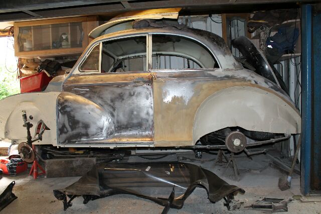

Some pictures firstly the minor stone chipped.

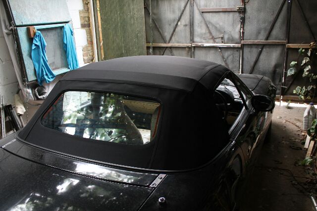

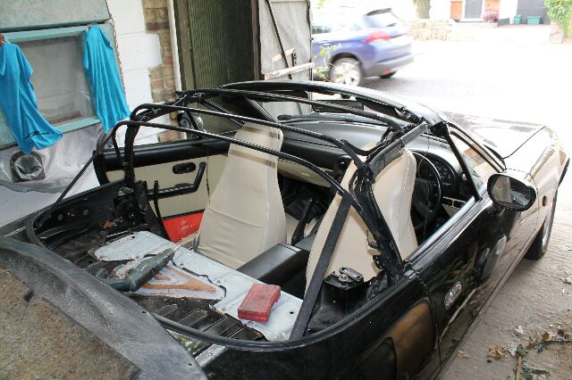

I also fitted the new hood to the mazda, firstly fitted the mk2 frame which bolted straight on allowing a mk 2 hood with glass window to be used.
Then the hood its self, pretty easy compared with the older cars, all the holes are pre punched and just a matter of working methodically from front to back.
This is the result

Been busy getting the minor ready for paint, pretty much there now, firstly stripped it to a bare shell, then stripped all the paint off the outer panels, filled minor dents etc, rubbed down the door shuts and interior, I still have to weld a crack in the drivers door (where quarter light passes into the door) and plan to plug weld a steel bar in for reinforcement as they seem to often crack here. Intent is to get it all in epoxy primer on saturday and if that goes well I may even get some colour on it next week, starting with the interior and door shuts.

I now have some paint on the minor, it is epoxy primer and went on well, there are a few runs, and a few areas reqyuiring further work have come to light, but on the whole I am pleased with the result.

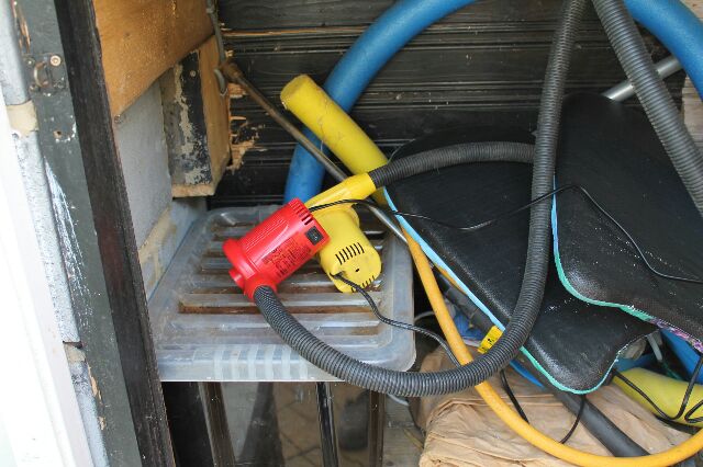

To spray the paint I used a fresh air breathing set up , I have. Used before, I have a ring of hose around the garage with T pieces in a couple of places, too the most convenient one I attach a conventional mask, , the two ends of the ring are then routed outside the garage into an adjacent outbuilding, where they are fed by two 240v air matress pumps which I purchased from aldi for a fiver each.
These are the two pumps feeding the pipes.

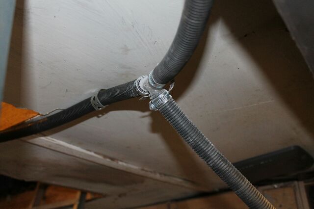

This is one of theT pieces, one pump feeds from each side, the mask connected to the branch.

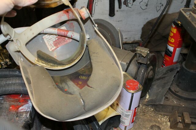

And the mask I use, the foam is begining to break up so I will need a new one soon.
With this I can spray away and not even smell the fumes.
