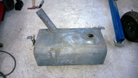

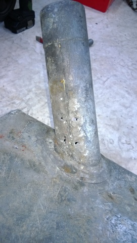

I would like to get the mechanical parts into paint in the near future so that Keith can start to rebuild them into sub assemblies - I don't want to be having to delay the bodywork on the panels & shell by having to paint the mechanical parts in several batches so the plan is get the majority in to primer & colour in one large batch - the petrol tank forms part of this batch but required work
With perforations to the filler neck and top of the tank - loose mounting bracket - the tanks are not available new so repairs would be required.

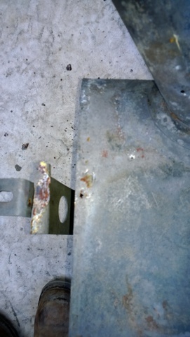

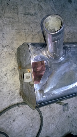

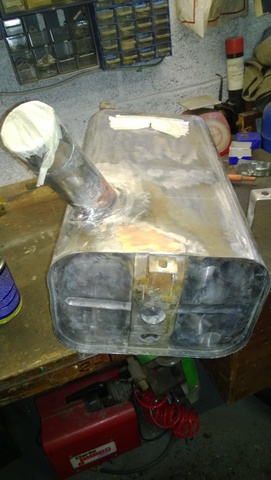

I spot welded the bracket back in to place and then solder pasted the repair area on the top of the tank
I am using sheet copper for the repairs but you can also use sheet steel providing you tin it up first (tinning is achieved by solder pasting the steel)

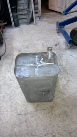

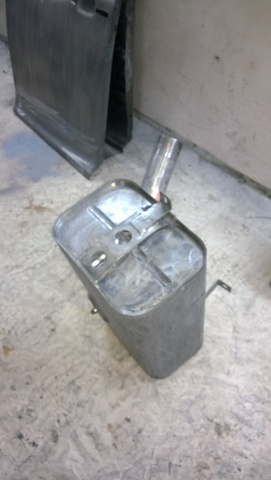

Repairs to top of tank & filler neck completed by soldering the repair areas both of these areas are well hidden between the top of the tank and the bodyshell of the car

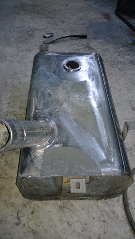

I cleaned up the rest of the tank and then soldered the seam / mounting ring for the tank gauge sender / outlet feed & the drain plug
All that is required now is testing - then I can sort out a couple dents that it has acquired over the years prior to it getting painted

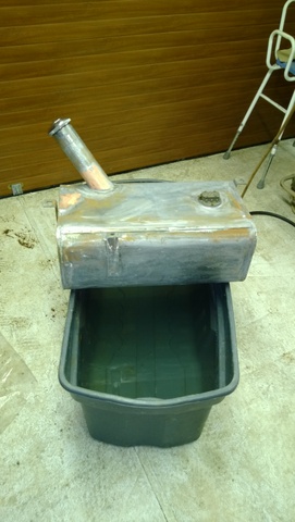

We tested the tank by immersion in a water tank and pressurising the petrol tank with compressed air
A few very minor weeps showed up but in the main these were the spotwelds that retained the internal baffle plates that we had not touched so far - they were soon made good and the tank retested - happy with the soundness I left the tank to dry out on top of the stove for the rest of the afternoon
Before leaving I added POR 15 tank sealer (available from Frost Restoration Products) to the tanks internals and sloshed it around for half an hour before draining it
This should take care of the tank and prevent any rust forming internally in the future

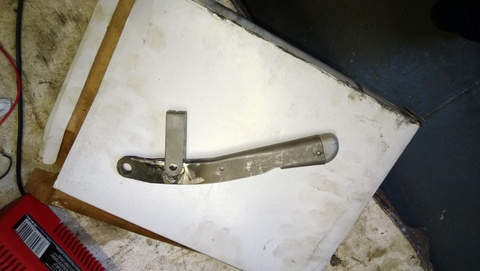

Meanwhile Keith has been busy sorting the handbrake set up
Welded repairs and strengthening webs added
New retaining pin for the cable bracket machined to take into account the extra width of the strengthening webs
