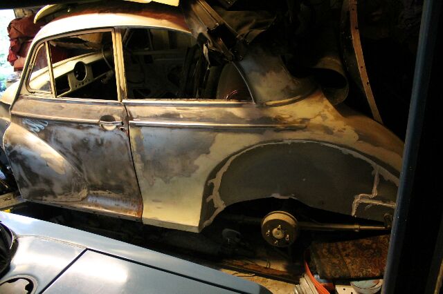

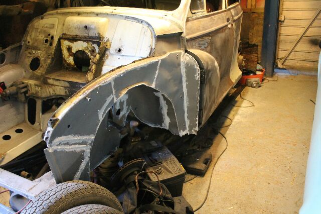

Been working on the minor, the underbody is now painted and sealed just needs stone chip coating, the rear end ius ready for primer and the interior and engine compartment are stripped of all components.

Plan is to get the shell and doors painted this summer which will allow us to build up the mechanicals and interior trim over the winter, then paint and fit the rest of the panels next summer.

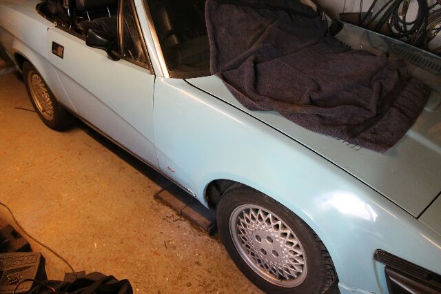

I have also been tidying up some of the dodgy areas of paint on the TR, this is an example on the front wing.

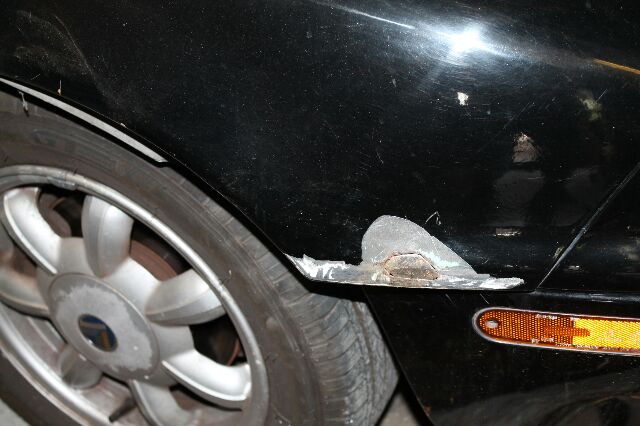

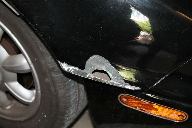

Been working on 3 fronts today, firstly on the mx5, while washing it the other day I rubbed a mark on the wing to find a hole appeared as a piece of filler fell out, after cleaning it up I had this.
mx5 wing1.jpg (41.26 KiB) Viewed 2626 times

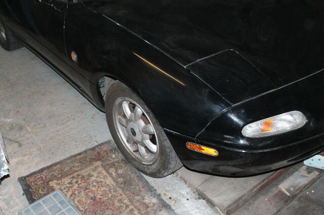

Cut a piece out to weld in then smoothed off weld with a flapwheel to give this.
mx5 wing2.jpg (47.83 KiB) Viewed 2626 times
mx5 wing3.jpg (37.7 KiB) Viewed 2626 times
Finaly primed and painted
mx5 wing5.jpg (44.38 KiB) Viewed 2626 times
Needs cutting back more but I left the paste in the tr at work, so only had Tcut.

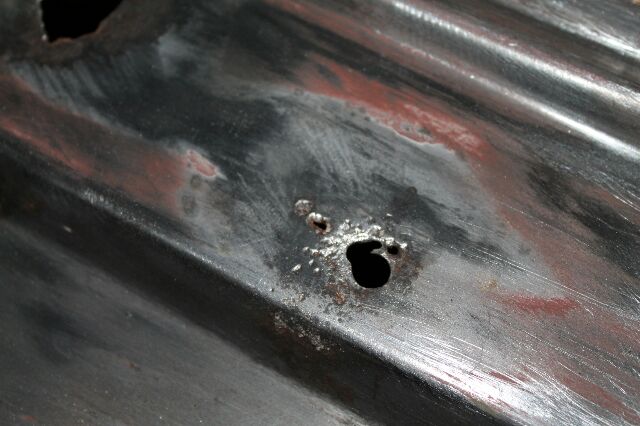

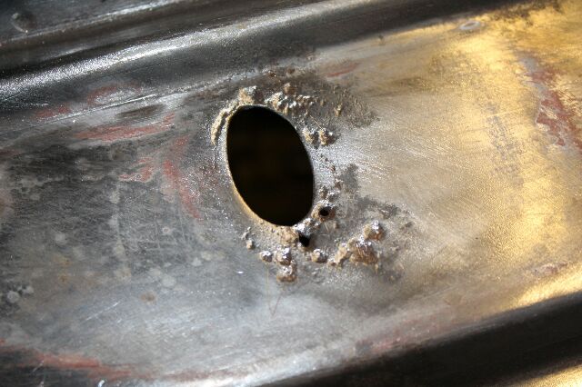

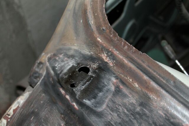

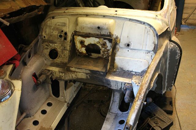

While I had the welder out I had also found some more rust on the minor when stripping the paint off the scuttle so this had to be repaired, firstly the damage.
minor scuttle1.jpg (45.06 KiB) Viewed 2623 times
minor scuttle2.jpg (57.74 KiB) Viewed 2623 times
minor scuttle3.jpg (46.64 KiB) Viewed 2623 times

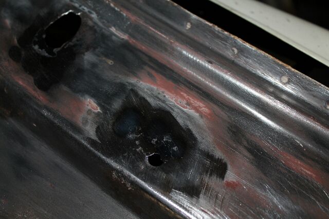

Then welded them up.
minor scuttle4.jpg (46.47 KiB) Viewed 2623 times
kstrutt1
Posts: 516
Location: essex
Re: kevin s's blog
#287 Post by kstrutt1 »
minor scuttle5.jpg (39.86 KiB) Viewed 2622 times
Still need to file the holes out but otherwise done now, getting closer paint.

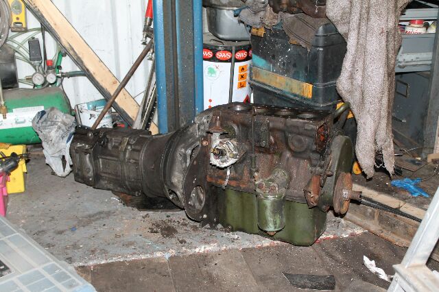

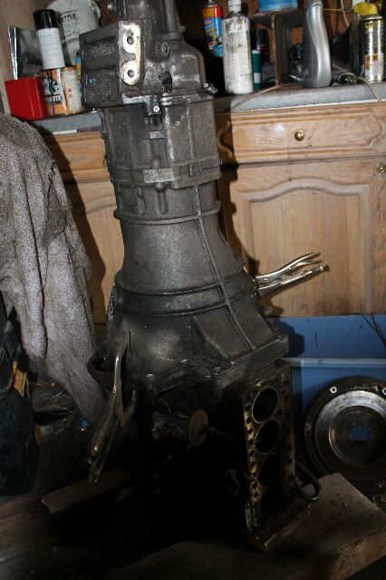

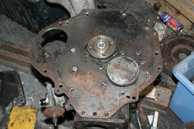

Thirdly I drilled the minor engine backplate for the mx5 gearbox, firstly the input shaft was wedged centrally in the nose of gearbox using alloy strips, it was then dropped into the pilot bearing and clamped in place before using suitable sized drills to mark the centre of each hole, the box was the removed and the holes drilled.
Just need to cut some of the bell housing away to give clearance for the starter and the ring gear is touching the inside of the bell housing so this will need fly cutting out.
That though can wait, at least now it can be trial fitted into the car.

On the minor I have cut the Mx5 gearbox so the starter fits and bolted it all together, might even try fitting it in the car at the weekend, tomorow night I plan to stone chip the underbody.
