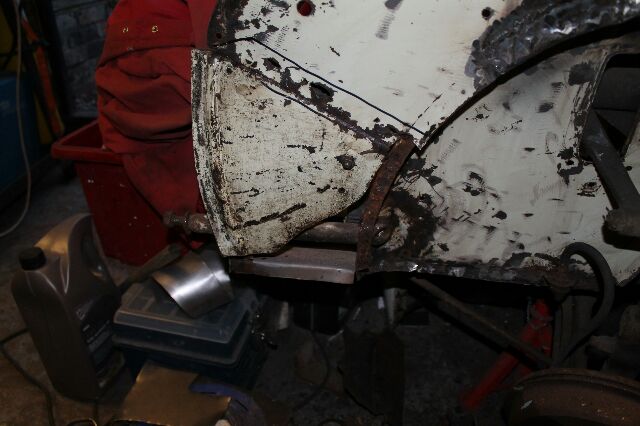

Some more welding on the minor, the are around the bump stop is now finished.
Next up is to butt weld a piece in the front lower corner and to replace the seam, with this all of the welding on the shell will be finished, only 2 years of work!

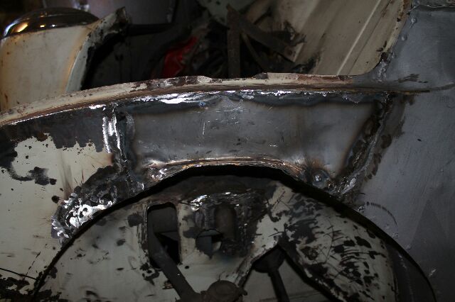

Finished the inner wing welding today,

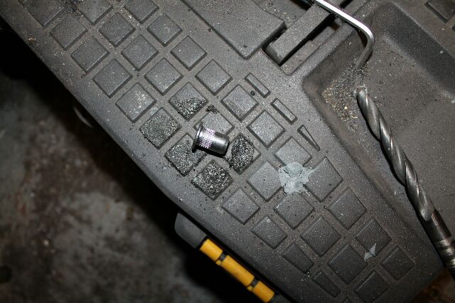

I also welded in inserts for the wing mounting bolts,
I used stainless rivnuts like this one.

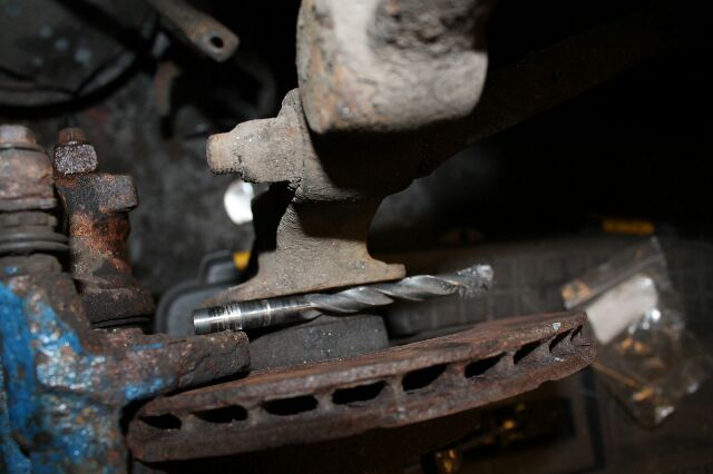

I also looked at my idea to fit corsa front brakes, it looks a strong possibility.
I opened up the centre of the disc so it fitted. Then slid the caliper over it.
The caliper mounting looks like it will be pretty simple, in the picture below a 10 mm drill is placed between the upright mounting face and caliper face, so it should be pretty easy to cut an adaptor out of 10mm steel plate.
I just need to get a non vented disc which will match my calipers to make sure the disc centre line is the same.

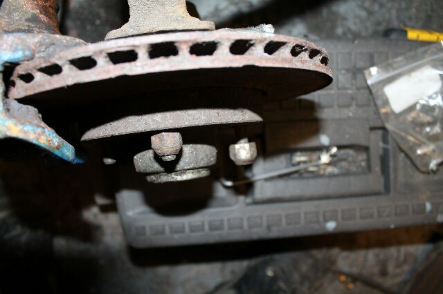

On the other side it will need a wheelspacer, the corsa must have a dished centre to the wheel, the minors are flat, it needs around 15mm, 19mm seems widely available for around £20 per pair.

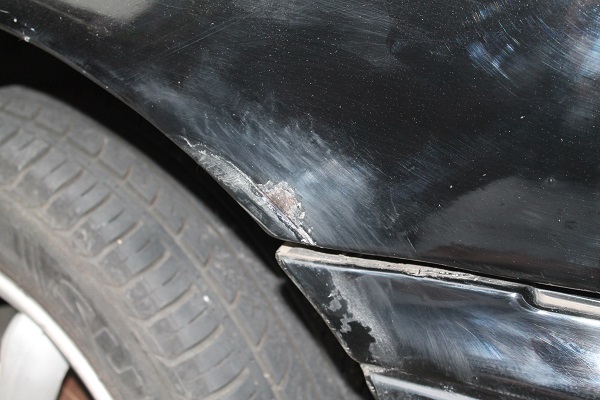

Spent a little time on the MX5 today, put it on the ramp and fixed the rattling heatshield on the downpipe, then finished off the paint repairs to the rear wheel arch where the mudflap had worn through the paint causing corrosion.
before:
After:
