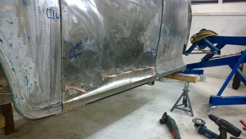

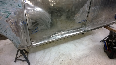

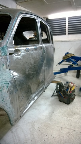

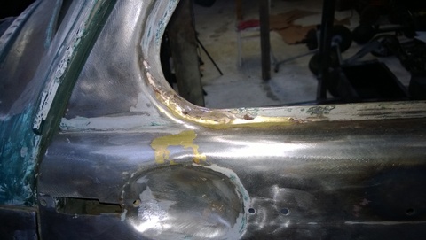

Managed to unpick the tacks on the door repair and reshape it so that I could roll the swage line inwards to line up with the front wing & rear door
Once I was happy with the alignment I removed the door and welded the repair fully - then cleaned it up and rehung the door

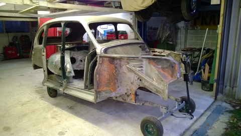

So the shell has its movement wheels under it and I managed to get it out of the workshop and on to the trailer by early evening - got back home with the trailer and will run the shell up to Tamworth tomorrow.

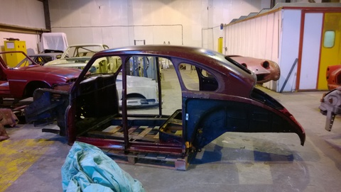

Just one of the many bodyshells having completed the bare metal process (many more were awaiting treatment) - so hopefully I will be able to collect the the rust free shell before the holidays :D

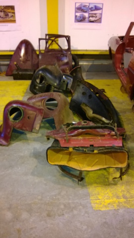

Mad busy with the day job but over the past few days found time to collect the now paint & rust free shell & body panels from Envirostrip at Tamworth - we have another Javelin project in the wings - this is a ex factory experimental car (hence very, very rare) having been sat in the corner of the workshop for a few years a decision was made to also have this car bare metaled - otherwise the trailer would have been going empty up to Tamworth - so having spent last weekend stripping the shell out, Keith then spent several evenings stripping the doors & panels down ready for the trip - We loaded up on Sunday and I drove the trailer up on Monday
Javelin shell ready for the process
Couple of sets of body panels
Never one to miss the opportunity I also stripped the few bits of the bulkhead off my Jowett Jupiter special - which is a future project - so a proper trailer load with this lot
