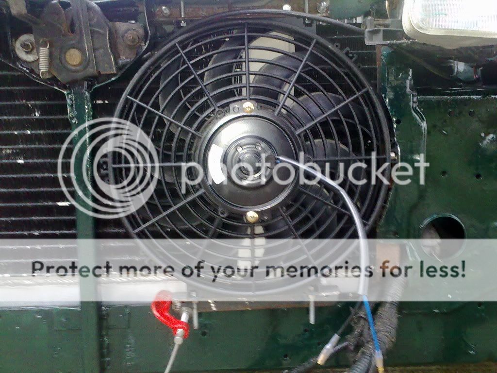

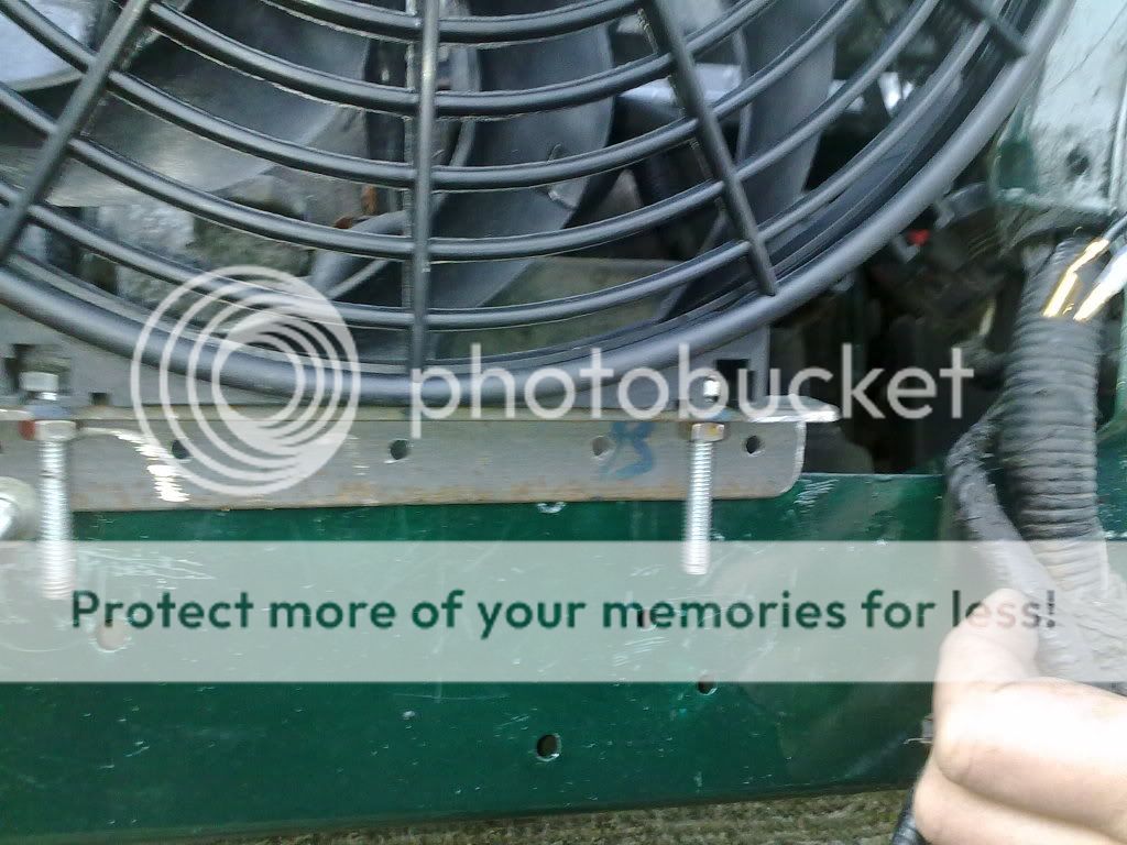

I got the angle iron for fixing the fans drilled, the out came the grinder to shape
the part to the curve of the top of the radiator support.
The fan fixing bolts will bolt down over through the top of the radiator support.
Doing it this way will make it easier to bolt and unbolt it, otherwise it is to fiddly.
I have carefully cut and filed down one of the fixing bits on the fan housing. So I
could get it as high as possible and as far into the centre as possible.
The bonnet realise cable had to be fitted too so I could figure out what goes where!

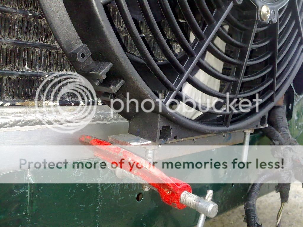

As the fan will be sitting flush on the radiators, so I carefully marked out what needed
to be trimmed and what could be used. As I was trimming the edge I kept a tab of
metal which a hole was drilled into and made flat and bent to make a fan fixing tab.

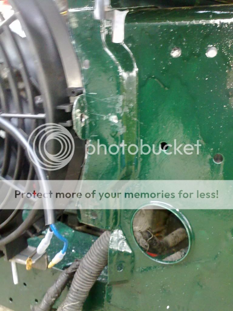

I think I screwed up with my measurements somewhere!!
As that bracket should be fully on the bottom of the slam panel.
I used a small G clamp then dropped the radiators in.
The fan fixing bracket will be welded to the slam panel, so that paint
will need to come off, Bugger!!!

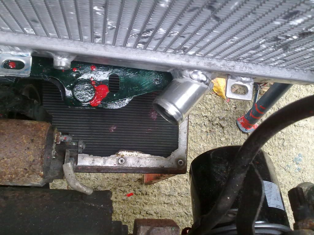

The Race radiator was dropped off at Hartlepool Radiator company this morning,
it could be ready tomorrow at a cost of £15. They are putting a 45 degree
bend/angle on the bottom pipe to avoid the oil filter.
It's cheaper than moving the outlet entirely and quicker.

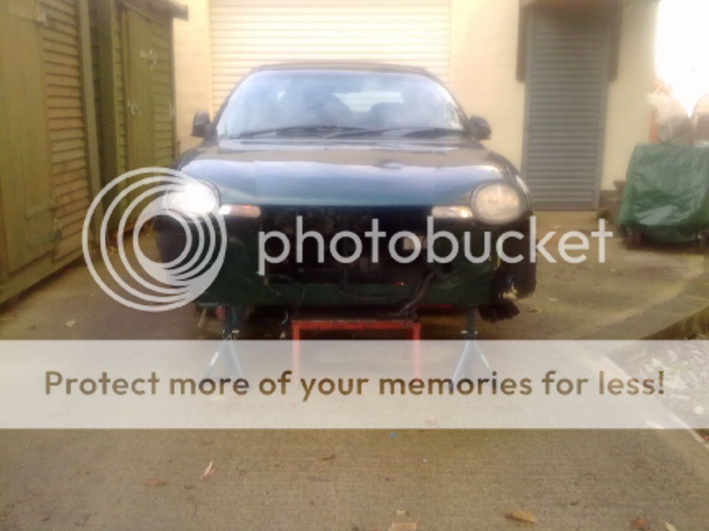

The car front hend is up on axle stands, with the wheels off and the contol arm bolts
etc sprayed with penetrating oil(wd-40) then wrapped in plastic.
And the bonnet prop is back on so no more using a peice of wood.

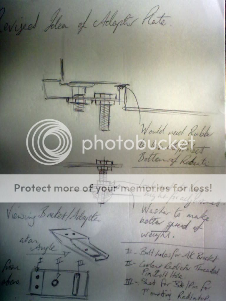

As I couldn't get any sleep, I had a little rethink of the adapter/mounting
bracket for the bottom of the radiator.
It will be simpler to make and fewer parts, and adjustable!!

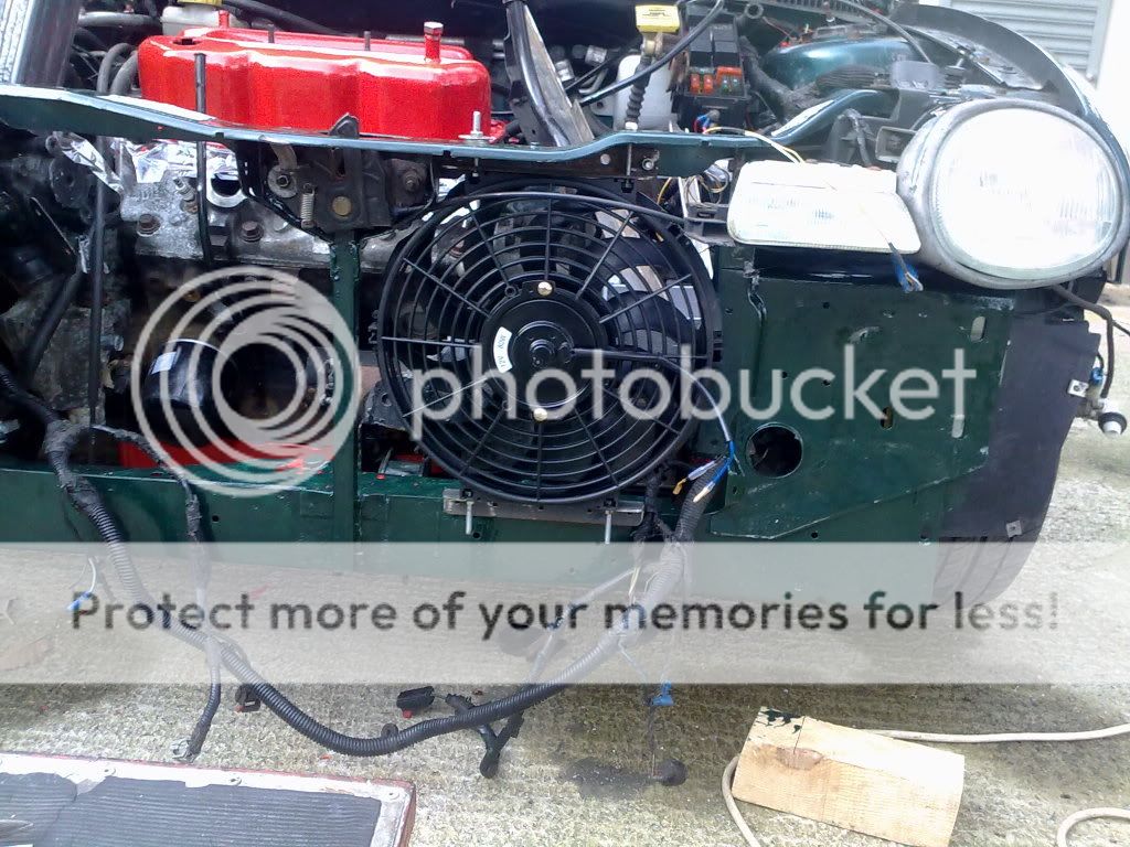

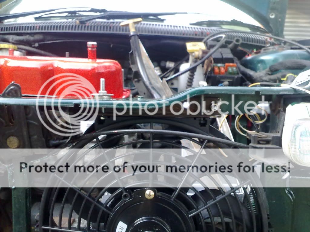

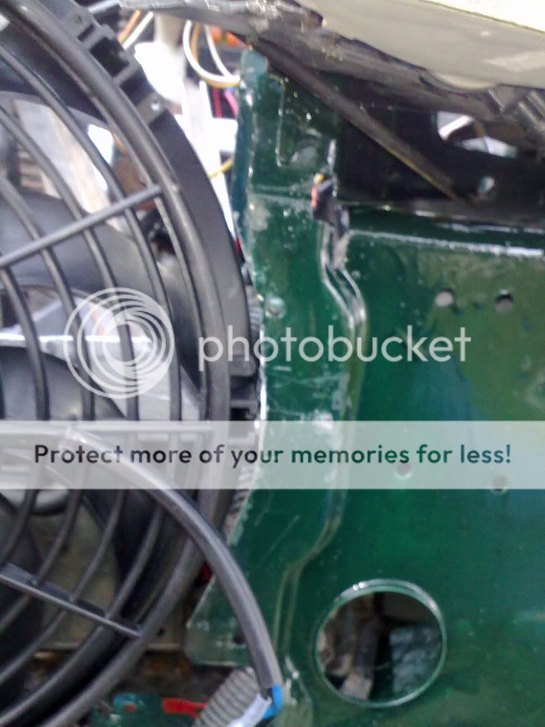

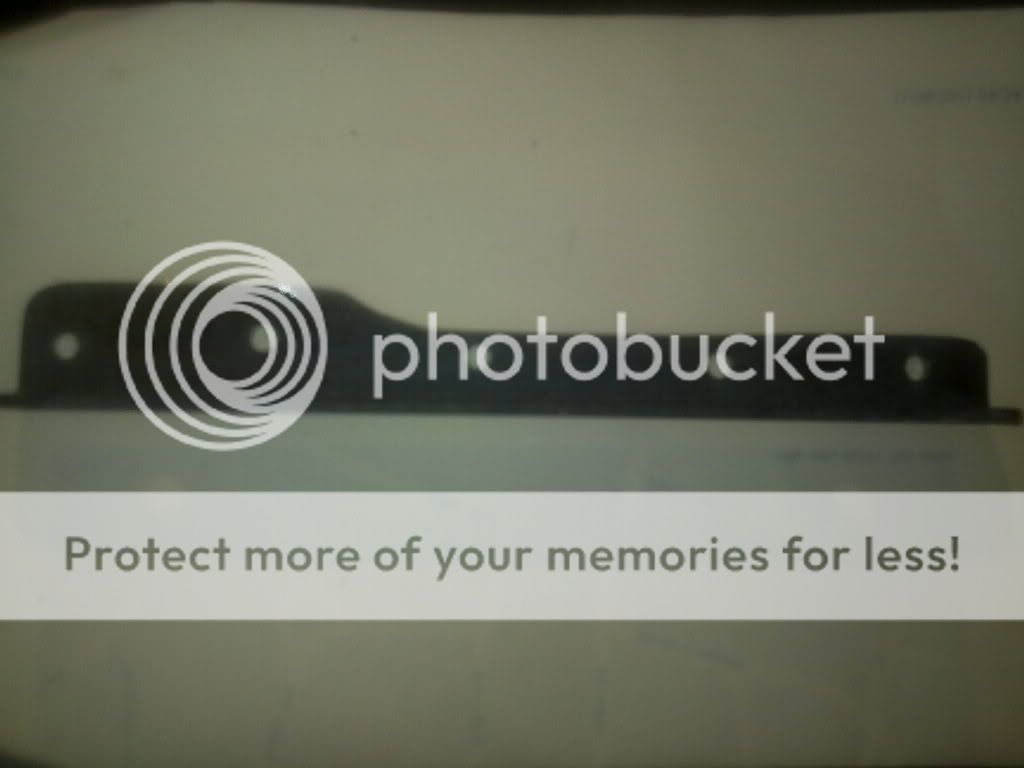

Just a couple of photos. Yesterday I had removed the cooling fan
when I jacked the car up and put it on axle stands.
Here is the right side upper mounting bracket which is a mirror
image of the one currently on the car.
As you can see now with this bracket, having the bolts going down
through the upper part of the radiator support makes more sense.
As it would be too fiddly to bolt up, and harder to adjust the fan.

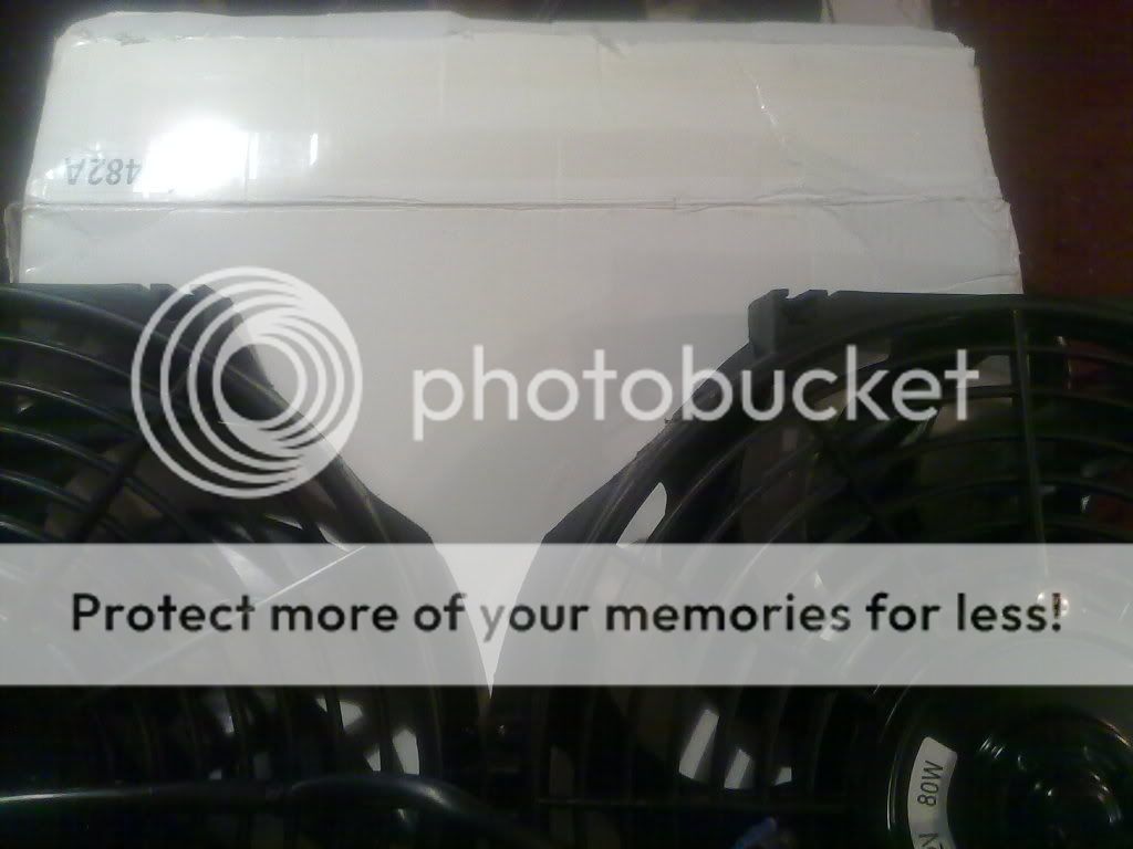

The second 12" cooling fan arrived in the post today.
So I got both of them together and mirrored the trimmed part that
was on the left side fan.

I dropped the radiator back in when I got home, the angle of the picture
isn't very faltering but the new angle of the pipe is perfect, and at a
cost of £15 no complaints.

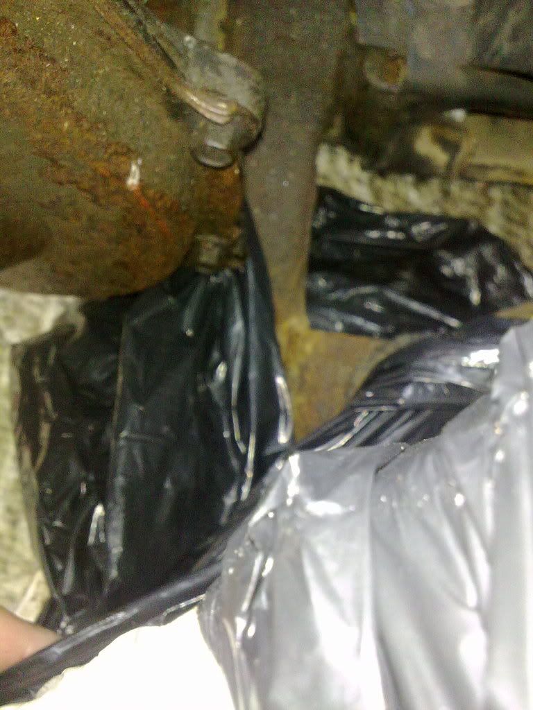

I put a jack under the front engine mount and took this picture, it isn't
very good but does show what I mentioned about the overlap of the end plate
of the transmission on the wishbone/control arm.
lifting the front mount, which tilled the engine back did slightly correct
the problem. However the bolt through the rear mount is too high and will
need to be redone so the engine and transmission can be put at the correct
angle to avoid the wishbone/control arm.

Mother took me down to collect the radiator, before heading to hospital.
As I am on antibiotics, this helped with a little problem.
As the nerves in my feet and legs are shot, I didn't realise that a nail
had gone through my deck shoes and into my foot! I only realised that
there was a wound when blood stains were left on cushion I rested my feet
on. So hospital every week again for check-ups on my feet, to think I had
thought I might have a good few months without my feet causing my problems!
Not much done on the car as of the time in hospital.
One thing I did find out was the front mounting bracket on the engine needs
to be taken off an attacked by the grinder or the rubber mount holder gets
in the way.
