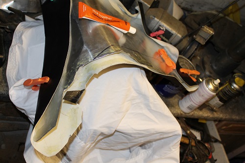

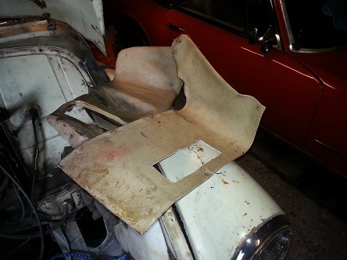

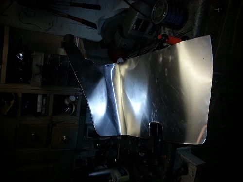

I have now moved onto making new panels which go in the footwell under the dash, these were broken (crumbling vac formed plastic) had holes cut in them for speakers and stains / damage all ove the vinyl.
so new panels were made from .75 mm alluminium sheet using the originals as patterns.

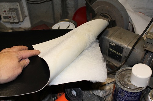

Wadding and black vinyl were then glued to the alloy.

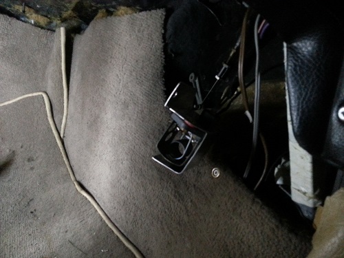

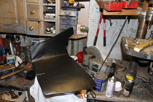

The vinyl was then glued to the rear around the edges not perhaps the prettiest piece of work but none of this is seen when installed (and it looks the same as the orignal!).
And this is the finished job.
This is one fitted to the car.

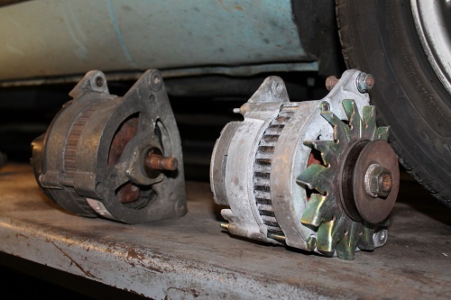

Tr alternator went on no problem, but still the charging issues, turned out the B+ bolt on the starter was loose and this was the problem, it is much quieter though as the bearings were shot on the old one.

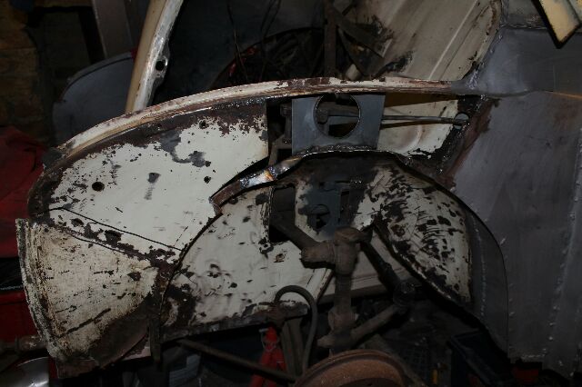

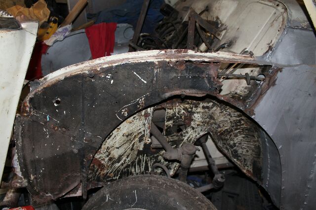

I did manage to cut the patches around the front bump stop out of the minor, turns out for a change there was no corrosion the patches were over a number of cracks instead. I also cleaned the underseal off the inner wheelhouse several areas of corrosion but also quite a bit of sound metal still I 2 minds as to weather to repair the orignal by butt welding or make a new one.

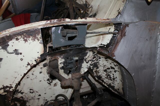

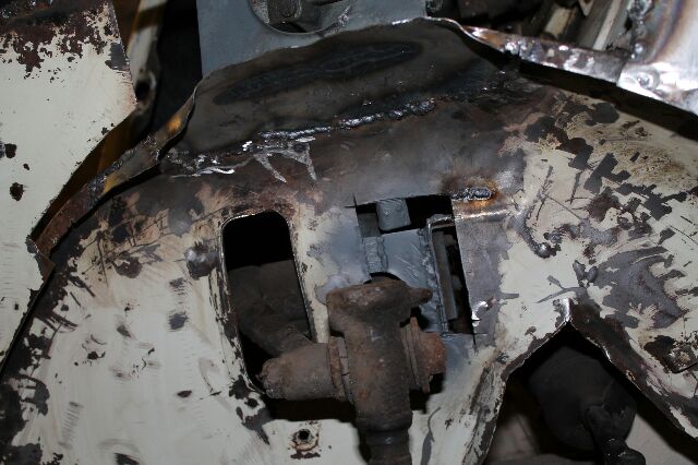

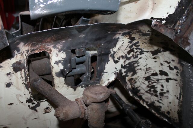

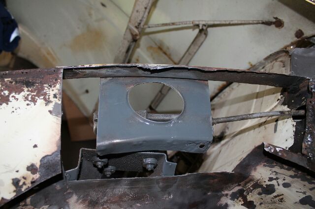

Started welding some repairs into the minor last night though, cleaned off the rest of the underseal, and given so much of it is in perfect original paint I have decided to cut out only the rusty bits and butt weld in new metal.
A bit of cleaning up with the grinder and the vertical panel can go on.

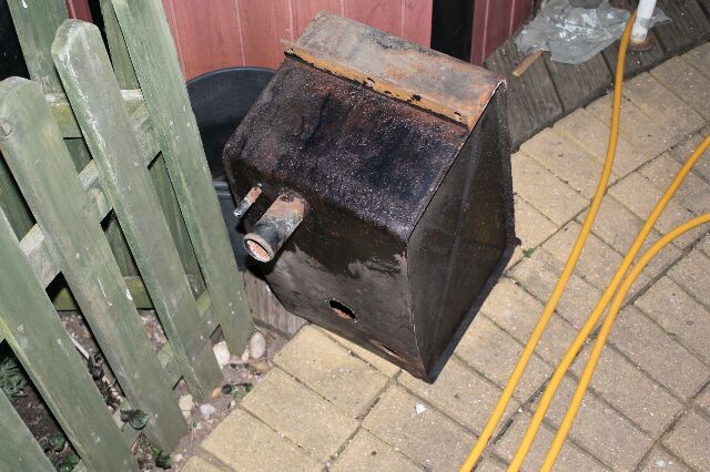

I have also been sorting out the landie petrol system, running all the time on lpg has allowed condensation to build in the tank causing rust which had in turn blocked the pump (pick up gauze is missing).
This is what came out with stones and distilled water.
I have had mixed results with sealers so for now this will be it, the tank is rusty on the outside in places as well so a new one will probably be required in the next few years.

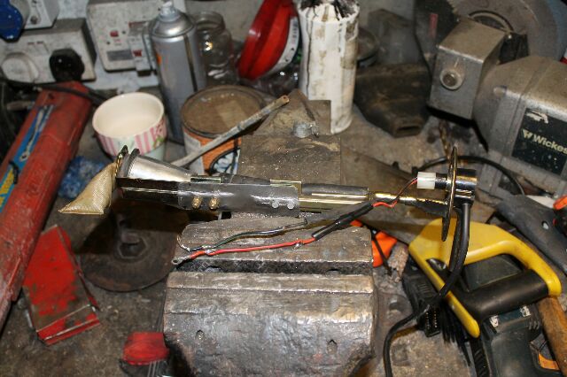

The plan is to fit a 110 carb in tank pump, I have enlarged the pick up hole in the tank and started lengthening the pump assembly, the lengthned wires will be threaded through fuel pipe for insulation when I get some more tomorrow.
