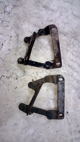

This was initially bolted on and although a better fit it was still unacceptable - so I delved a little further - Peter noticed that one of the supports on the bonnet hinge was bent so we located another from the reserve stock, then I compared the new hinge to old one to find that the old ones had been messed about with - the rivets had been drilled out and huge nuts & bolts fitted with no end of play within the hinge
So the old hinges were removed to be replaced with the new ones - bonnet back on and a better fit again but I'm still not happy with the aperture gapping - so the bonnet has come back off and I have left Peter to elongate the hinge brackets to give more tolerance when fitting the bonnet.

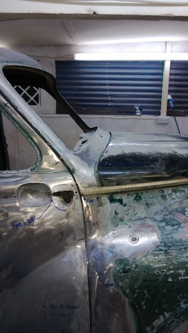

Meanwhile I have the nearside front door off - this is the worst of the doors
Previous repairs were made up of brazing / body solder & filler - but this had failed and blistered through the paint
Repair sections are available through the Jowett Car Club but require some work to make fit due to the compound curvature on the door skin
Door sectioned / cleaned up and ready for trial fitting of repair

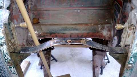

Modification of the mounting points for the bonnet latch
Addition of the bonnet catch outer cable stop

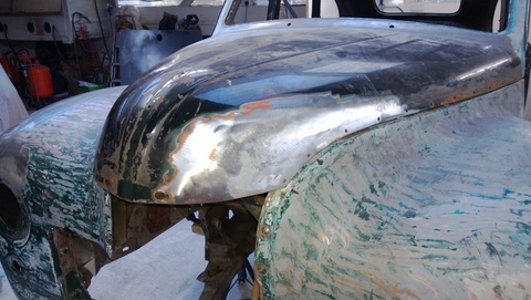

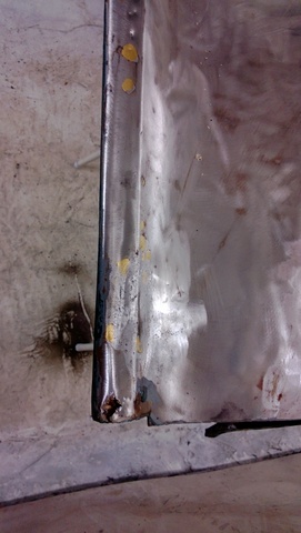

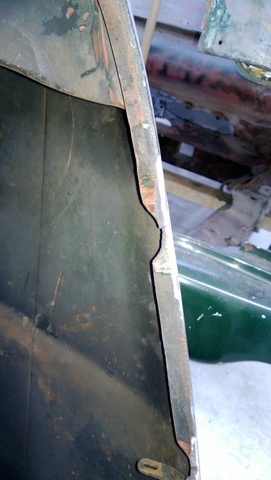

Welding repairs required to bonnet edge weak points where the edge fractures under the trim / wing fastening cut outs
Repairs complete and cleaned back, the new bonnet had factory fitted additional supports to the rear edge so obviously this had been a problem on the cars when new
Accident damage to the front nearside of the bonnet was dressed out & cleaned up

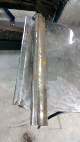

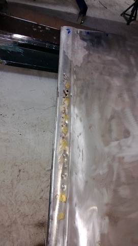

So back to the nearside front door
I flanged the door skin so that a lapped joint could be formed
Repair tacked in and door trial fitted
I am happy with the alignment at the door bottom but the swaged edge rolls forward too much and does not align with the front wing / rear door - so I will have to unpick the welds and try to roll the swage line in a little

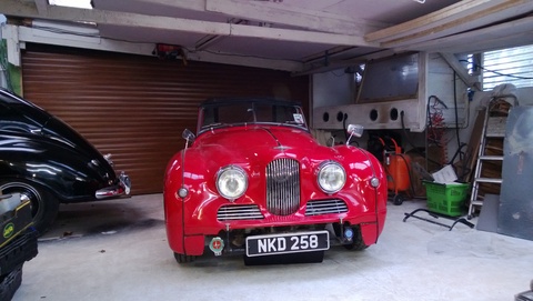

Terry was enquiring as what we had hidden under the dust sheets so here goes:
Jowett Jupiter rallied in 27 countries - owned by Keith
Just some of the cars exploits (obviously not the Pratts sign)
Jowett Javelin - 500,000 miles from new owned by Amy (Keith's daughter) and whilst in the same workshop - up in roof space is the chassis for my Jowett Jupiter special project
all the body panels are outside in the shed
Re: Early Javelin Restoration
#269 Post by Grumpy Northener »
And up in the top garage is Amys Jowett Jupiter
Along with my 1952 Jowett Javelin
And on the drive
Another Javelin project (ex works experimental car) owned by Jack (Amys partner) - stored elsewhere I have a 1937 Jowett 8 project & a 1937 Jowett stationary engine, finally I also have a Rover P6 V8 3500 - I think that's enough to be getting on with !!
