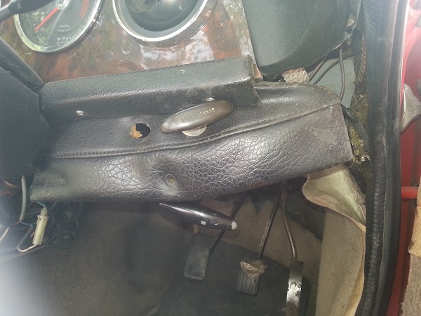

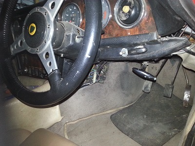

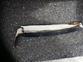

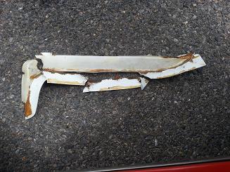

The lower dash trims are vinyl stuck over a vacuum forming, the vac formings have disentigrated.

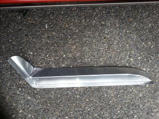

So I made a new one out of thin alloy sheet.

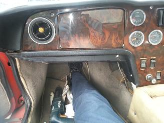

replaced backing to the dash trim on the other side with a alloy structure as well now, before:
After

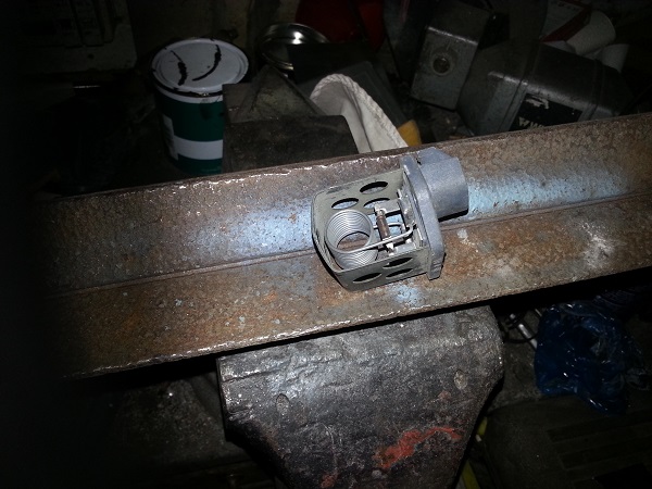

While am fixing odds and ends I took a look at the heater fan which only works on the high speed, turns out as expected the resistor has failed, searching through my box of electrical parts I found this which seems to work:

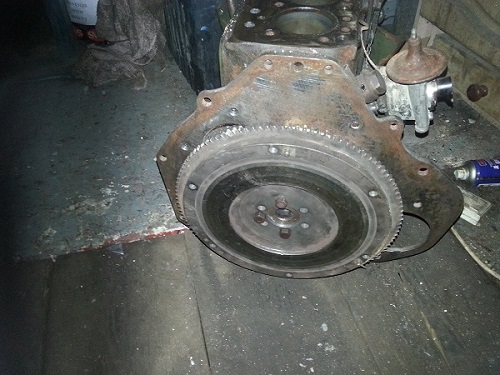

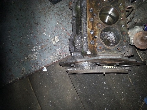

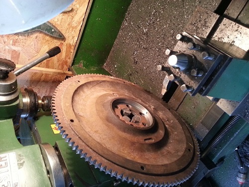

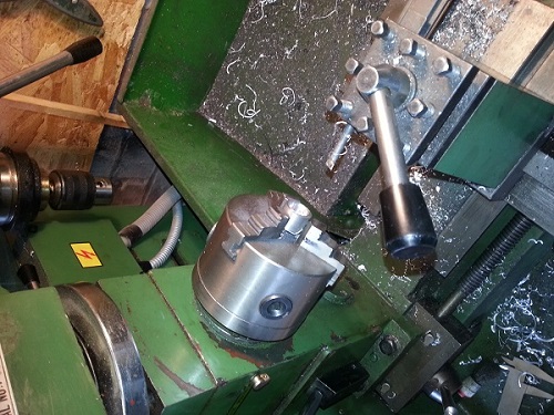

So I needed to get to work on the lathe, boring out the pulley only took a few minutes, but while I was at it I did the turning required to fit the mx5 box to the minor, firstly I enlarged the hole in the centre of the 1275 marina flywheel and the recess for the crank flange so it fitted on the minor crank.
I then urned up a bush to centre the pilot shaft to the crank, eventually I wil get some bronze to make one but for now alloy will do.
the flywheel now bolts to the engine (still need to drill 4th bolt hole).
the only problem is the flywheel fouls the oil pump cover so I see a bit more machining coming up.

It's interesting, this whole business of fitting Japanese MMUs into Minors and not having them catch all over the place!
Does the Mazda gearbox clear the steering rack, or do you need to lower the engine & gearbox as would be the case with a BW65 conversion?
:idea: Also, if you know of anyone who has an automatic MX5; is the bellhousing on its transmission as shallow as that on the manual?

:thumbs: Thanks Kev. OK, now to try and explain this to someone who's not looking at both a Minor block from behind and a Mazda MX5 auto bellhousing from the side:
See the rear view of the Minor engine in Kevin's photo? Immediately above the manual flywheel seen on that engine, what is the depth of the bellhousing on the automatic MX5?
I'm asking because if the torque converter on the Mazda is any deeper than the flywheel - at the point where the upper bit of the Minor engine's backplate mating flange rises toward the head - then the Mazda's bellhousing wouldn't clear the Minor steering rack which, in the stock - manual - installation in a Minor sits only around 4 1/2" behind that area of the block. Manual gearboxes, such as the commonly fitted Ford ones, can have a notch made to clear the rack and as Kevin is fitting the Mazda gearbox, presumably it too can be modified to fit up into that restricted space. However, the Borg Warner 65 transmission - that would otherwise be a straightforward fit to the back of an A series with a flex plate - cannot be cut that way as even the smallest TC available for it, a 1300cc Marina/Ital one, is too deep at that point which is why I was looking at the Datsun-built, 5 bearing take on the A series, because its auto option has a deeper, but smaller in O/D TC which fits under the rack and allows the Minor engine to be fitted at its usual height (usual compared to a UK A series with ribbed case Minor gearbox).
So you see, if the Mazda's manual gearbox fits there, then I'm thinking that it's worth asking whether the auto would also be adaptable to fit, even if it, like the Ford and Toyota options, has to have this done to it:
I have a vague recollection of an automatic MX5's bellhousing being a fat wee thing that may be suitable but hadn't considered that option before Kevin posted the picture of the Minor engine, my apologies for asking this O/T, Kevin. :oops:

I am expecting to notch the bell housing as shown above, not sure wheather i will just leave it open or weld a piece in, the possibility of distortion worries me. The other potential issue it size of the marina clutch,to clear this it may end up slightly lowered and it may also be pushed to the left to clear the starter motor anyway. It will be pretty easy to modify the front brackets if required, I did something very similar on the tr when i put the v8 in.
i also need to look at moving the gearstick forward or cutting the floor.

Rather than cut something, would a S2 tunnel not do the same job? They came with a longer gear lever that entered the tunnel further forward, I believe that the GRP tunnels are still available and they're actually cheaper than steel ones in spite of their superior insulation abilities, to say nothing of how much stronger they are in all sorts of ways.:
Unscrew one, fit the other, the captives appear to be in all of the same places in the floor around the tunnel.
Thanks for the thoughts on the gearbox. :thumbs: One thing that I'm trying to avoid is cutting the centre crossmember, which was rubbing on the underside of the propshaft on the Marina-engined Minor auto that I drove, such was the extent to which the engine & box had to be set lower.
Regarding the plate on the bellhousing; it's very unlikely that you'd distort that, it's so thick compared to the plate, or you could simply fit a piece of a juice tin and bond it on with a few screws for support.
