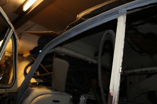

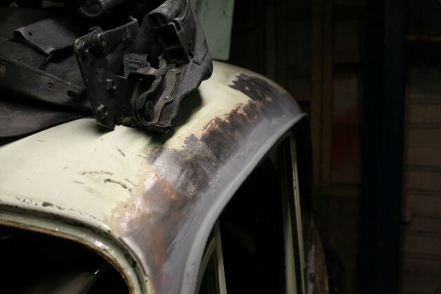

Blaster is just as described above, it does get through the media pretty quickly, to do the two A pillar parts which were quite heavily rusted used virtually a whole 25kg bag, fortunately in the cabinet it can be retreived.
The folder has been very usefull, over the years I have saved a fortune by making my own repair panels, for my landrover which originally had a series 3 dash I managed to make a complete series 2 dash, using the folder and a piece of round bar, the A pillars were also made on it as have been loads of repair panels for the minor.

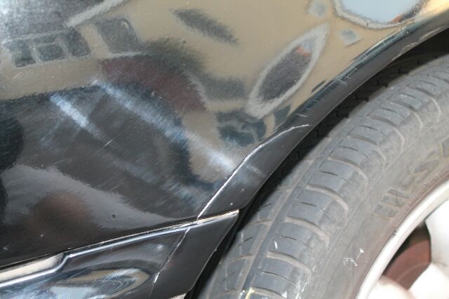

Also washed the MX5 and noticed a couple of rust bubbles in the rear corner of the rear wheel arch dreading the start of serious corrosion I gingerly cleaned it off to find it was only surface rust, the rear factory fitted rear mudflaps have rubbed through the paint and corrosion has begun to run underneath it so it will be a pretty simple repair,for now I have just treated the area. I might even look at binning the mudflaps as one is damaged anyway.
kstrutt1
Posts: 516
Location: essex
Re: kevin s's blog
#248 Post by kstrutt1 »
Some pictures of the paint damage caused by the mud flaps on the mazda, they were the orignal mazda ones which go over the rear bumper and have a thin edge to close the gap to the body, unfortunatelly this edge also cuts into the paint. This is the side wbhich has rusted.
This is the other side with just the paint damage.
I actually prefer it without them anyway, so I will repair the paint damage and leave it without them.

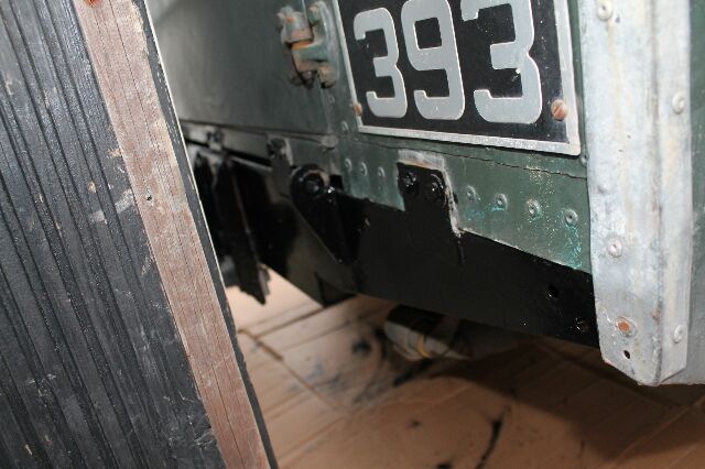

Also painted the landie rear x member, ready for concours now. :D
