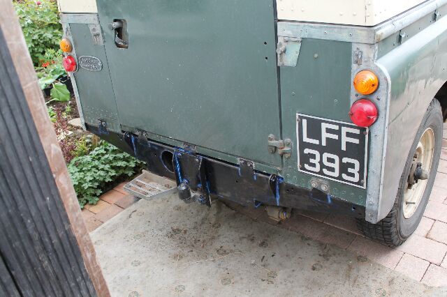

#239 Post by kstrutt1 »
A little more progress today, fitted the new damper bushes to the bottom of the landie rear dampers which went pretty easily, the old ones were completely shot, while under there I noticed the rear x member was getting pretty rusty (only surface rust) sio I cleaned this up and gave it a coat of rust converter, this will thgen be painted, the rest of the chassis also has a few areas of surface rust, later in the year I will go over it all with converter and black wax.
