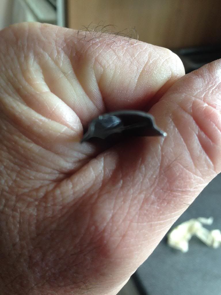

The tool I had ordered from Rejel to attempt and fit the chrome filler into the screen surround arrived.
This is what it looks like
And this is the chrome section I needed to fit

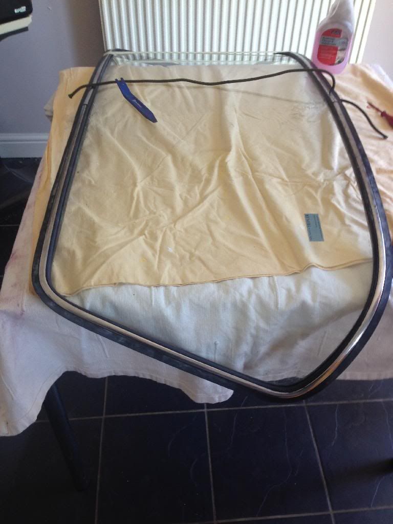

So, off we set. Daughter steadied the screen on the kitchen table whilst my wife maintained pressure on the trim into the seal and I teased the opposite side of the seal onto the chrome trim. It was a pain of a job but after about an hour we were half way and used some masking tape to retain the seal and trim in place.
As is usually the case, the 2nd section went a lot better and soon its was completely fitted.
Into the garage and after 10 mins of gentle persuasion the screen was in the car. The headlining was tidied up and the wipers were refitted.
What a complete pain of a job but I had been quoted £150 from a fitter last week and even then he couldnt guarantee he could fit it without mashing the rubber seal..yeah right!

Well done on proving what we all suspected in the first place; that you would be perfectly capable of getting that window into its hole.
Maybe the guy who quoted for fitting was assuming that the rubber would be old and perished? Maybe he'd have done it the conventional way, which would have made the locking strip much more reluctant to be fitted but either way, you [yoof patter]totally pwned that dude[/yoof patter] and demonstrated that sometimes, common sense beats a van with "automotive glazing specialist" written on its side panels.

well done with the screens, although i thought the beads/trim went in after fitting to the car..
Re: 1965 singer vogue recomission
#237 Post by kevin »
rich. wrote:well done with the screens, although i thought the beads/trim went in after fitting to the car..
I think they probably did. However once the screen is in the opeing there is no slack whatsoever in the rubber plus I reakon you could incurr damage to the bodywork by having to lean on it etc.
I got the idea of fitting the trim into the seal prior to fitting into the opening off a classic mini forum.
whichever way, mine is now in.. :thumbs:
