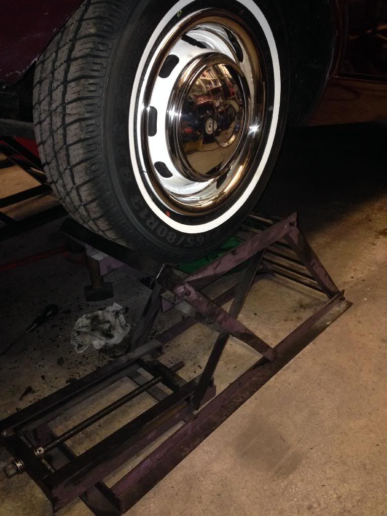

Decided to tackle the diff pinion oil seal, so I got the rear end up on my ramps. Not sure if ive shown you these before but they are a real advantage in the garage and make access so easy..

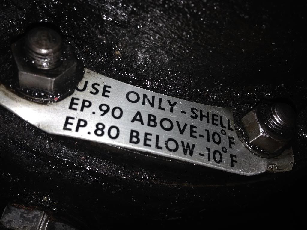

So, after ensuring I could get the diff filler plug out, I took the drain plug out and dropped the oil. I hate the smell of old ep90!
I cleaned the sump plug up, changed the copper washer for a new one and refitted it loosely in the diff.
