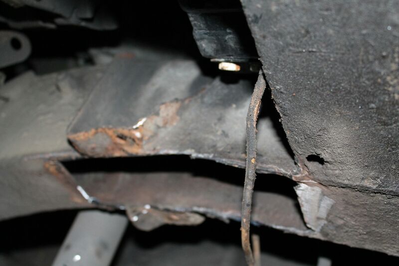

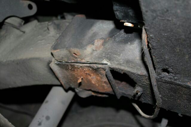

Been a very quiet time on the car front, we went away for the first week of xmas and the second week has been full of family things I did get one day to go over the landie and sort out a couple of issues, firstly there was the hole I noticed in the bottom of tge chassis, it appeared to have started in the double skinned part above the bump stop. So I decided to cut it all out and replace with a thicker 4mm single skin.
As found and first cut made
landie chassis1.jpg (36.22 KiB) Viewed 1989 times
All cut out
landie chassis2.jpg (52.28 KiB) Viewed 1989 times

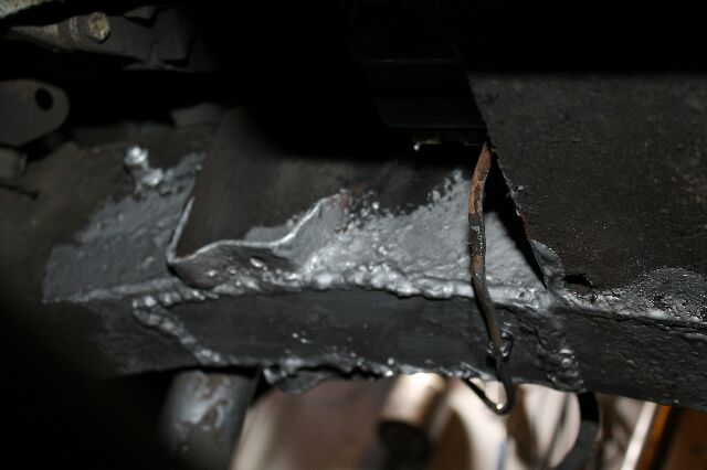

Patch welded in, not particularly neat but plenty strong enough.
landie chassis4.jpg (30.77 KiB) Viewed 1989 times
Just need to remember to wax inside it later in the year, I was actually pleasantly pleased with how solid the rest of it was, and it was obvious the previous wax treatments were doing a reasonable job.

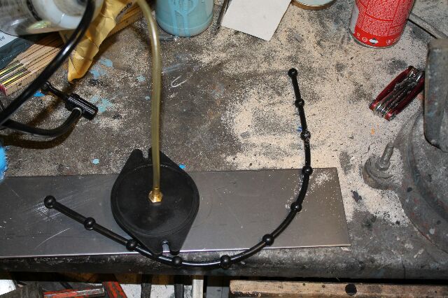

I also had another go at the brakes, firstly I replaced the seized front adjuster, which only took a 10 minutes to chop the old one off and bolt the new on, then I had another go at bleading them this time with an easy bleed as I had been given one of the universal adaptors for xmas so it would fit the landie, this is the adaptor.
As supllied it is absolutely hopeless, with 5psi in a tyre and the strap as tight as I could get it I had fluid spraying all over the place, it's a good job it was the landie and not something a bit prettier.

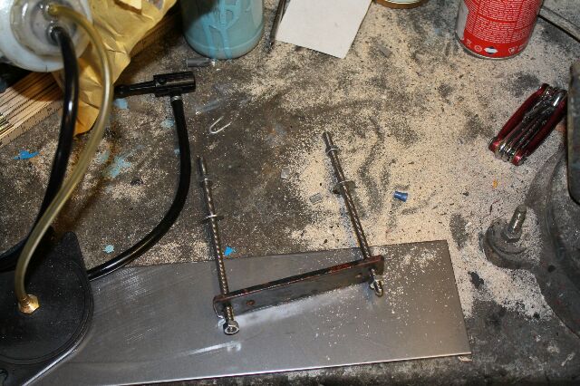

So I had to make this to clamp the cap on.
This time no leaks, but by just pressure bleeding I still had a spongy pedal. Finaly I tried pumping the fluid through using the pedal with the ezi bleed attached, this seemed to do the trick and I now have a nice firm pedal.
